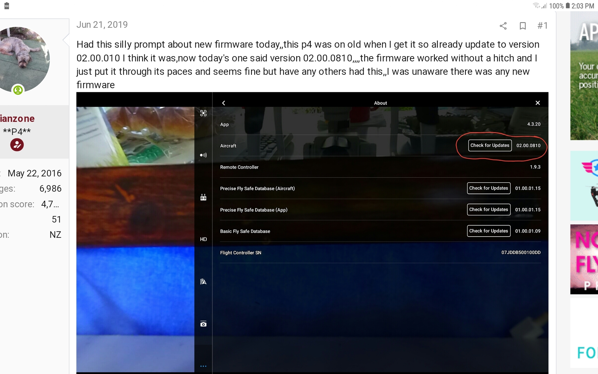

Wow...I had this firmware back in 2019 with p4s and not seen it since,never tryed thr RTH though so dont know what would have happen,this was my first p4 that died in a freefall,,,my sec p4 had the v02.00.0700 which was the new firmware,,not idea how it failed to install the corect one since it came from dji,,,,,,,this is the second time I've only seen it,,,,it is recommended that you check settings after firmware ,mayby the RTH height was set at that and set to hover at the time this happen to you,,depending where I flew I change RTH height accordingly since different objects and tree ,building heights all varied,,topical of dji to throw odd firmware out
