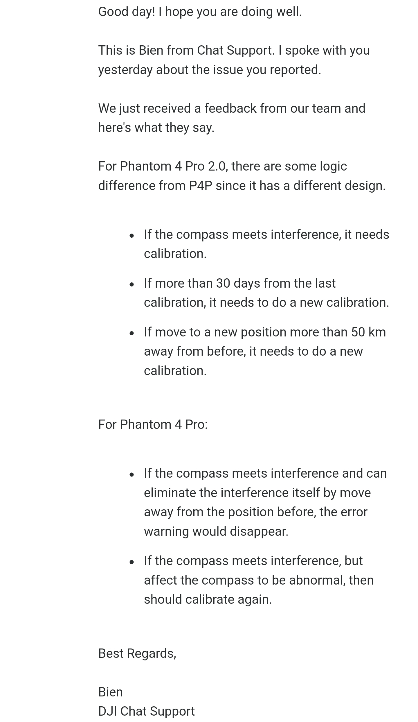

Here is the final answer from DJI for the difference between P4P 1.0 and 2.0. In conclusion, my P4P v2.0 is working as it should.
Thanks for posting that. It seems that the P4P Pro has similar firmware controls as the Mavic 2. It's disappointing though - the 30 day calibration may be somewhat defensible on the basis that the magnetic field of the aircraft may change over time if it is exposed to strong magnetic fields, but the 50 km requirement is just silly - I cannot see any scientific basis for that at all. They had stopped even advising recalibration when changing location for most models, so this is not even a consistent requirement.
Please remember that the magnetic waves change from area to area. What I assume DJI is trying to prevent is future fly aways due to compass misreadings.
