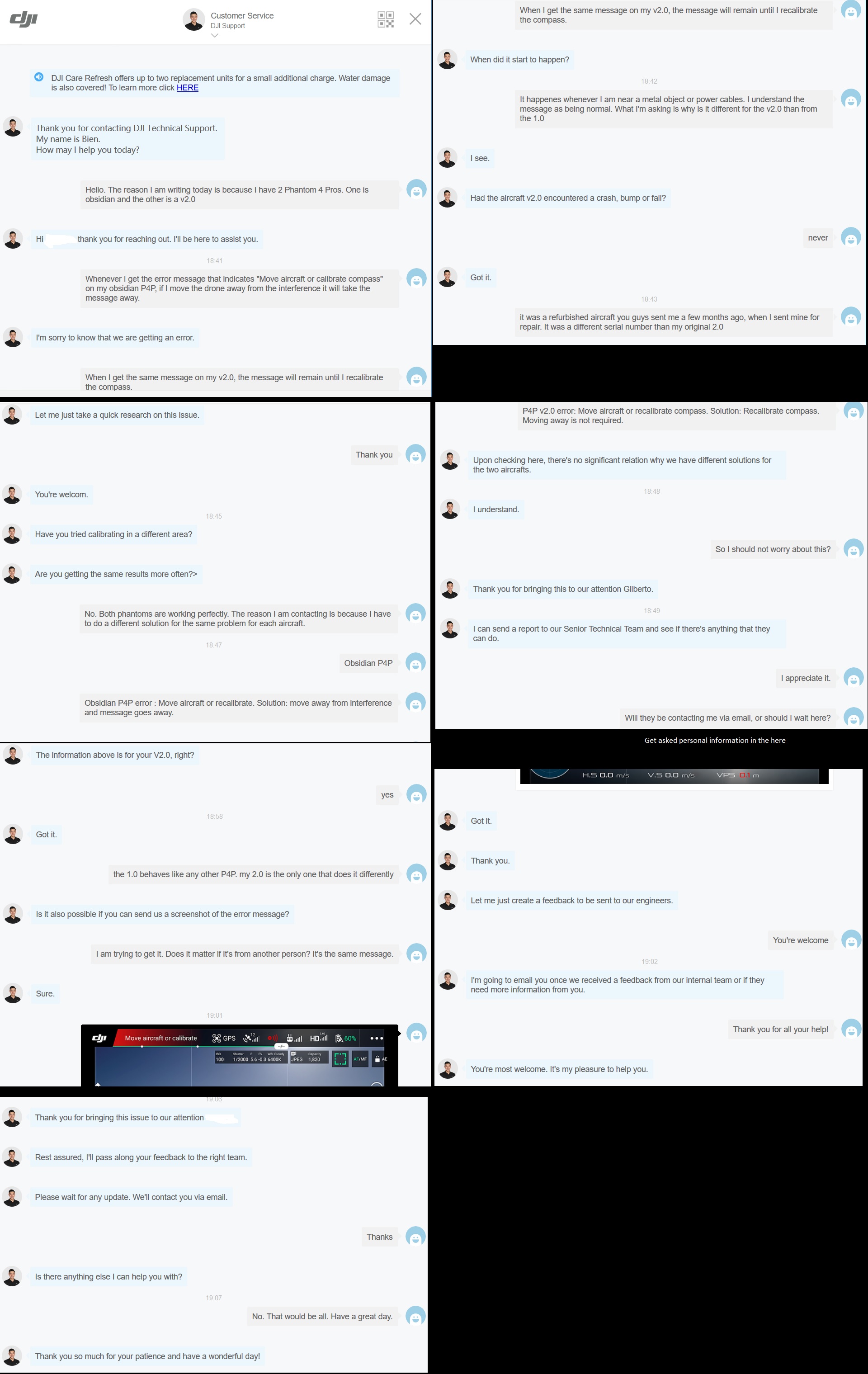

You are correct on this. My Obsidian P4P behaves just as you described, but my v2.0 does not. Even if you move it around, you are still required to calibrate or it won't take off.
So I contacted DJI about the differences in the solutions for the magentism. Apparently the person who helped me wasn't sure on how to respond to my question, so he forward it to a tech. I have posted my conversation with them. Please excuse my elite MS Paint skills, and make sure to read from left to right, then down.
I don't think the support person had the faintest clue what you were talking about.
That was my impression as well. That is why I tried to stupify it halfway into the conversation. Hopefully the engineer understands what I ment and puts everything to rest.

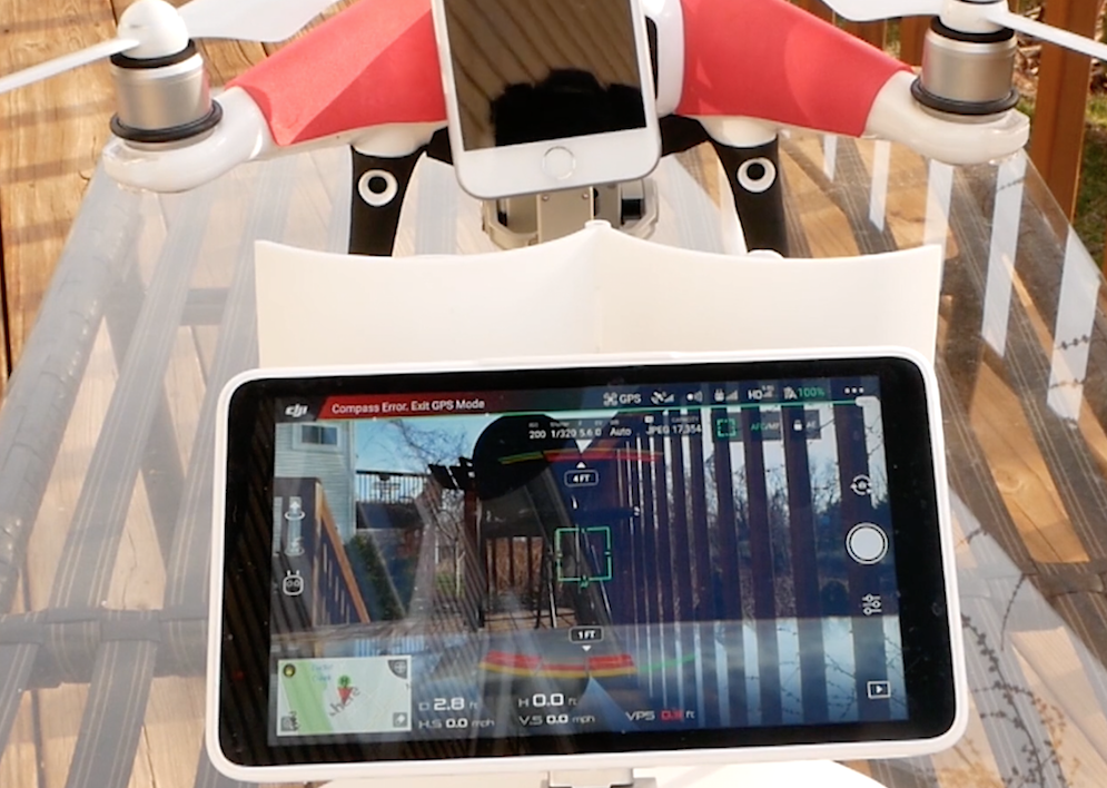

You must have figured out by now that I was using the Phone to demonstrate how little Magnetic Interference it takes to get a a special kind of ERROR MESSAGE :
Notce it says: Compass Error: Exit GPS mode Different than your error caused by Steel Move AIrcraft to Calibrate
The difference between magnetic Error is that it will Disappear from the screen and when it does , many will think its okay to fly which is why I made the video to show its deception.
This is different than the STEEL ROOF example you give where as you get a Move Aircraft To Calibrate which stays on as a warning and does not dissappear.
The Magnetic Interference knocks you out of GPS mode and if your are in flight than you will enter into ATTI MODE.
Because Magnetic Interference has this ability to knock you out of GPS mode and Dissappear from the screen its easy to miss the flash warning message on screen and have your drone go into a fly away.
To determine if the reason for the error is truly magnetic Interference , I suggested he use a small magnet to INDUCE the warning to come up as I have in the video:
The Warning that appears will help the pilot IDENTIFY what your TRUE magnetic interference warning message will look like. : \
Most Pilots have never taken a magnet to the drone so they would not know what the Warning would actually say on there screen.
Once you Identify the Message , now you are going to know when it Magnetic and when its Steel or Beams Ect.
I myself do not fear the Compass Errors as i get them also when flying from my car but once I move Im okay.
However I get a Magnetic Interference warning and i have got to get that drone back on the ground quickly.
If it says Compass Error or Move Aircraft Or Magnetic Interference Or in my video example : Compass Error : Exit GPS mode Than you will have a better understanding of what is really affecting your drone.
My example clearly shows how Easy it is for a Fly Away to Happen do to Magnetic Interference: being that you are knocked out of GPS mode.
This is very different than just a compass error , but the second time I place the phone to Induce the error I do not get it, this is why so many people will thinks it clear to fly when the reality is you need to Move the take off point as you pointed out in your example and restart the drone.
Both are good examples but true magnetic interference will cause a fly away do to is ability to knock out the GPS instantly and with very little warning.
I hope this makes the Demonstration more clear as both examples were good.
