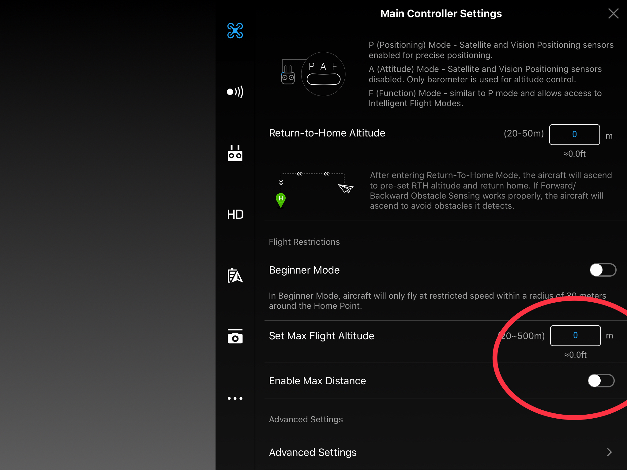

I got a message at 1km saying I had reached my maximum flight distance.
I was in P mode and can't understand why, does anybody have a suggestion?
One possibility is that you had a Max Distance Limit set in the app.
Did you?
Post some recorded flight data and it should help shed some light on the situation.

Make sure max distance is turned OFF
