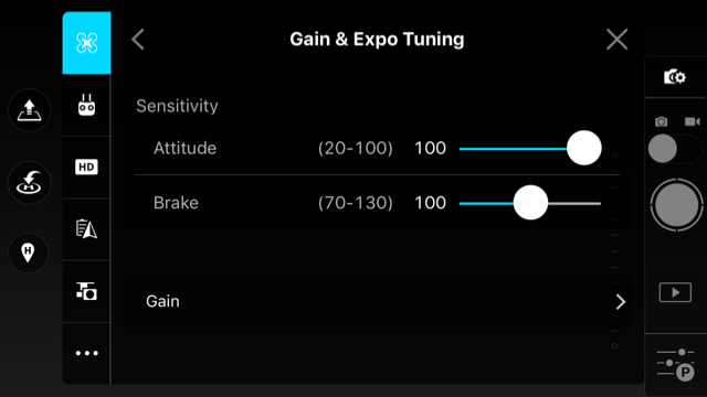

How do I access the setting? What does it affect when dialed down to 75%?
The p3 will glide for a slightly longer period before becoming stationary when on p-gps mode when you release control on the sticks.
Just do some testing in an open area to get a feel for the reduced braking, for me it's not a big deal and puts less strain/torque on the arms

I took my brake down to 75 (I think, or maybe 70 or 80 lol can't remember)
Is there anything else I should take down?
Also is it very noticeable down to 70 from 100?
70-80 sounds good.
The attitude adjusts the response/speed to which the p3 moves, I dialed it down too as I have no need for it to move so quickly (yaw etc) and felt reducing it could benefit the arm issue also
70-80 sounds good.
Sounds good, will test it over the weekend and give feedback.
