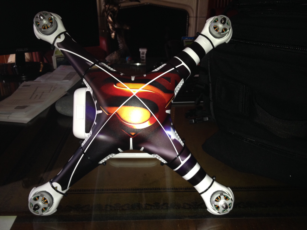

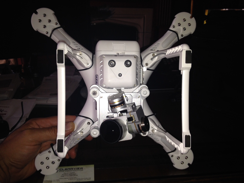

I've purchased a new airframe for an eventual transplant. Until then, use some strong arms and eight strategically placed zip ties. It is much more rigid than before. If DJI does not replace the original in a timely fashion, I'm gonna start spreading the word as much as possible. I encourage everyone to raise hell with DJI and tell everyone about your $1,500 paper weight. See pics.

I've purchased a new airframe for an eventual transplant. Until then, use some strong arms and eight strategically placed zip ties. It is much more rigid than before. If DJI does not replace the original in a timely fashion, I'm gonna start spreading the word as much as possible. I encourage everyone to raise hell with DJI and tell everyone about your $1,500 paper weight. See pics.View attachment 31328View attachment 31329

Unless you got a revised shell, Crashed or not, I think everyone's will crack in due time.
