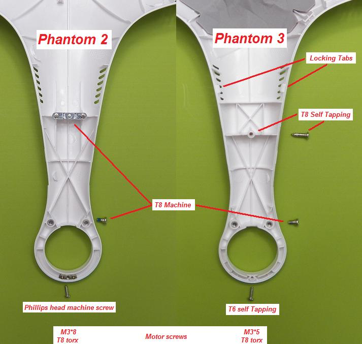

Hi People, could anyone give the several bolts that hold the motors in and the ones that hold the shell together. There are a couple of others sizes as well. Some are Allen key and some are Torque and some are Phillips. I would like to know what to order from my bolt people.

If your talking about a phantom 3 I think the motors are attached with M3*5 cap head socket screws. Head style should not matter if you are ordering non OEM.
Just measure them- Im sure you have one of each.

Most successful? Best option would be to same as OEM.
Tbh I would avoid all the dicking around and just order a full fixing hardware kit. For the cost it just isn’t worth the effort and wasted time.
