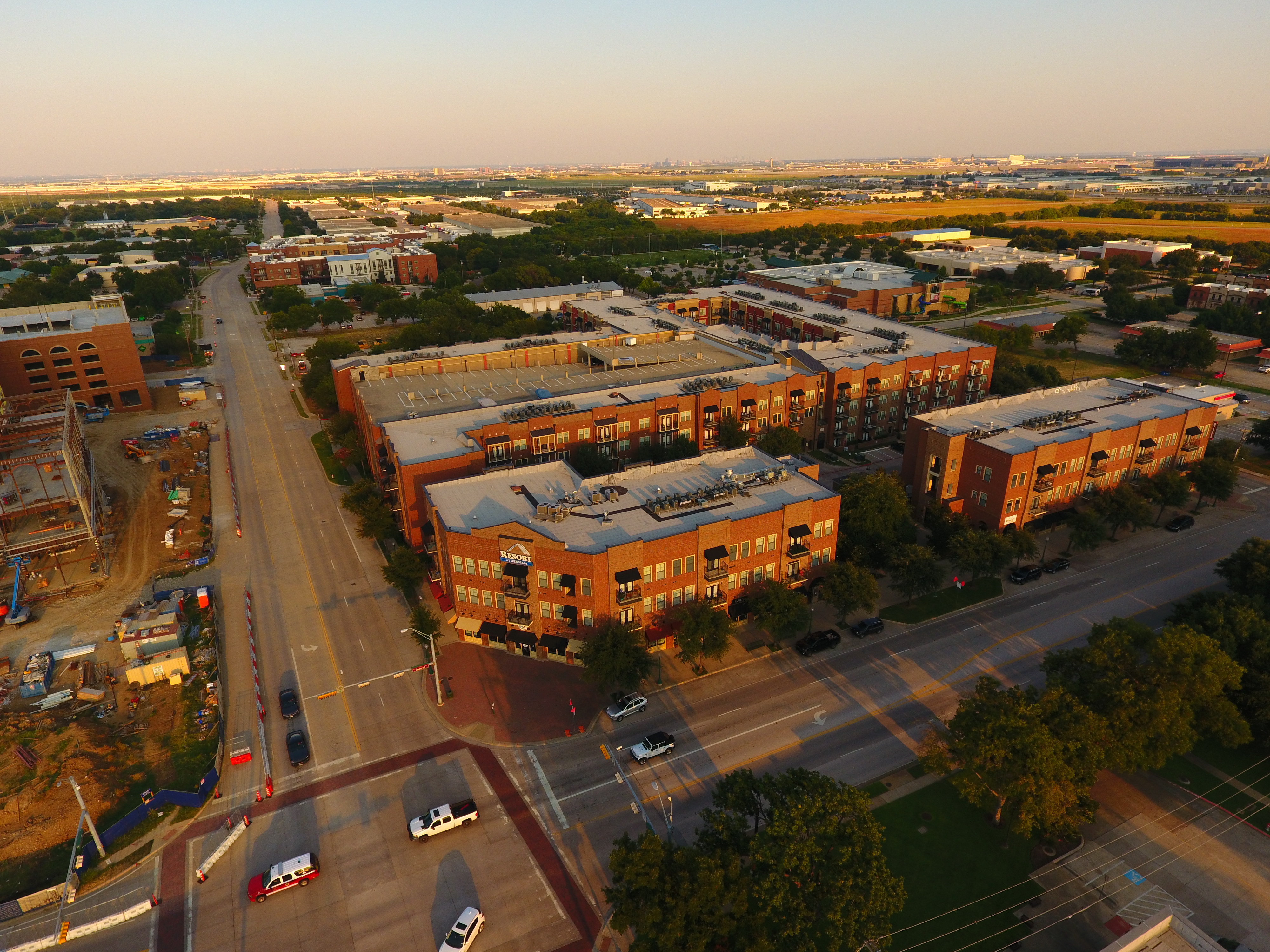

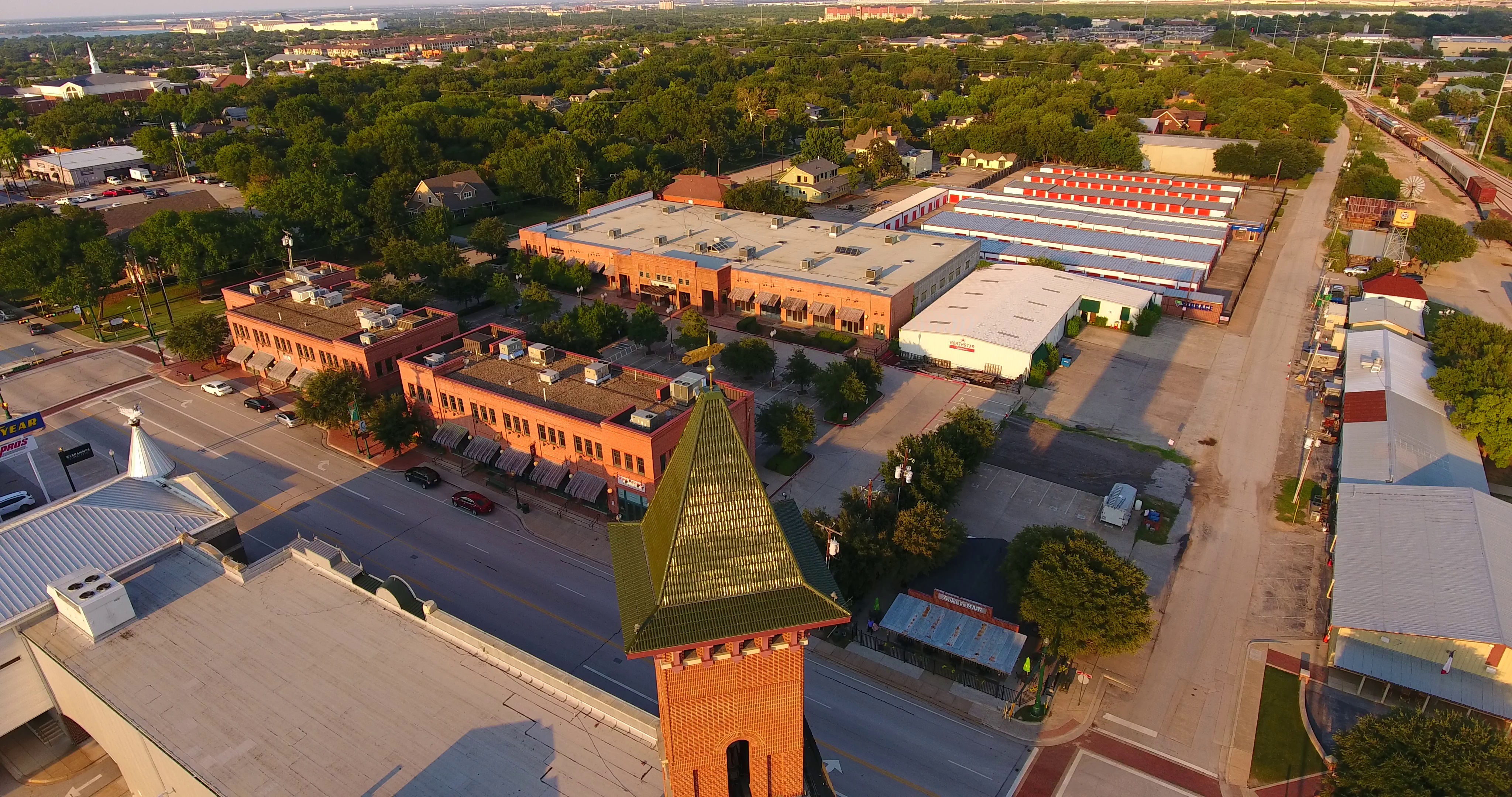

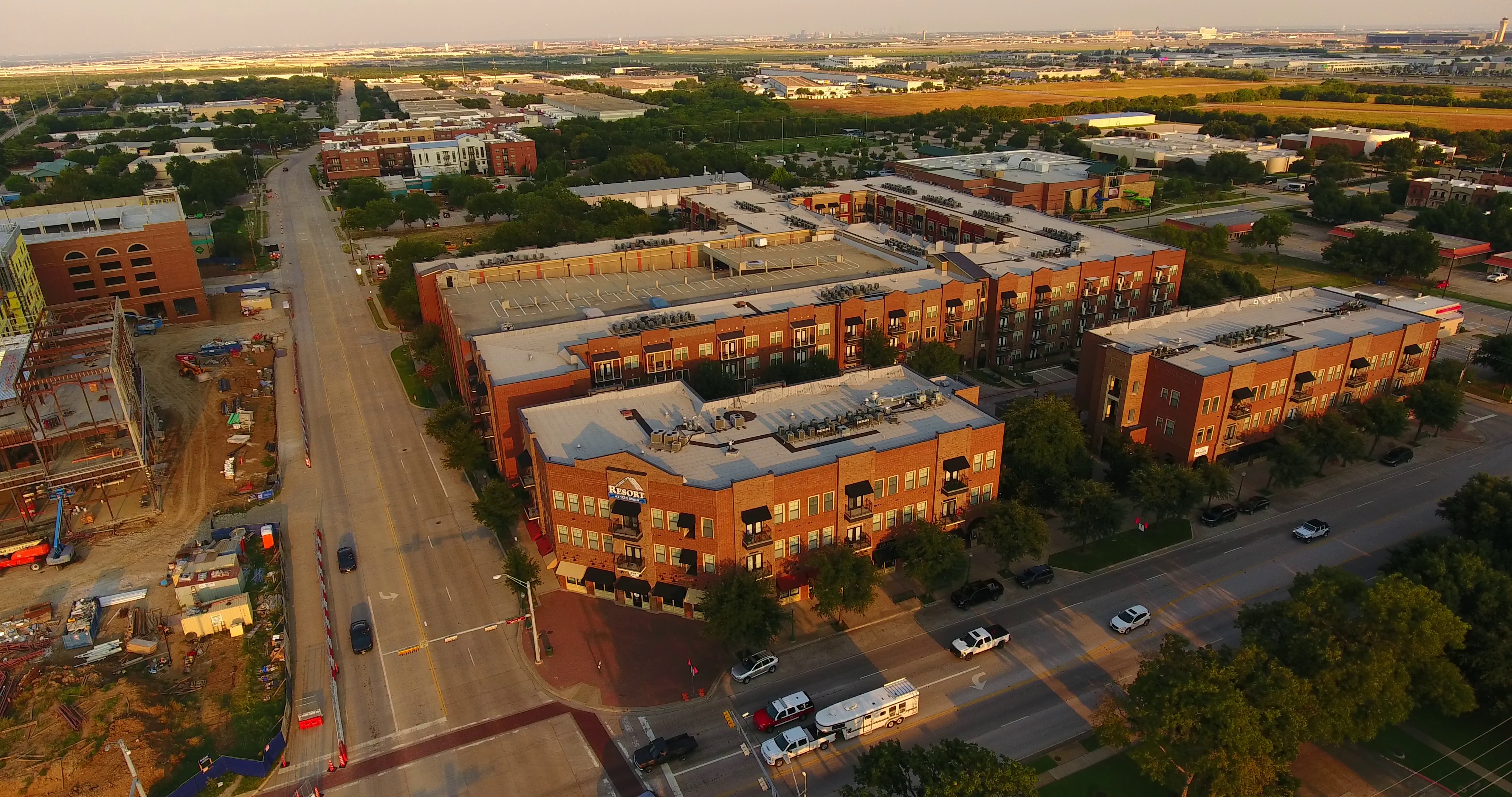

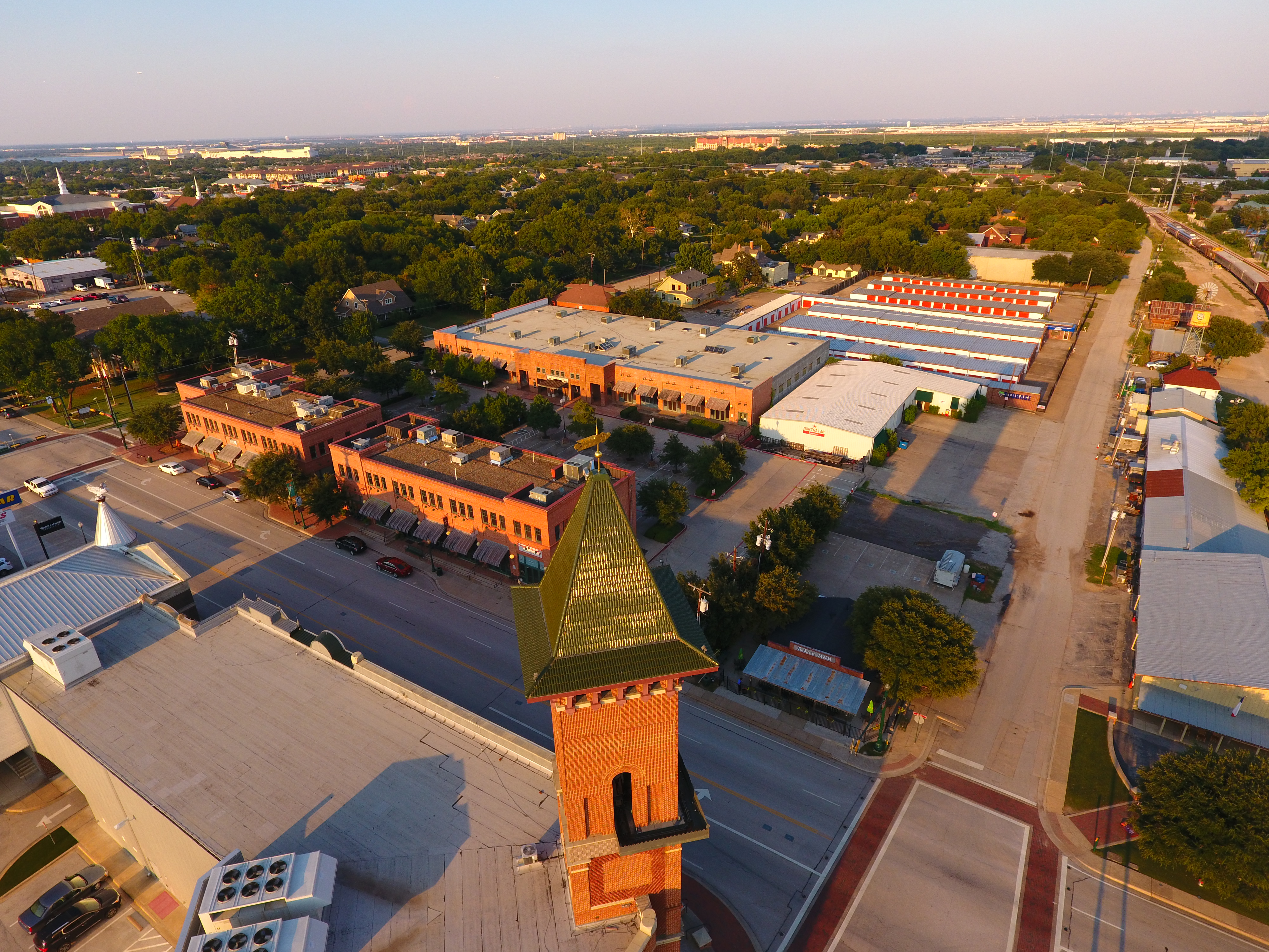

Okay, see attached. I attached two different photos that were done at 6pm tonight, and two "snapshots" of the EXACT scene but from a 4k video. Make sense?
Resort_Still - a picture of an apartment complex as a regular photo
Resort_4k_snapshot - a single frame (a snapshot) from a 4k video.
Tower_still - a picture of a tower done as a regular photo.
Tower_4k_snapshot - a snapshot of a single frame from 4k video
Do you guys see it? The "photos" are nowhere near as clear, crisp and focused as the "snapshots". Maybe I'm crazy.
PS: all shots were taken with default settings, no filters were used and no post-production at all.
Again, I think the videos (1080p or 4k) are awesome my P4, the stills... not! Any comments, suggestions, opinions are greatly appreciated.
Thanks, Resort_4k_snapshot.jpgResort_Still.JPGTower_4k_snapshot.jpgTower_still.JPG

The two stills are both at full aperture (most light gathering) and the shutter speed is at 1/400.
I would be temped to up the ISO setting to 200 or even 400 (max), for lower light shots, I have the ISO set on my P4 at 200.
Reactions: shuggins
Video frames are often a shorter shutter speed than stills in low light. That's probably why they are sharper. First let your drone hover for around five or more seconds at the spot you are going to shoot from. That helps to stabilize it a bit. Stay at ISO 100 unless you absolutely need a faster shutter speed. Open the aperture more (try wide open, that is, the smallest aperture number your camera has. You may lose a bit of depth of field but unless your drone is very close to the structure, it might not make a noticeable difference.
Reactions: shuggins
Can you check your shutter speed? Anything slower than 1/60 of a second is bound to pick up some small vibration from the aircraft. Try to aim for 1/120 or quicker if you can. Can your check your EXIF information on the photos you posted and post it here? Should be able to pull that information from any decent photo app on the computer. It will show what the various settings were for the stills you captured.
