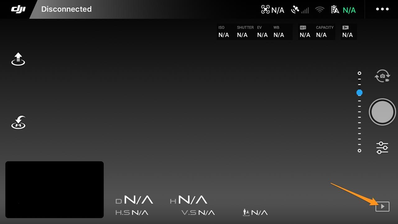

OK after going through all of the menus several times, I have finally found where to re-install the firmware. I must have tried several times and never found this screen where you get opportunity to download a new firmware version.
I finally found it by click on the blank banner at the top in the middle, between Disconnected and the Status icons, pressing anywhere else didn't get me in to the menu option for download. It was more by chance I found it.
It then showed the red triangle again and gave me the option of downloading the latest firmware, v1.9.3.
This actually worked and got my P4 working again, sadly it is now dark so I can't test it.
I assume that when the new firmware download failed, the Remote Controller went back to some type of default firmware, possibly when it was supplied?
This is the screen
Click the grey bar just to the right of where it says disconnected to get 'Aircraft Status'. Clicking on the icons or DJI logo takes you elsewhere.

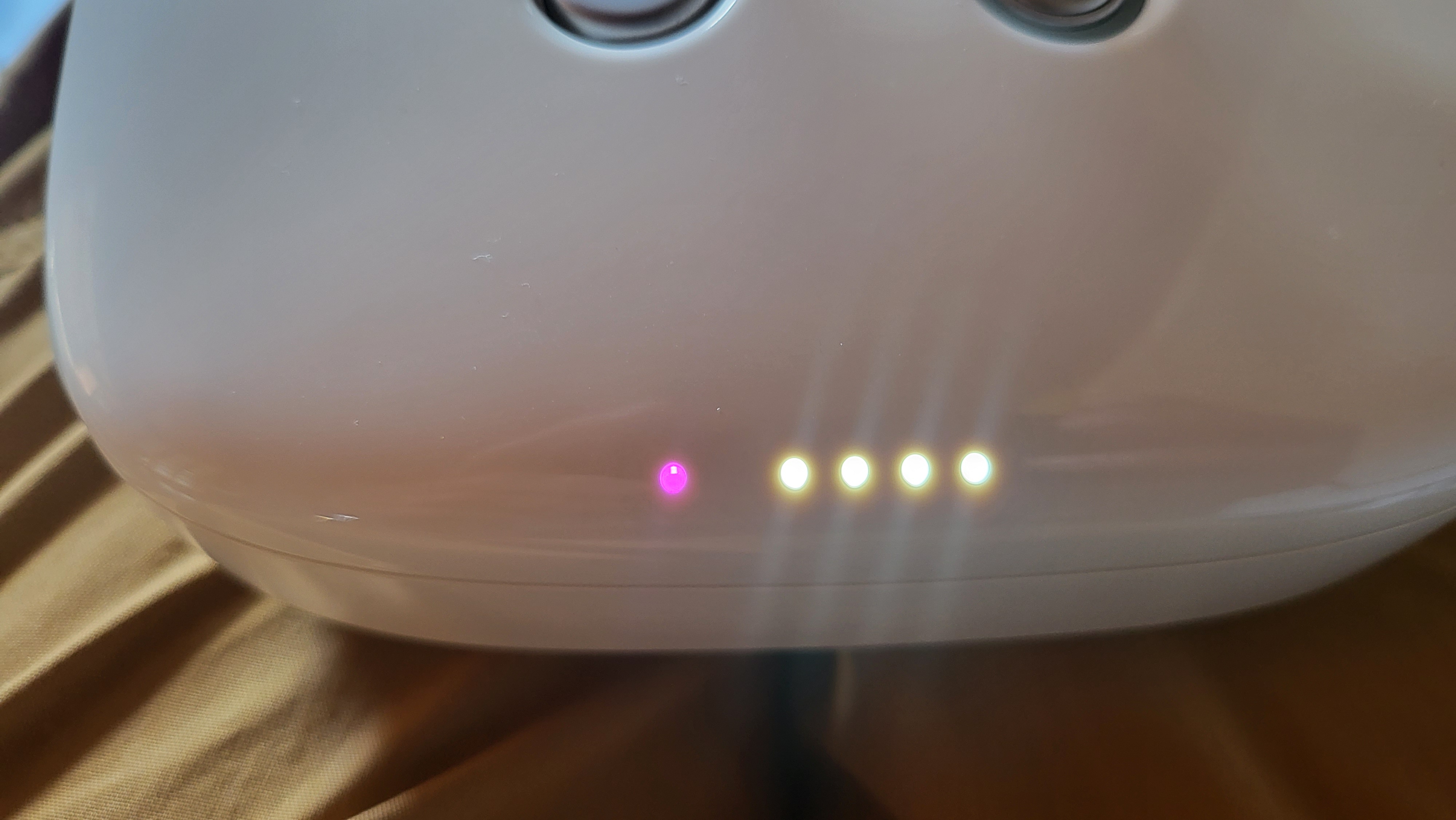

Hola prendo al conectar el control al teléfono se prende luz purpura y no puedo conectar al dron ,como poder instalar con bin usb.o resetear los de los botones no me sirve
