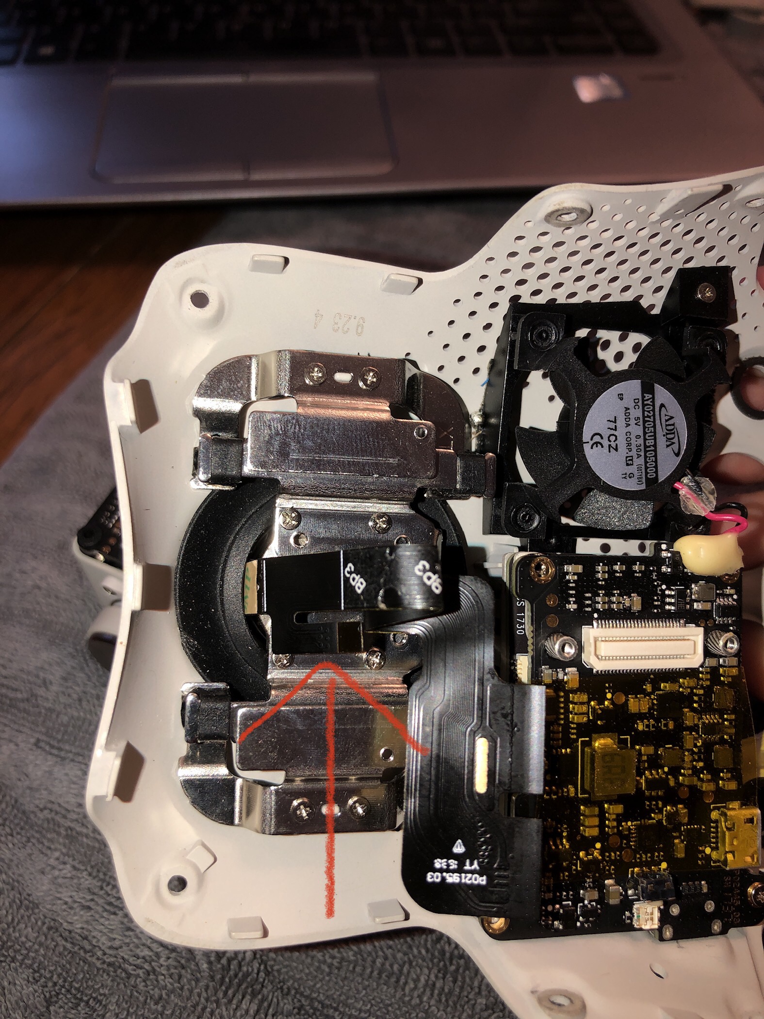

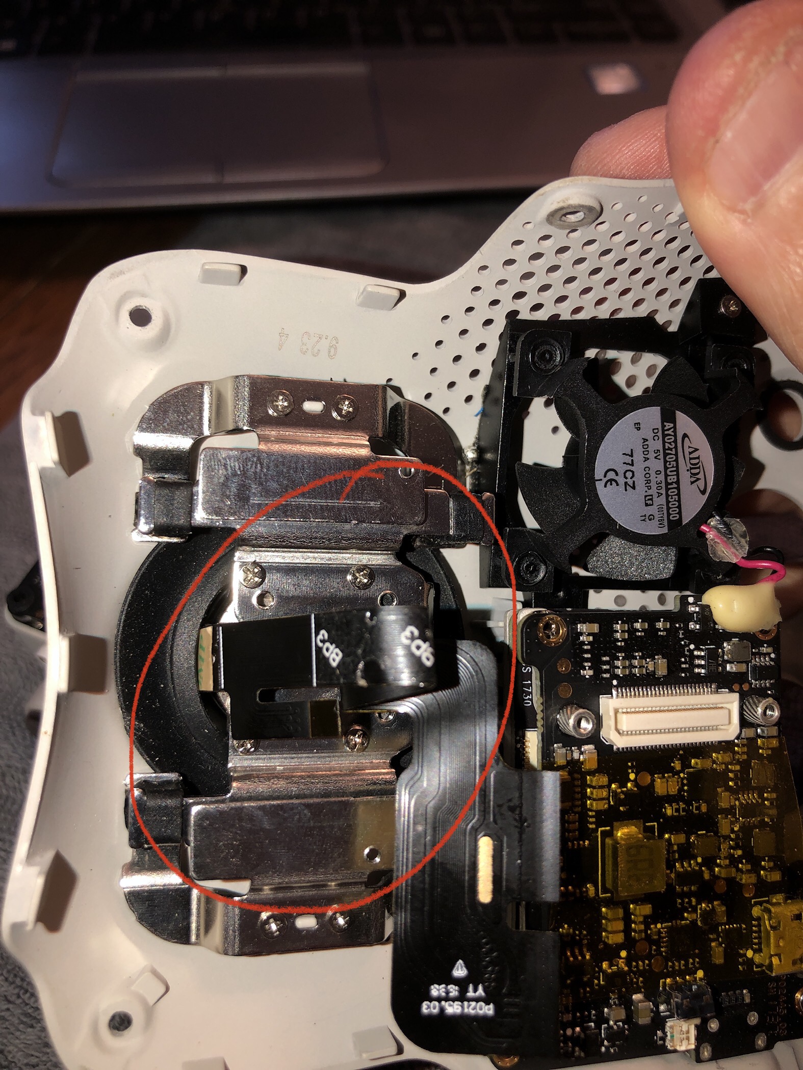

The plot thickens. I went to replace the flat cable (no, I didn't swap controllers, doing that today) and found that someone already has. With an aftermarket cable. There was a section that must have been too long so he doubled it up. And there is a little 'pigtail' from the ribbon that isn't connected to anything. So, I put it back together and I'll order the correct cable. I'm going to swap controllers today, but I think I have a gimbal issue (cale?) and another, unrelated issue that's causing the range issue.
Good find. Should fix camera / gimble issue. Look at your antennae connections while open. Others under the leg caps. Someone may have messed with them too.
