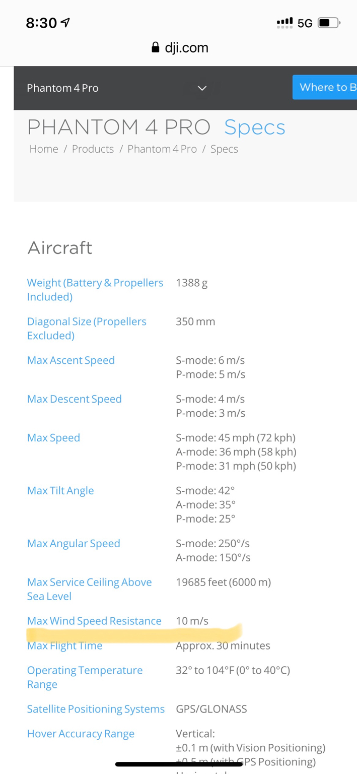

DJI Store has all the specs on each drone
Someone above tried to explain that the Max wind resistance that DJI shows in the specs, is not the maximum wind speed that the drone can safely fly in.
They also tried to explain that there's no simple safe/not safe wind speed and the issue is more complex than that.
Well the DJI Phantom 4 disclaimer document states that you should not fly a P4P in winds exceeding 22mph. So if you attempt to turn a drone in under your care refresh, DJI will look at your log files and determine the wind condition. If they determine they were greater than 22 mph, they may not honor the claim.
