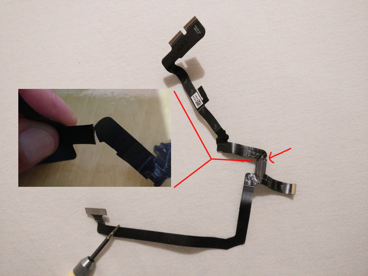

I have a Phantom 4 Pro, that crashed some days ago.
The gimbal yaw was damaged, flex cable was broken, and landing gears was broken too.
I opened the gimbal to remove the flex cable to try to replace (or even fix this cable).
The problem is that I don't found the Flex Cable for P4P anywhere (tried on Ebay, Aliexpress, and several Chinese sites).
Somebody on this forum or another forum (I don't remember now where) said that the Phantom 4 Flex cable is different from Phantom 4 Pro Flex Cable.
But now, I removed the entire cable from my P4P and compared pictures from my cable with Phantom 4 (standard) cable, and looking at the pictures, to me, appears to be the same.
I'm attaching a photo from my cable
So, the P4 cable is compatible with P4P?

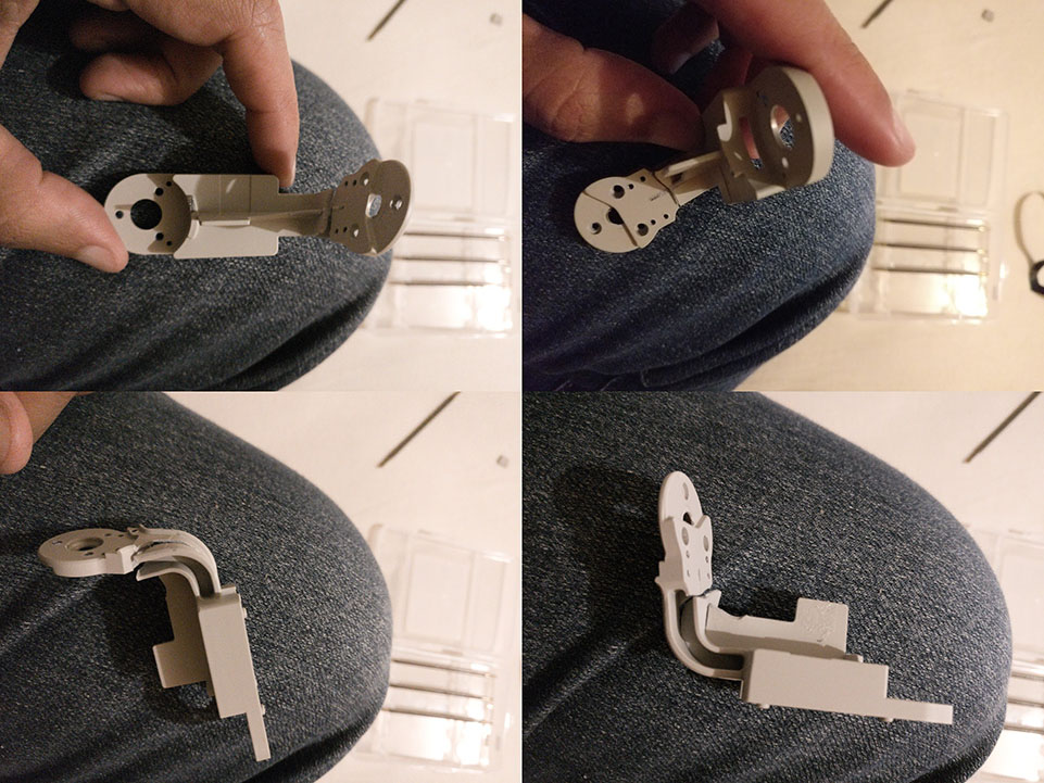

Here is the another piece of gimbal that was broken

I think I spoted the difference between the cables :(
the type of connector on the cable...
I have counted the traces on a P4 cable (using high resolutions images from internet) and on my P4P cable... it's exactly the same.
the only thing that changed is the connector on the end of cable.
I don't know.
I don't have any P4 cable available here right now.
I have two alternatives, however, I do not know yet which to do:
- Repair the P4P cable (with a lot of patience)... something like this:
- Buy a P4 cable, and using a heat gun, try to remove the P4P connector and adapt on a P4 flex cable (it's possible? I don't known... but this option seems to be much more difficult)

I think the chance of getting a good fix on the ribbon cable is pretty small and you probably would not want to be in the air and some distance away and then lose your video feed or worse, cause a short that shuts the thing down causing a crash. DJI is probably the only source at this point so I'd suggest calling them. Sucks, but you do NOT want to crash a $1500 USD drone if you can help it...

Just for my info. Are you thinking that this yaw arm is made by DJI??
I'm pretty sure it's not made by DJI, but the end product is good. It's only aluminium.

This weekend I tried to repair my P4P.
Changed landing gears, yaw, and flex cable!
Tested all sensors from the landing gears, and everything seens working correctly
I got video signal too, so, apparently, the cable is OK. Sometimes I got some bad video reception, but I believe it's because some interference (the DJI app show me a warning about strong interference)
But I think some motor of gimbal is damaged, because the gimbal become a little crazy..
so now, I need a new motor for the gimbal... :(

Damaged motor is likely the cause of your interference.
