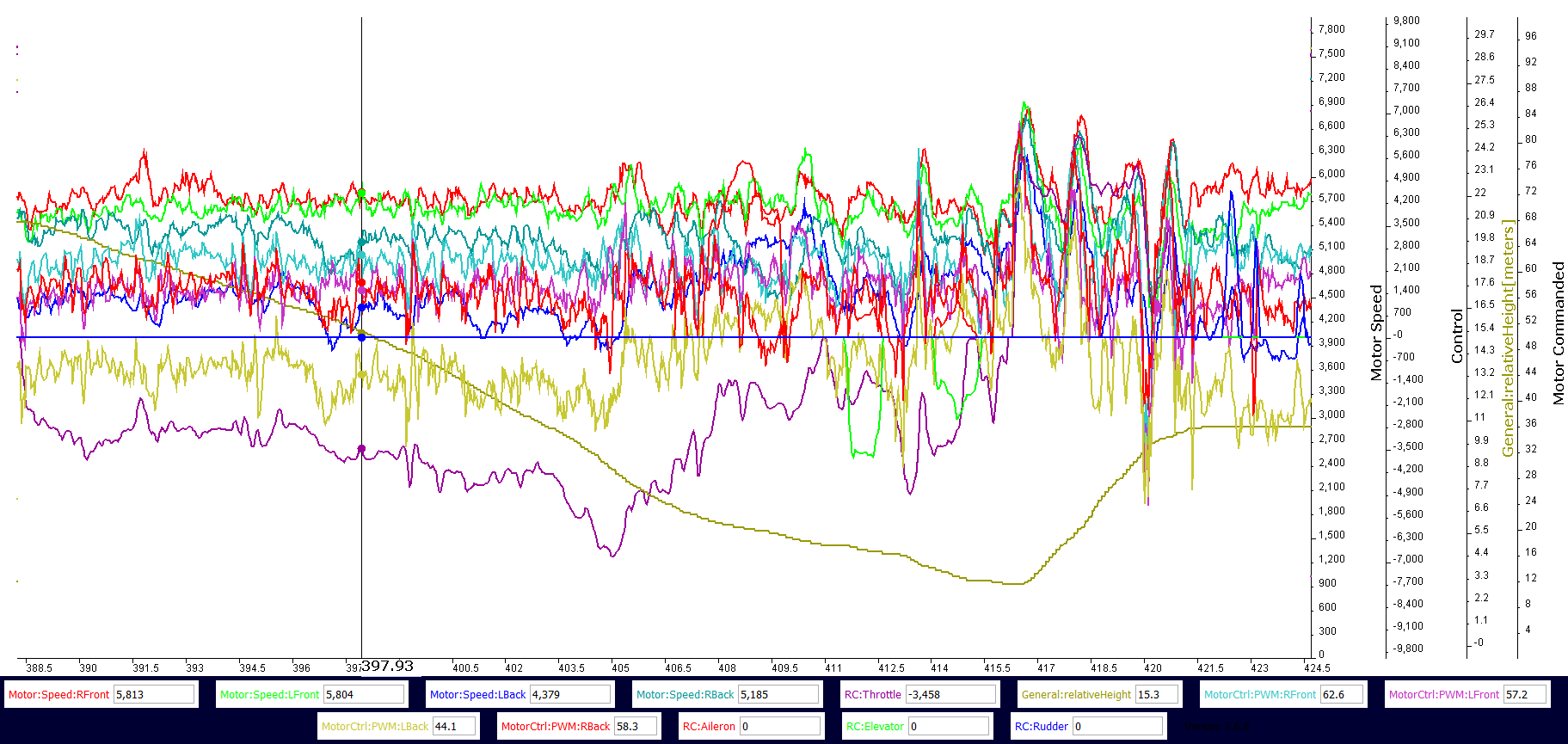

Here is flight log, i was flying really aggressively today because i wanted to see how it would react, also it was little bit windy
FLY876.DAT

It does appear that the left rear is somewhat slower in RPM's than the other 3, however, in saying that it is difficult to make a definative statement on that due to your control commands. A much better test would be to allow the aircraft to hover for a bit with no control inputs. If that exhibits the same difference in motor speeds, then I would suggest that it a motor issue with the left back.

Yes and it happens with quick ascending and descending , i have already replaced the motor, i am starting to think it has to do something with IMU, flight controller or ESC, maybe just firmware downgrade

The control signal for the left rear is also a bit low, so it is possible that it could be the ESC.

Yes might be, but i think it should be showing me the esc error ?? also when i open csvview log area it shows: GeoPath ImuCalcs has signal ImuCalcs(0):Lat that isn't defined
