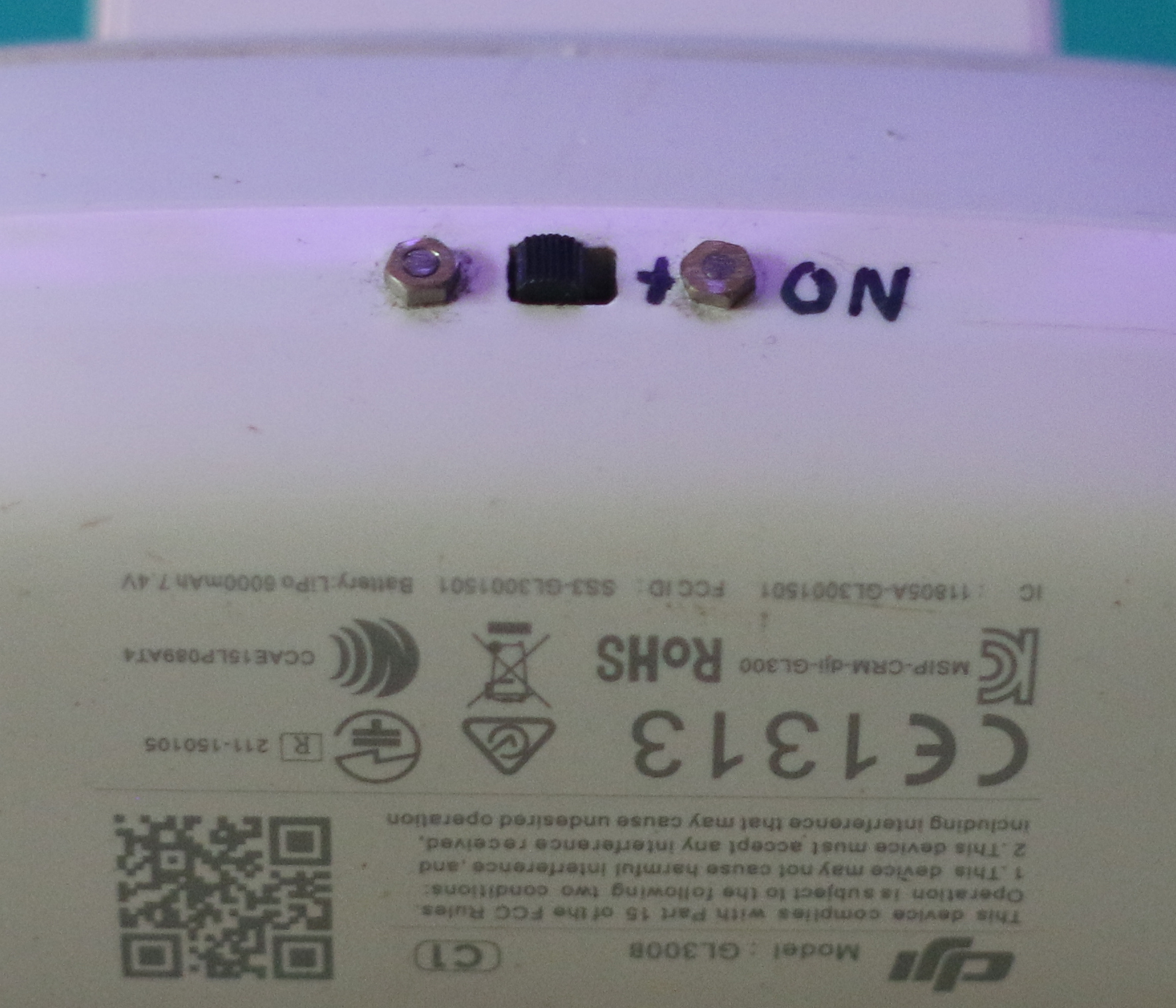

I seldom use my P3P during wintertime and always found the RC battery drained after a few months of storage.
So I installed a simple switch between the positive leads of the battery to physically disconnect it from the board.
Problem solved, no drainage anymore.
