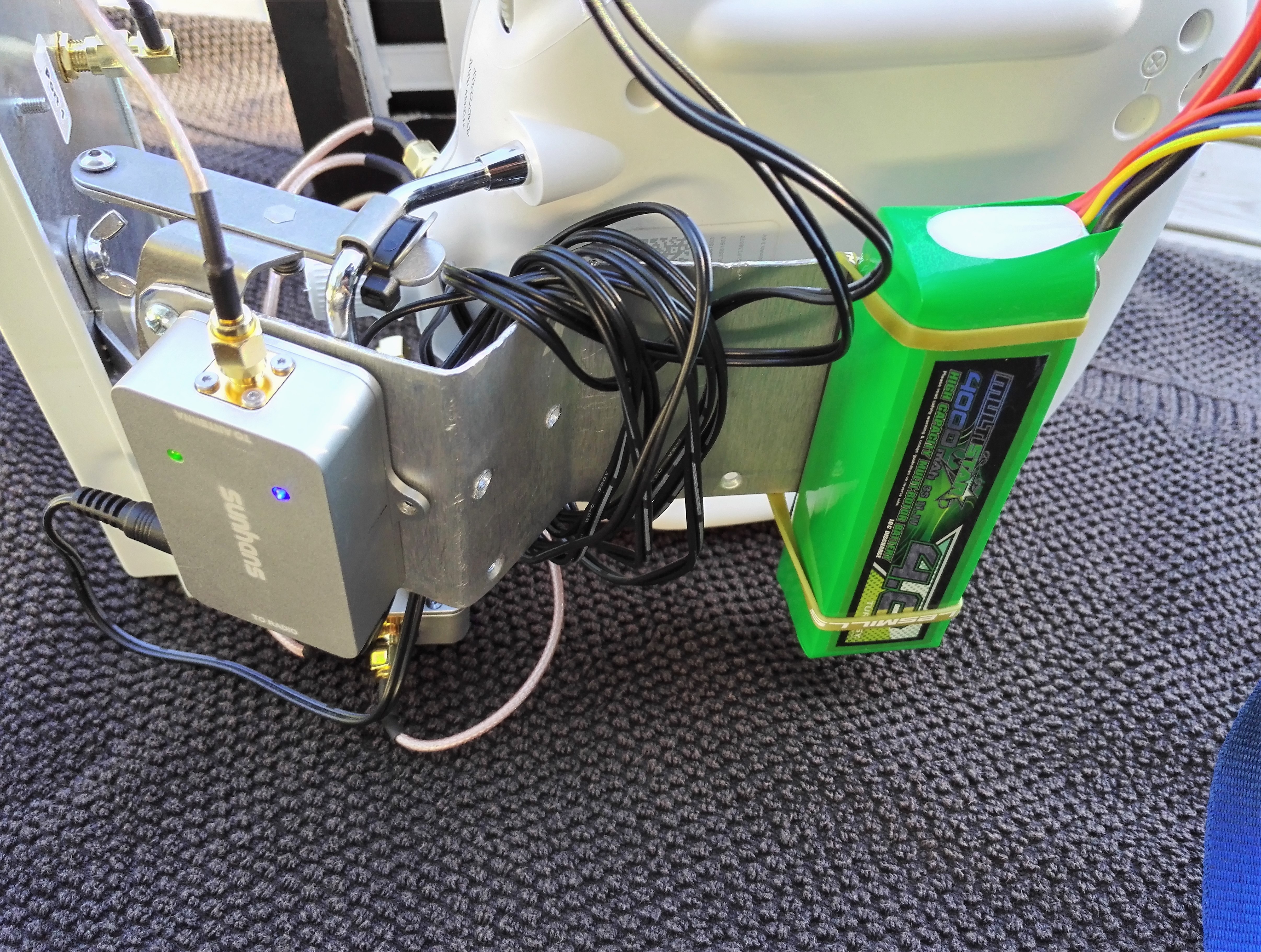

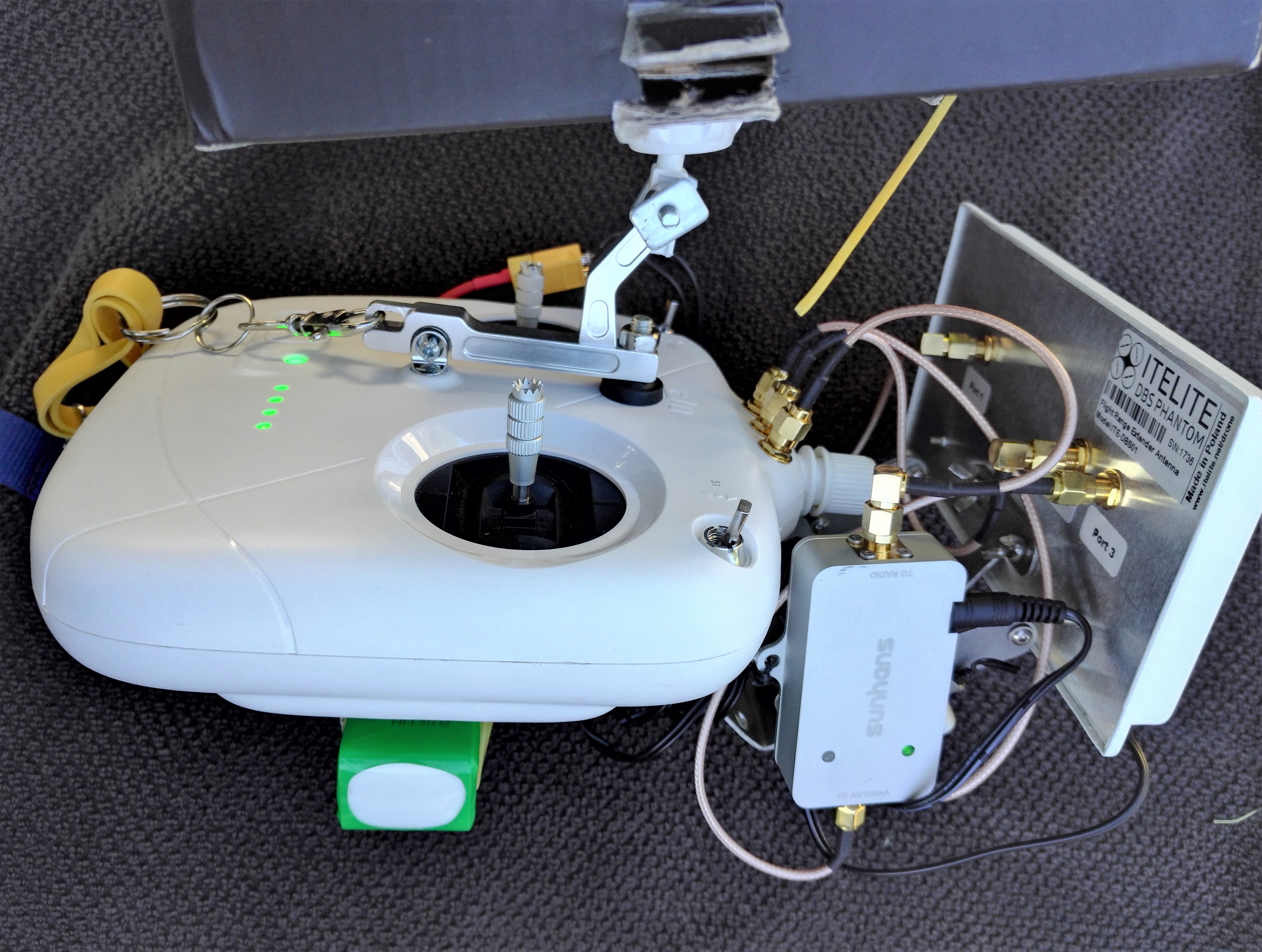

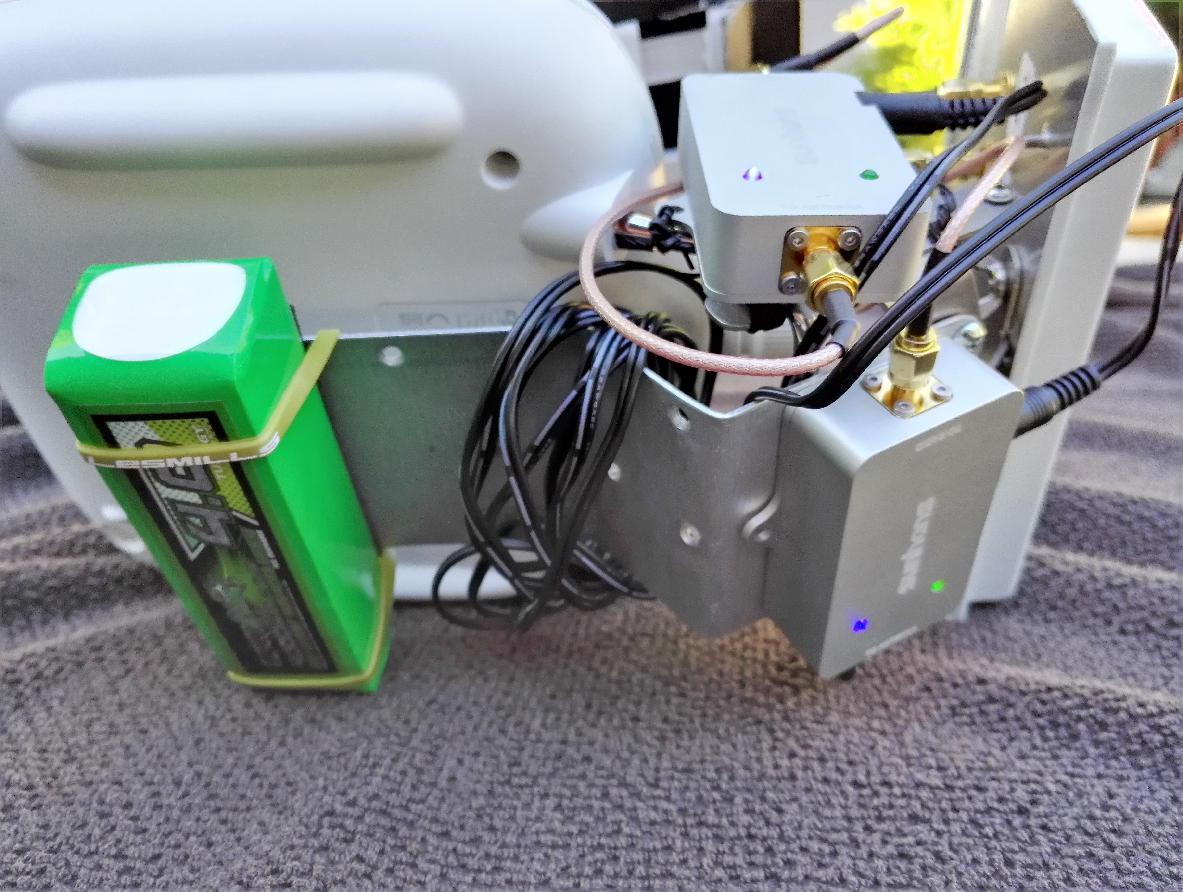

Some pictures of sunhans phantom three standard mod.
