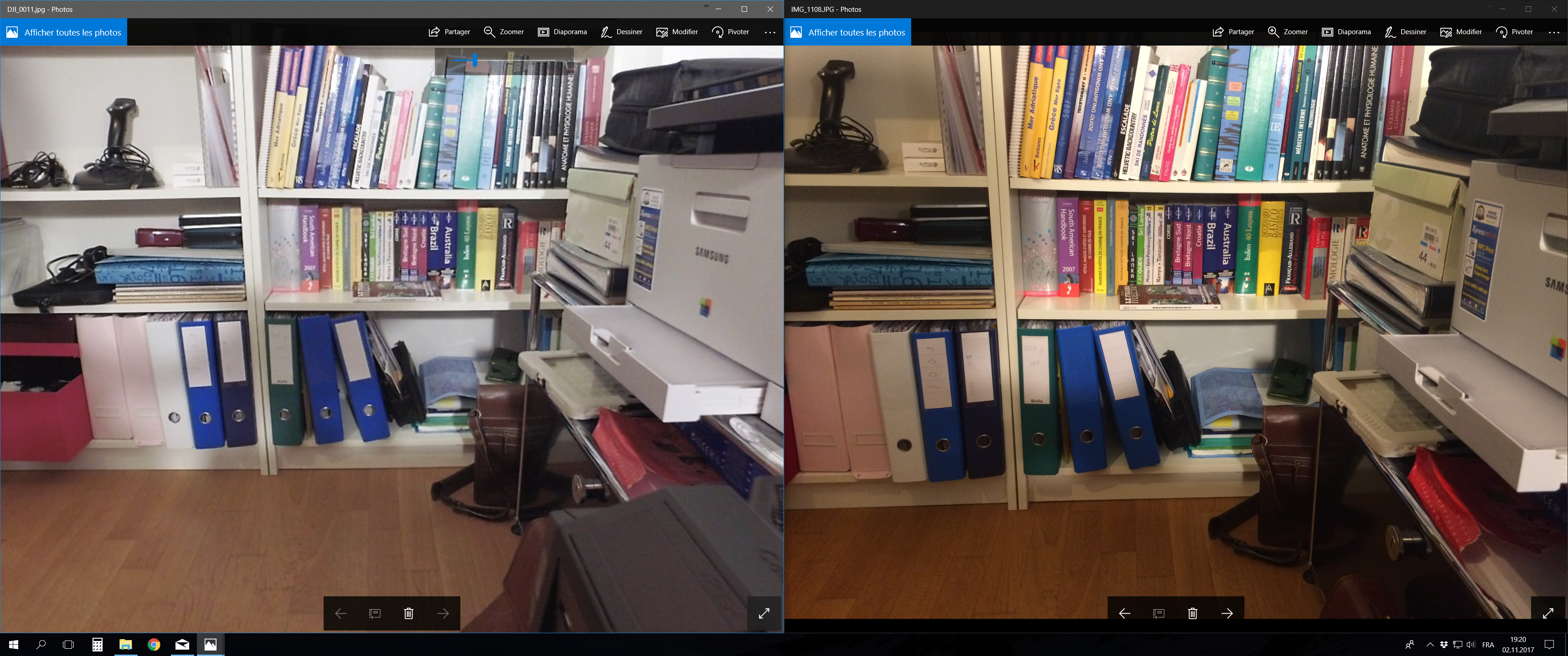

Hello,
Just wanted to know if this picture quality (RAW, auto), which is worse than with an iPhone 5s, is normal:
DJI phantom 3 standard on the left, iPhone 5s on the right.
Thank you, JF.

Hello,
Thank you, JF.
It's all washed out. Good thing it's in RAW as all those things can be adjusted. If you would like to send me original file I can show you what's possible. You may need a drop box or similar site as RAW files are heavy on the gigabytes
Agreed left is overexposed .The angle of the shots are also not the same slightly differentCompare when you have same settings on both , shutter , apperture , ISO , focus point lighting etc , otherwise it's meaningless.
Your answer is no, it's not normal. As noted already, it's overexposed. And RAW files are unprocessed, unsharpened. You have the capability to do more with it.

The photo from your drone is over exposed and the iPhone pic isn't.
You might get a better comparison if they were both well exposed.

Thank you for your advice. I mainly wanted to know if I had some hardware problem that I should return to DJI. Some people pointed out focusing problem that could be solved by rotating the lens. I tried this and it changed nothing.
Thank you for your advice. It’s a bit odd that the drone picture is overexposed as it was nighttime and light was quite low in my office. Should I put a ND filter at all times?
No .. an ND filter won't prevent that.
The camera's metering system would then give a longer exposure as it would still try to give what it believes is a correct exposure.
You could check the exposure over-ride adjustment to see if it's on EV0 or is set to overexpose a little.
If it's a consistent issue, you could set it to EV-0.3.

Ok, I will try that. Thank you!
Holly Cow!!! this fixed a problem I was having.....WOOHOO!!! Ive been using a filter for the past week trying to fix it. Thanks for posting this guys.
