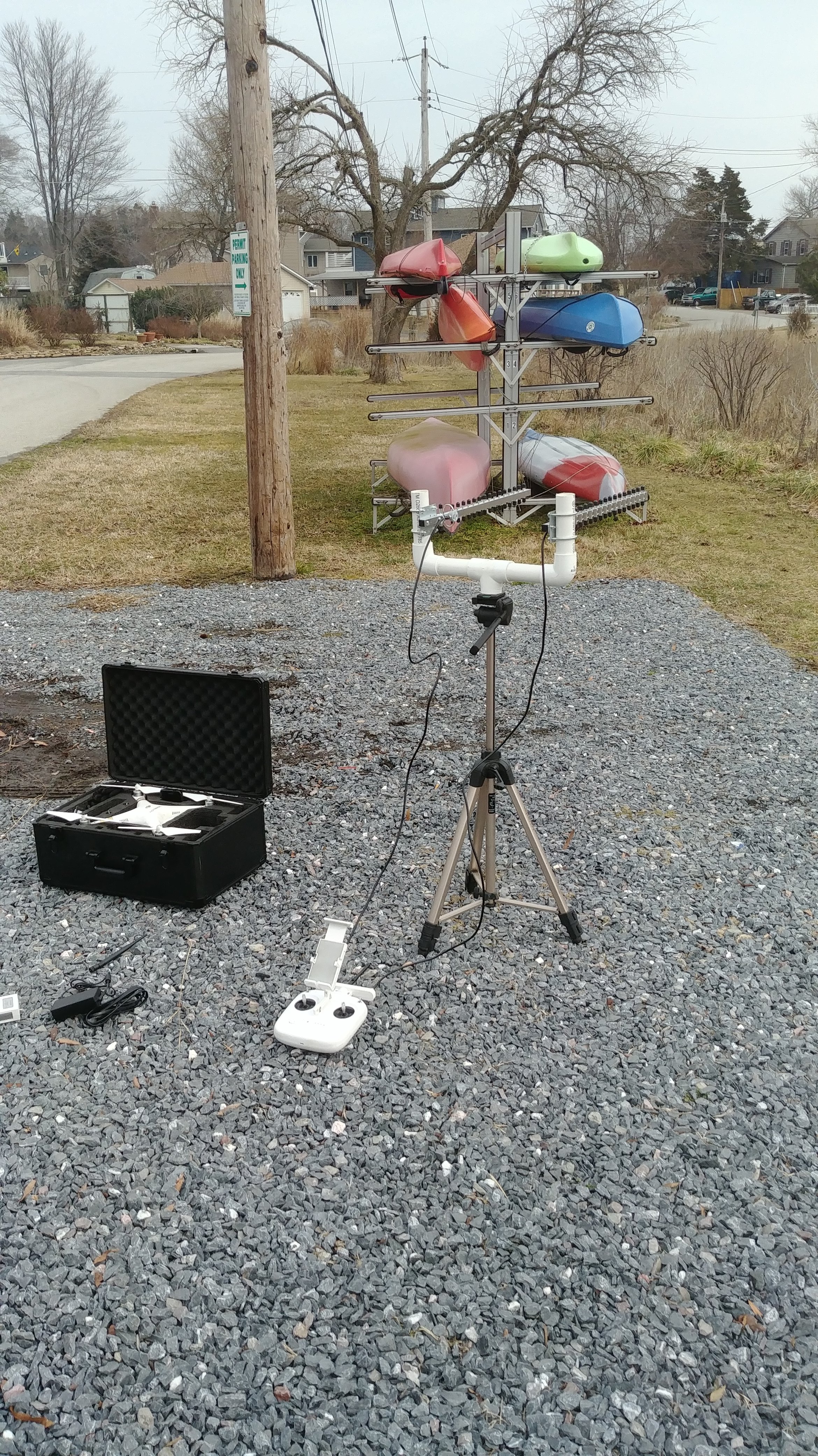

. 16,000 feet stock battery, no amplifiers. Custom 2.4 yagis

Hah, LOL....at first glance I thought the boat rack was part of the antenna, and the boats were colored sand bags holding the antenna down steady from blowing away. I was thinking... Oh my, how long does that take to setup? I guess he only needs to fly in one direction. Then I put on my glasses. That's was a good yagi laugh.

Lots of dB gain with that nice side-by-side array. Perfect choice of terrain. Congrats!

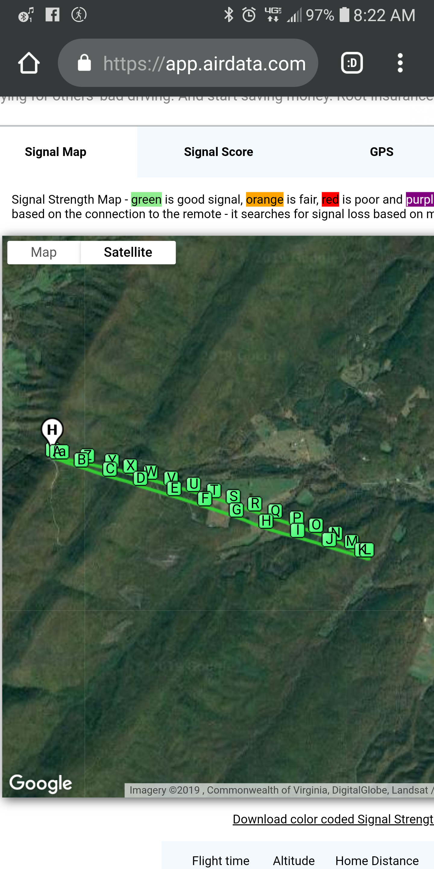

On a tripod best in a straight distance run. 16k was battery limit had a 100 signal score on airdata, signal would go more. Have to find a halfway point to land. Lol

16k was about the limit of battery. No need to fly farther than I can get back home.

I did the argtec mod to remote, that gave me 2 miles. I mounted 2 25 dbi gain yagi antenas on a tripod, very directional. Keep this in mind you will loose signal if drone is above them even 100' feet up. Also keep an eye on wind. I was at 78% battery when it turned to come home into a head wind, 20% at landing. Very high in pucker
