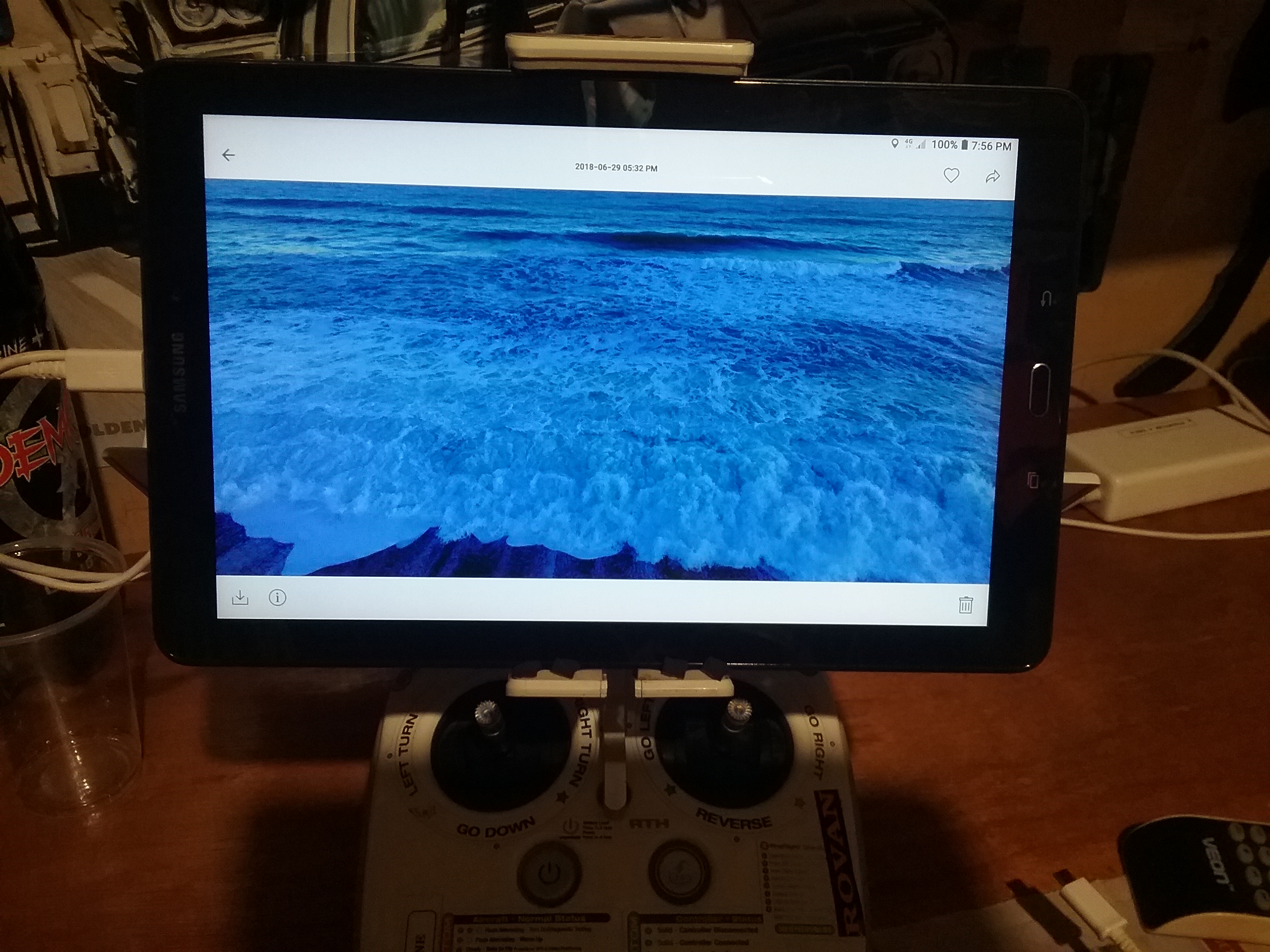

We tried multiple tablets. Seeing them in the sun while flying is a huge problem. The above tablets are okay. In the end, you need something that does not require a shield, tree to stand under, etc.
While our tablets are primarily used on DJI Go 4 for Phantom 4 models, I believe they work fine on DJI Go for Phantom 3s. These are industrial tablets that are designed to be daylight viewable. Compared to a Google Pixel 2 with its adaptive screen, this is hands down better. Check them out at:

I started with an iphone 7 plus (too small). Tried an ipad air 2 which was unsteady, bulky. I am currently using an ipad mini 4 which is perfect!
