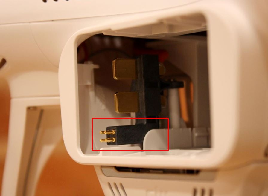

Perhaps check to see that your battery is fully inserted and also check the spring loaded data pins. One of those two has been the issue when some others have posted about no telemetry.
Update, I found my problem, upon several hours of messing with stuff and observing, I on happenstance put my original usb board back in, but didn't screw it down, when the board moved, everything came back, my flex ribbon from the main board to the usb/hdmi board is going open on one circuit apparently. A very small movement of the usb board will cause the telemetry and video to drop out and come back. The connector tension feels tight, tried cleaning with contact cleaner on both ends of flex ribbon to no avail.
