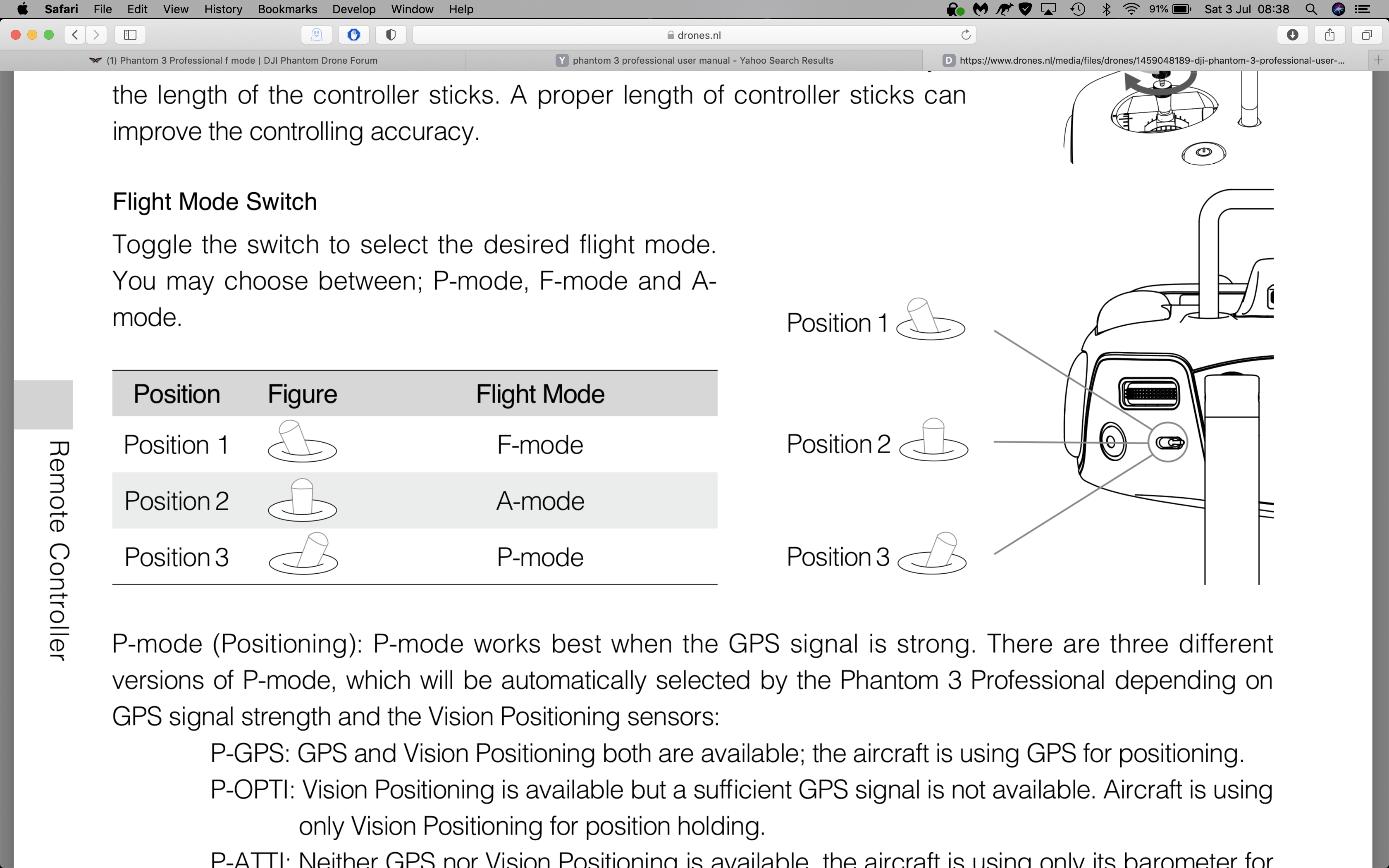

I presume he means the Flight Mode switch on the Remote Controller in the "f" position?
Have you read the manual?
F-mode (Function): Intelligent Orientation Control (IOC) is activated in this mode. For more information about IOC, refer to the IOC section in the Appendix which says:
By default, the Flight Mode Switch is locked to P-mode. To unlock other flight modes, launch the DJI GO app, enter the “Camera” page, and tap “Mode”, then activate “Multiple Flight Mode”.
