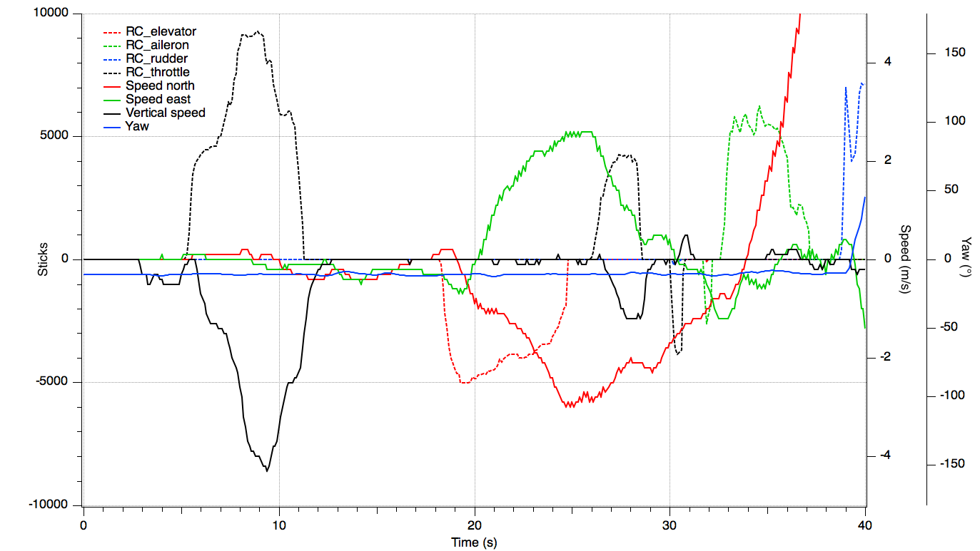

I haven't flown my phantom in a while and today it wouldn't hover but immediately started flying sideways. To avoid hitting a tree I took it up higher and it continued to fly away. Panicked I hit the home button and it DID land safely on it's own. I downloaded the error log and have no idea what this stuff means. Can anyone help me understand where I went wrong?

The problem is pretty clear. The FC was reporting multiple compass errors and the error is apparent if you compare the motion of the aircraft to the reported heading and stick inputs:
The yaw heading was initialized as close to north (-11°), but when forward elevator was applied at around 19 s, it pitched forwards and moved south-east. That clearly illustrates the compass error, and explains also why it was drifting around - its attempts at positional holding were compromised because its yaw value was out by around 150°.
I would suspect that the problem was caused by taking off from a location with a distorted magnetic field, but it could also be a bad compass or a compass needing calibration due to changes in the magnetic field of the aircraft.
