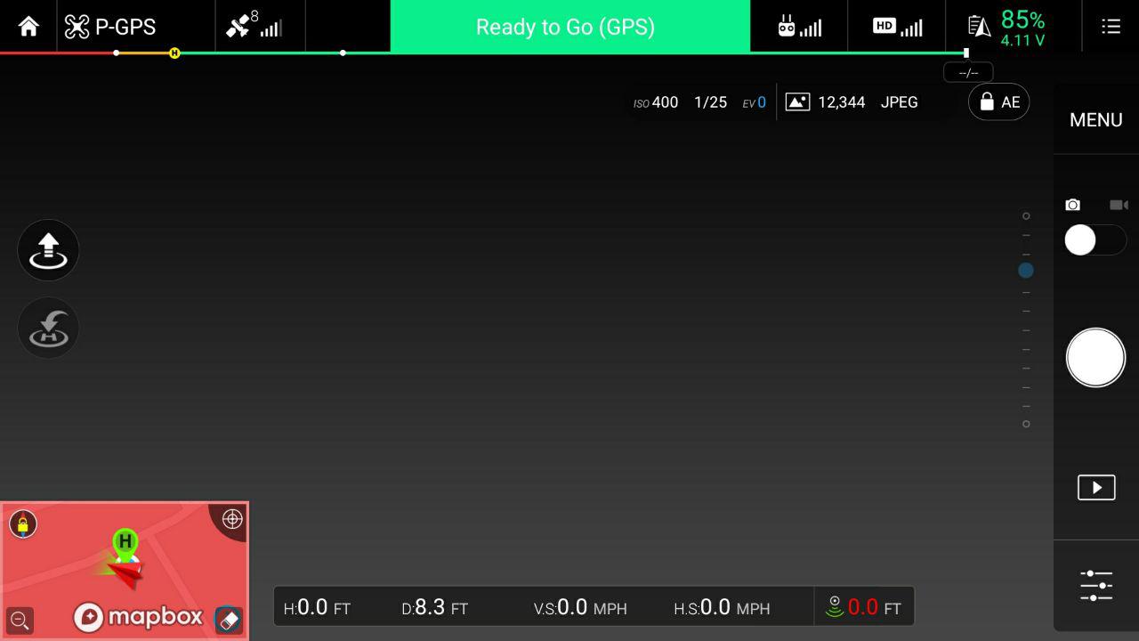

looks like camera is black, even tho it doesnt show any sign of problems.
This trick fixed my black screen/no live video: with the AC and remote powered up go into settings and enter "flight data mode". You'll know it is in that mode when the rear leds on the AC arms go out and stay out. You'll also see the status message on your display saying "flight data mode reboot aircraft to exit". At this point power off the AC and power it back on (leave the remote on). If your lucky like i was your live video will return on that power up.
