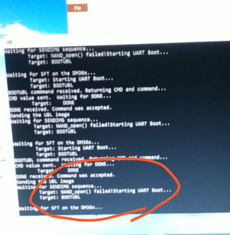

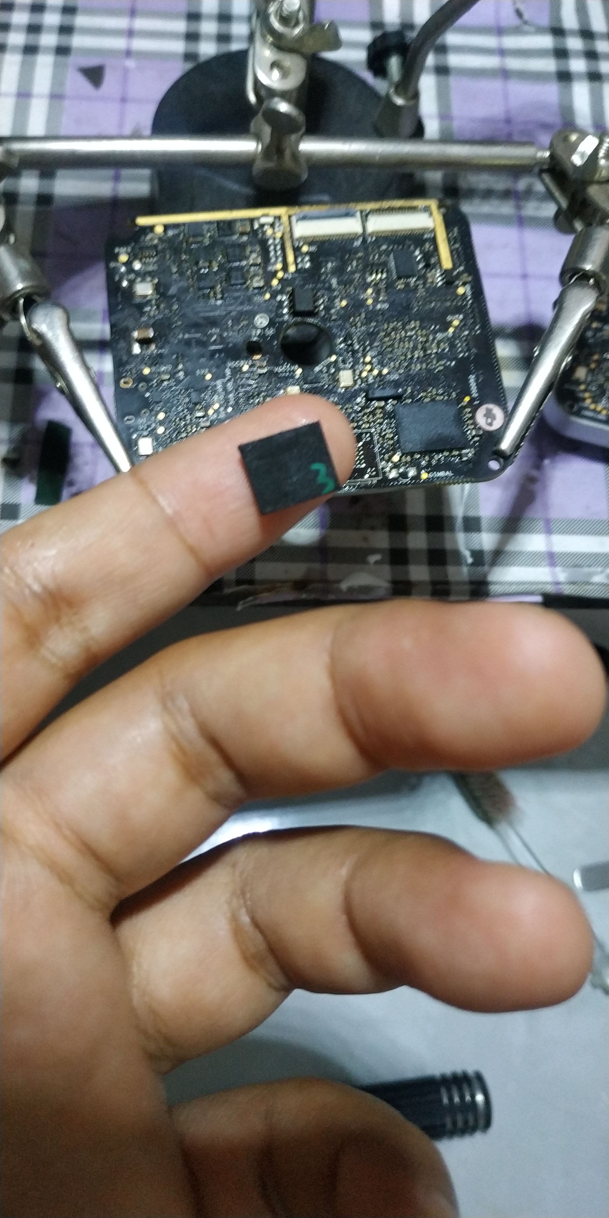

dji phantom 3 pro gimbal board is off, I tried to check the normal 12v voltage, for 3v 5v it doesn't exist ... please help sir, what components should I replace ... thanks for the help.
halo pak, saya ada masalah flashing board dji phantom 3 pro gimbal, ada kerusakan nand flash chip yang saya tanya ... saya pasang board phantom 3 pro gimbal, apakah berfungsi sebagai board phantom 3 advanced gimbal tanpa menggunakan flash nand chip ...

hello sir, I have a problem with the phantom 3 pro gimbal board, the damage is on the nand flash chip, if I modify the phantom 3 pro board so adv can I remove the chip and upload advanced firmware ...?
Please help.

can I remove the chip and upload the phantom 3 adv firmware ...?
Some people did that. Though none cared to prepare a detailed guide.
You need to desolder at least one zero ohm resistor and re-solder it in different orientation to route the video from Ambarella to the USB which connects to OFDM board. And you need to change the firmware. I can't remember much more, but this was discussed in public posts, so you should find at least a few more details if you search.
