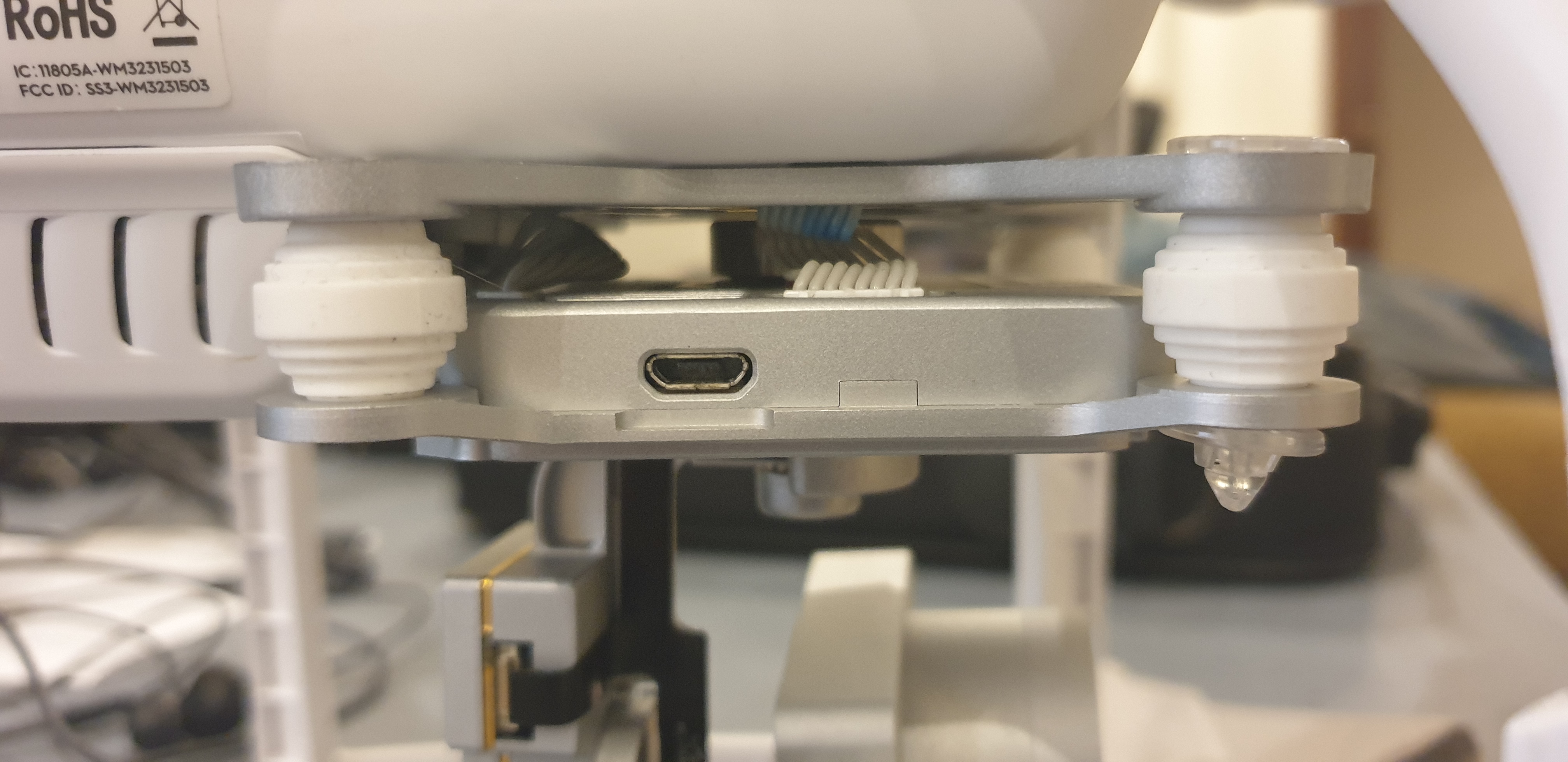

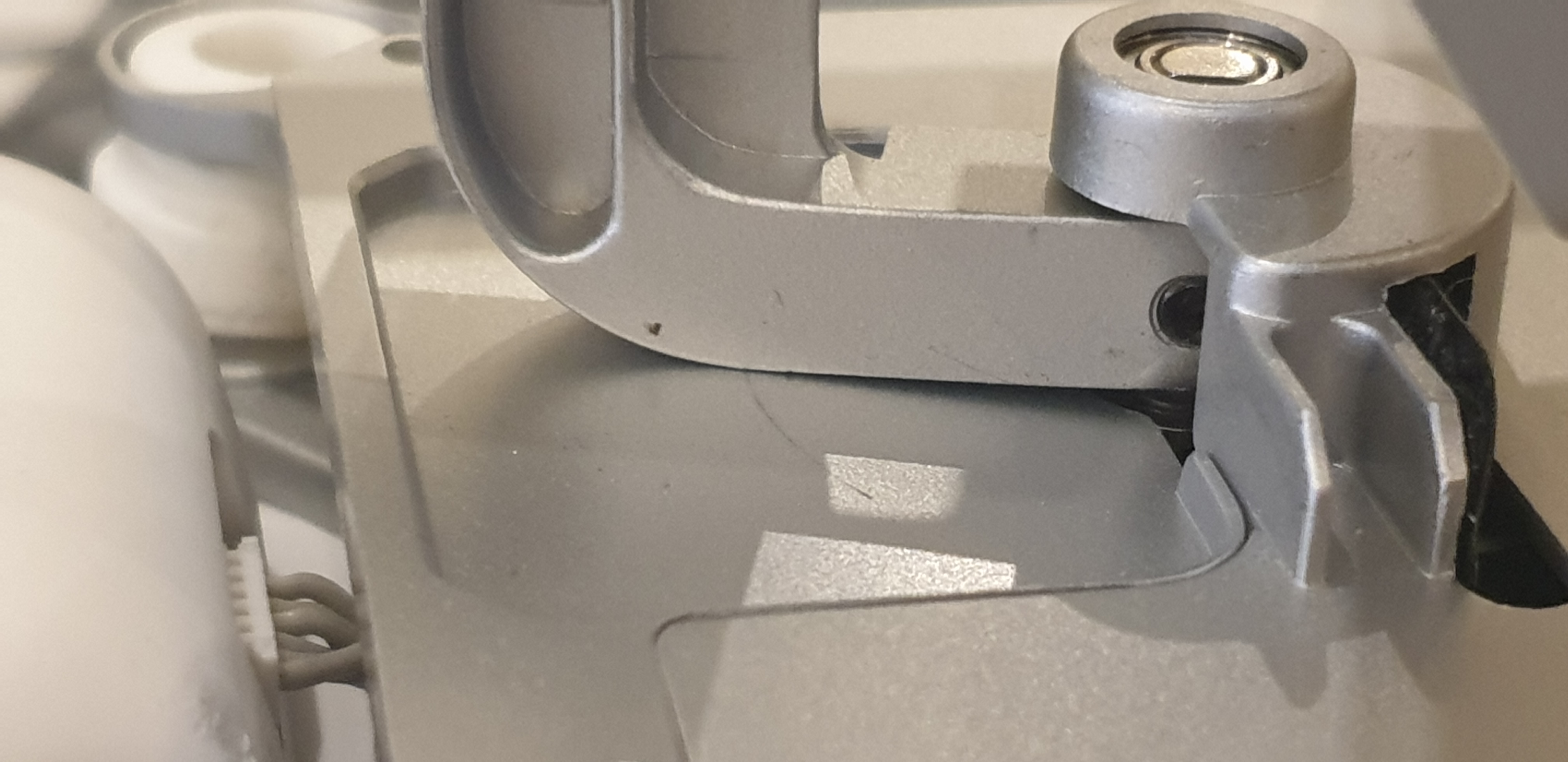

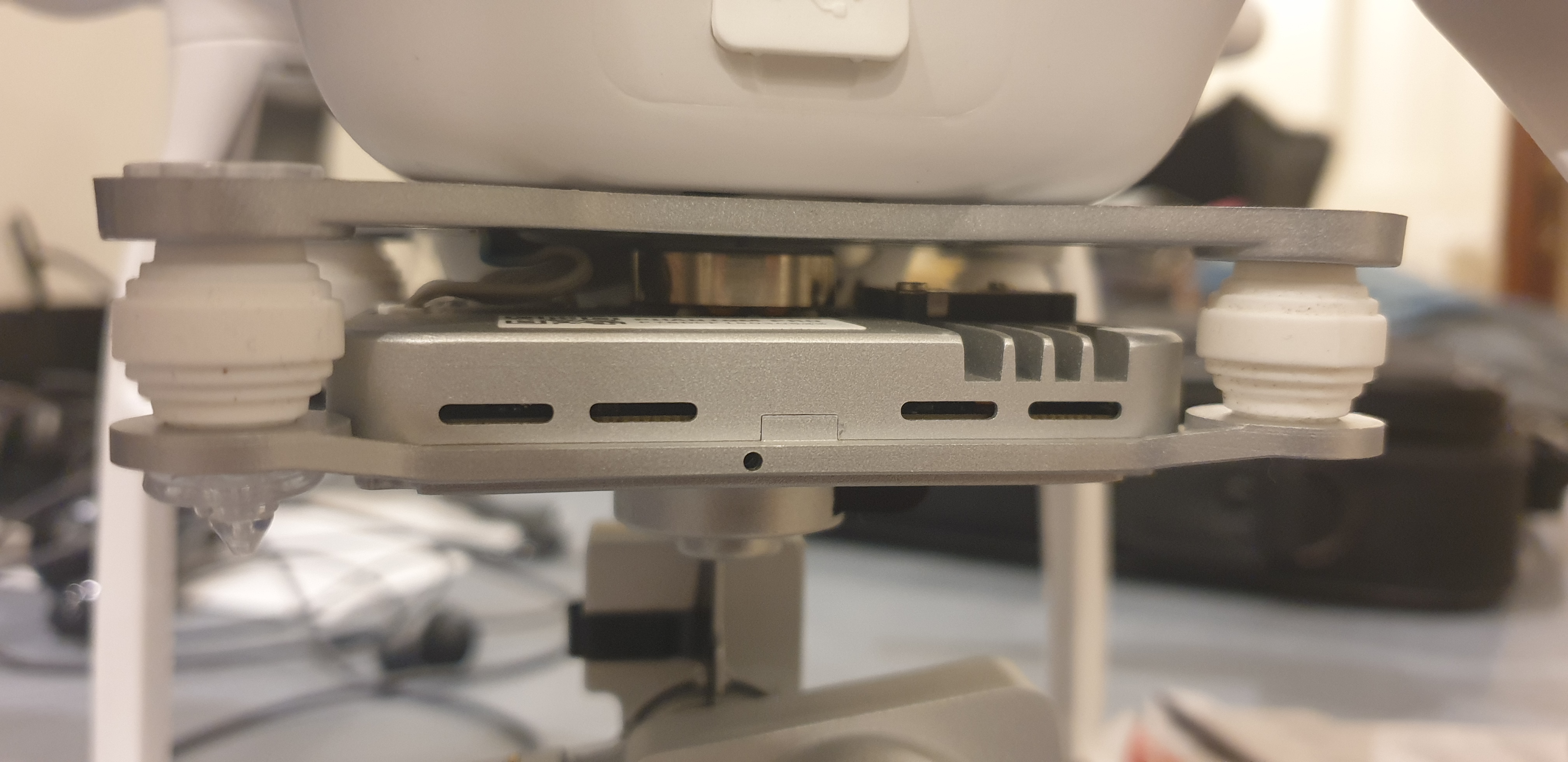

i have found now that the arm of the yaw motor is touching a little bit the base of the mainboard, there is an arc little scratch on the metal, do you think is it the problem?
The yaw arm slightly touching the plate can be remedied by loosening the set screw and adjusting the yaw arm up a little bit. I doubt it is a problem though.
yeah i have done that now, tomorrow i will test it because it is night here so what do you suggest is the problem?
I can't see any other issue on the photos.
By looking at the photos, photo # 1, you may have a rubber damper of a different size on the right front. Maybe from a phantom 2? Don’t know if it would make a difference.
Boom Boom i solved the problem , was the Yaw Arm touching the base of the main board,
Thank you for your Help
