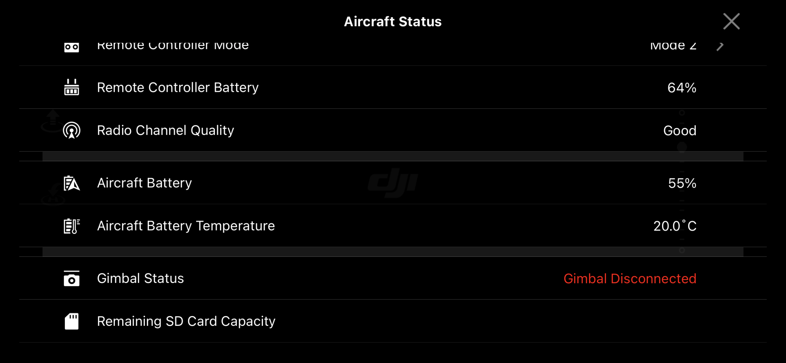

Take a screenshot from the error-message you get and post it here.

Attached is a picture of the error message I’m getting in the app.
