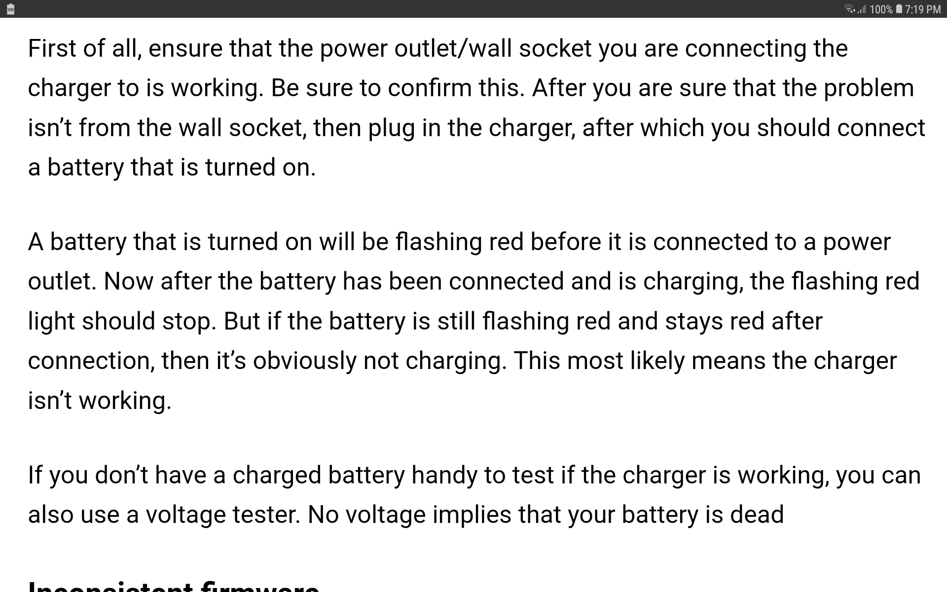

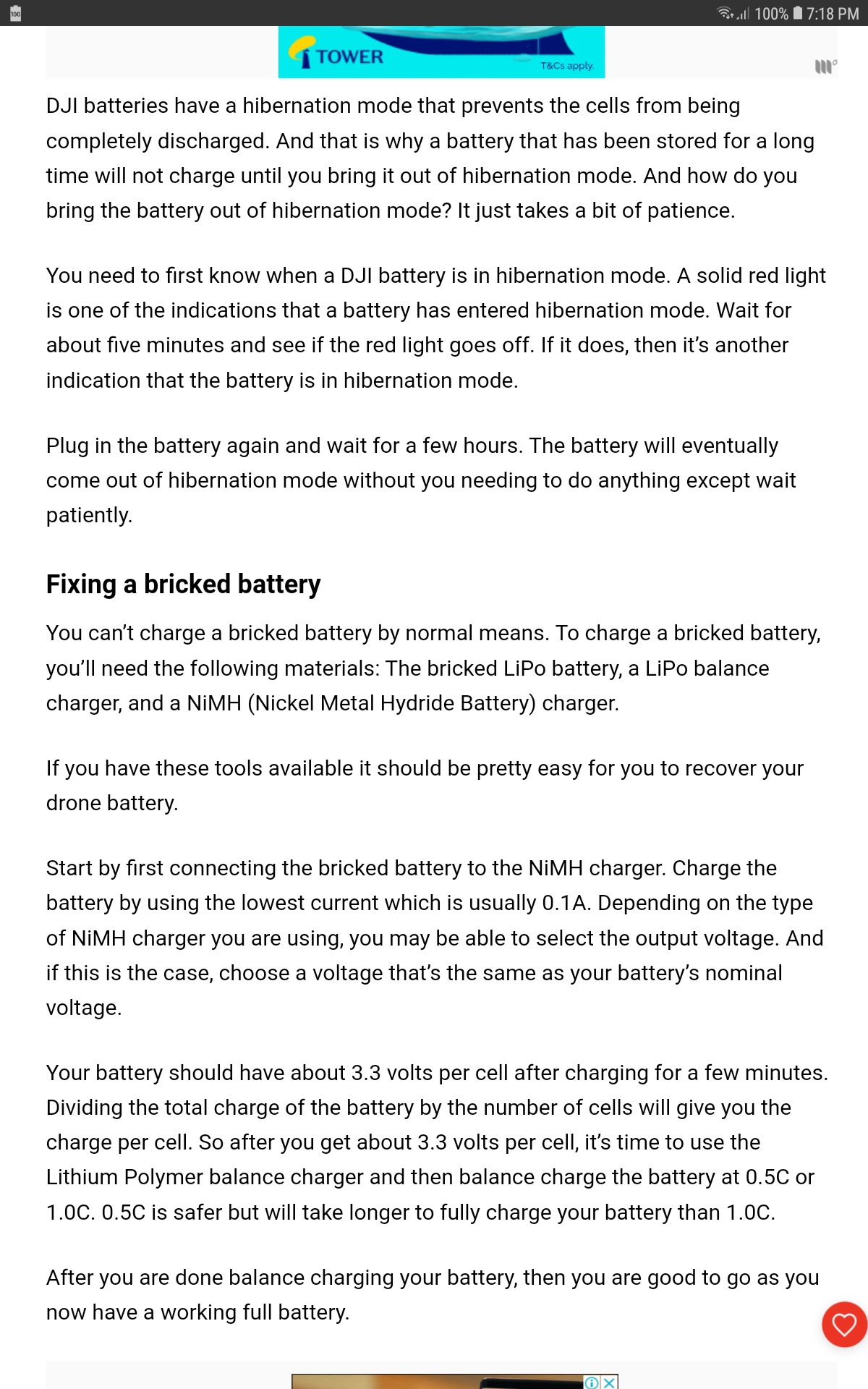

Here's a bit about hybination and charger check
