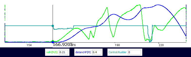

Here's what your log shows:
  • The Phantom was in P mode the entire time (GPS_ATTI = P mode)
  • The mode did not switch to ATTI at anytime
  • The GPS receiver was connected to sufficient satellites after takeoff
The only odd thing I see is the drifting you described above. All was well until you started yawing the Phantom. At that point, it started to slowly drift away. And, that drifting continued with no stick input after you stopped yawing.
@BudWalker, can you take a look at this one? Per the DatCon CSV output, here are the notable tick marks:
113773: Hovering in place with no stick input
180931: Starts to yaw (with stick input) and drift (without stick input)
187105: Phantom still drifting (without stick input)
I can add a little more understanding. Starting at 177.3804 and for the next 7 seconds there was no stick input.
During the next 7 secs the P3 moved away from the HP. The pitch increased from 7.5 to 12.4 and the P3 responded by slowing down, finally arresting the drift. Almost like the P3 got caught in a gust of wind but was really slow in responding.

I tried the drone again this morning at sunrise when the wind seemed to have dropped, to try to reproduce the drifting issue and took it up to about the same height as before. It hovered above me and seemed stable, so I switched to the periscope app ( as before). As I started to turn the drone, it drifted quite fast with the wind, which must have been about 20 mph at 50 mtrs AGL. I let go of the stick and it slowly returned to it's start point. I tried again with a similar result, so used the return to home which worked but seemed a bit slow.
I downloaded the DAT files (there were two this time for some reason) and have posted links below. I would appreciate your opinion, and maybe suggest the cause of the drifting issue. The Periscope App froze when i first turned the drone, but I think that could just be a coincidence, as it didn't do that last time. I will try to do another test run with just the DJI App if the wind speed drops again.

This morning I tried a couple more test flights. First I calibrated the IMU before the first flight, then using just the DJI App. At 50 mtrs AGL with a light breeze I rotated the craft first to the left and then to the right. Each time it drifted away about 30 mtrs and returned slowly after I released the stick.
Then before the next flight I changed the sensitivity brake from 70 back to 100 and tried again. This time no drifting occurred, even at 75 mtrs AGL, so re-setting the brake seems to have solved the problem.

Neither of the last .DATs you provided (FLY109 and FLY110) had a motorStart. I.e., they weren't from an actual flight. No wonder you had trouble understanding the values. :) If you look at the bottom half of this page there is info about selecting the right .DAT.
I tried with both my P3A (firmware 1.7.60) and P3P (firmware 1.4.10+) to duplicate the problem that you're seeing with your P3. The P3s were slowly rotated at 30 meters and 100 meters but didn't drift off with the wind. What firmware does your P3 have? I can't think of any other relevant difference between our P3s. Since there is clear evidence in the .DAT of your flight maybe we should ask DJI tech support why your P3 behaves this way.
