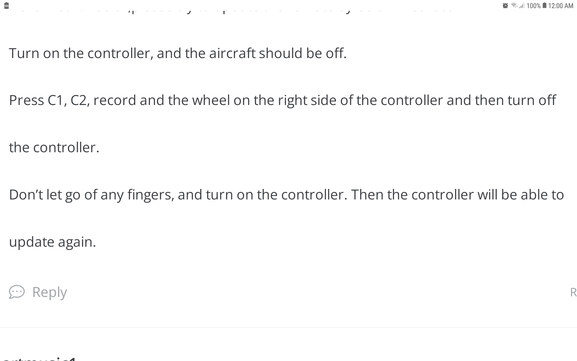

Oh where to start,,um try this for remote update again.....the below method...

Oh where to start,,um try this for remote update again.....the below method...View attachment 122499

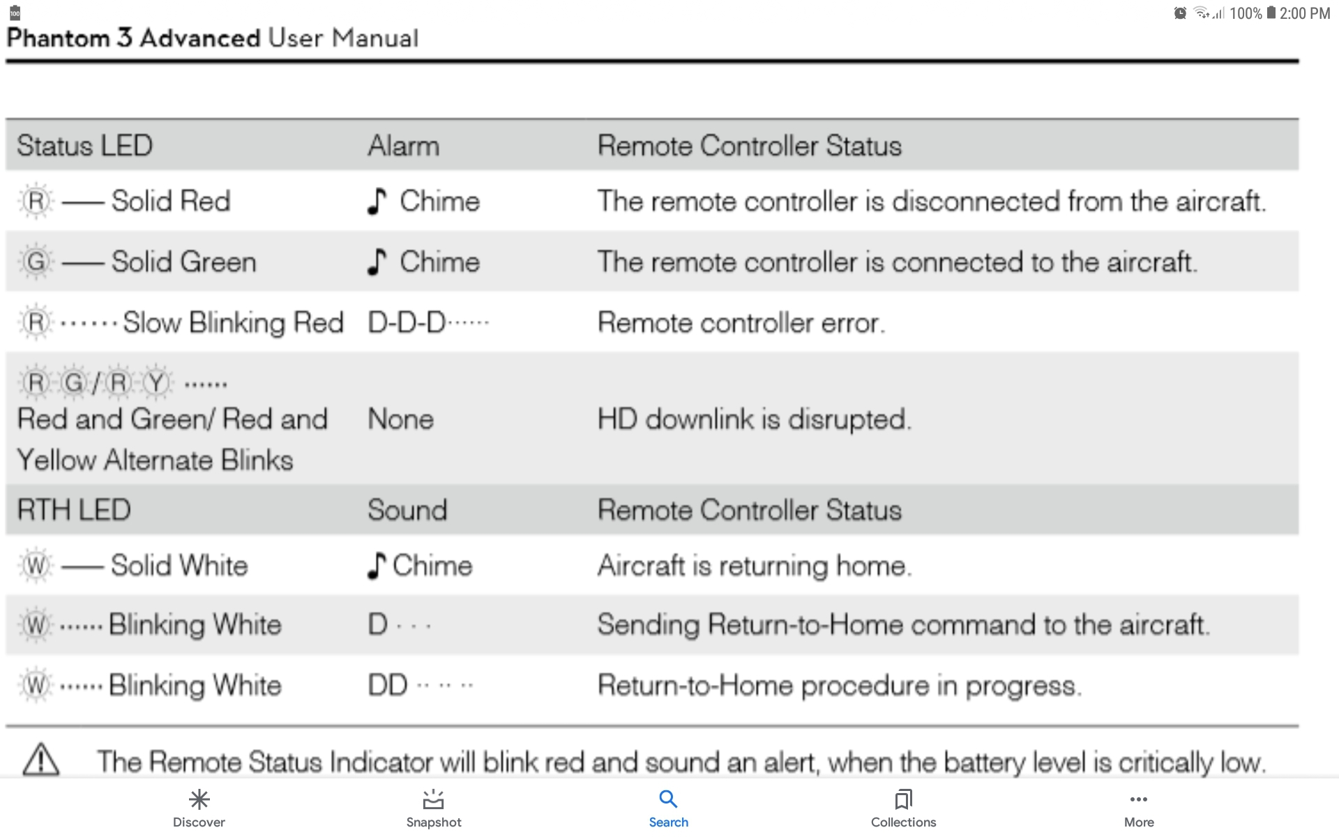

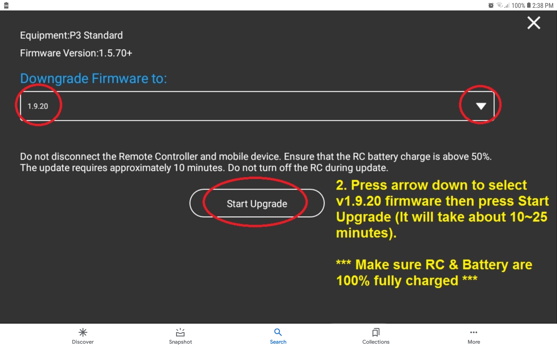

Does remote charge ok ?,,,,light chart says rth in progress so sounds like a firmware issue,,also try power remote on,,start the djigo app,,on home screen it has 3 black lines top right of screen,,press for 2 seconds and another screen comes up with firmware version that MIGHT allow a roll back to previous version,,

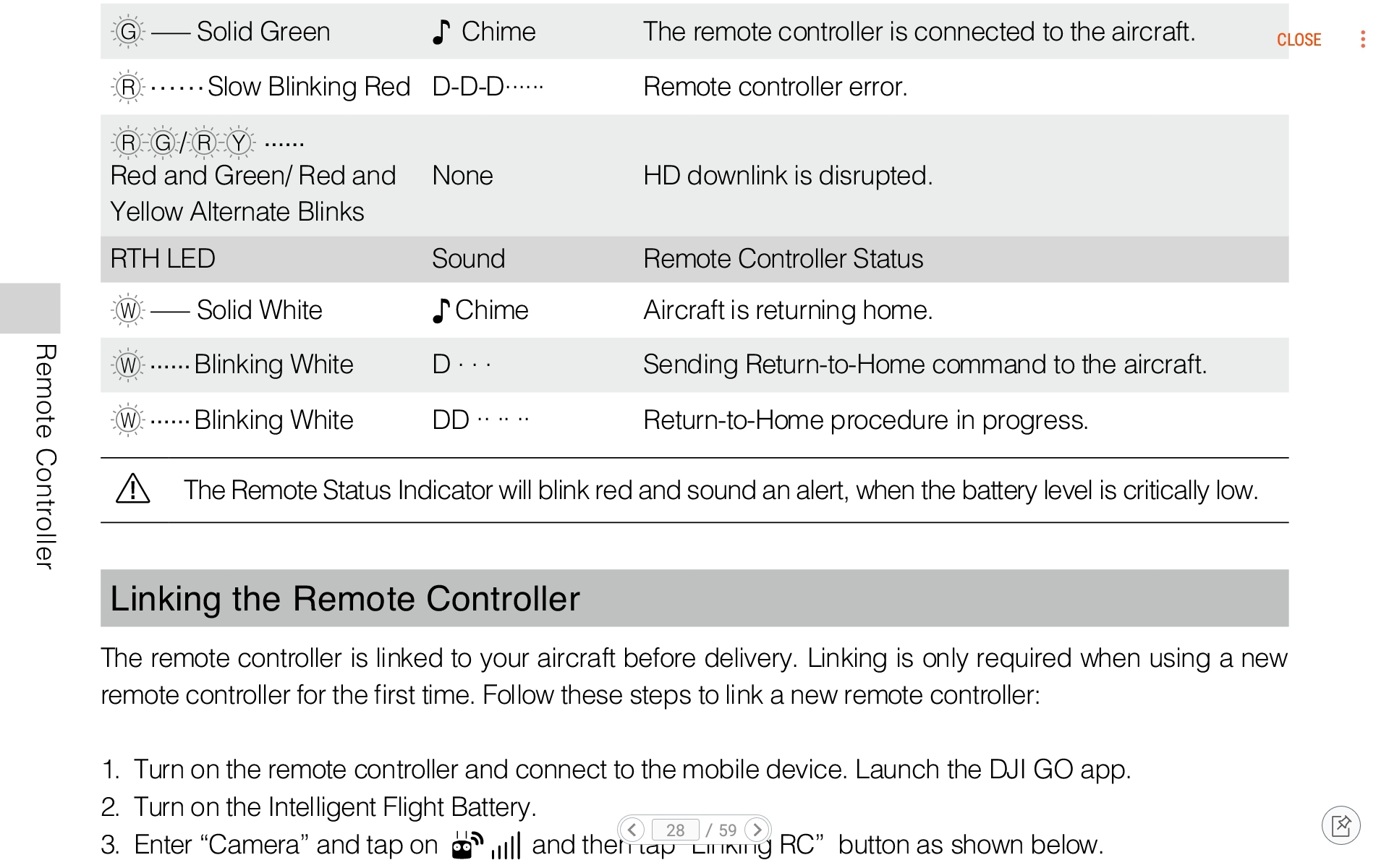

If you have Google search on white light on remote you will see how many and sometimes how tricky to get right again,,,,myself been searching with not lot of luck,,out of curiosity what colour is the link light on the drone when remote and drone are on,,should be green but your remote might be white with 1 red,if drone has red aswell it need linking,then remote will go green but you need your ribbon fixed for that,,hopefully you can roll back the remote to what it was on the extra screen I mention
Light chart below

You should get a screen like this come up after pressing 3 black lines top right of homescreen....this one p3s but just example,,hopefully it got a version there because sometimes it dont give roll back option
