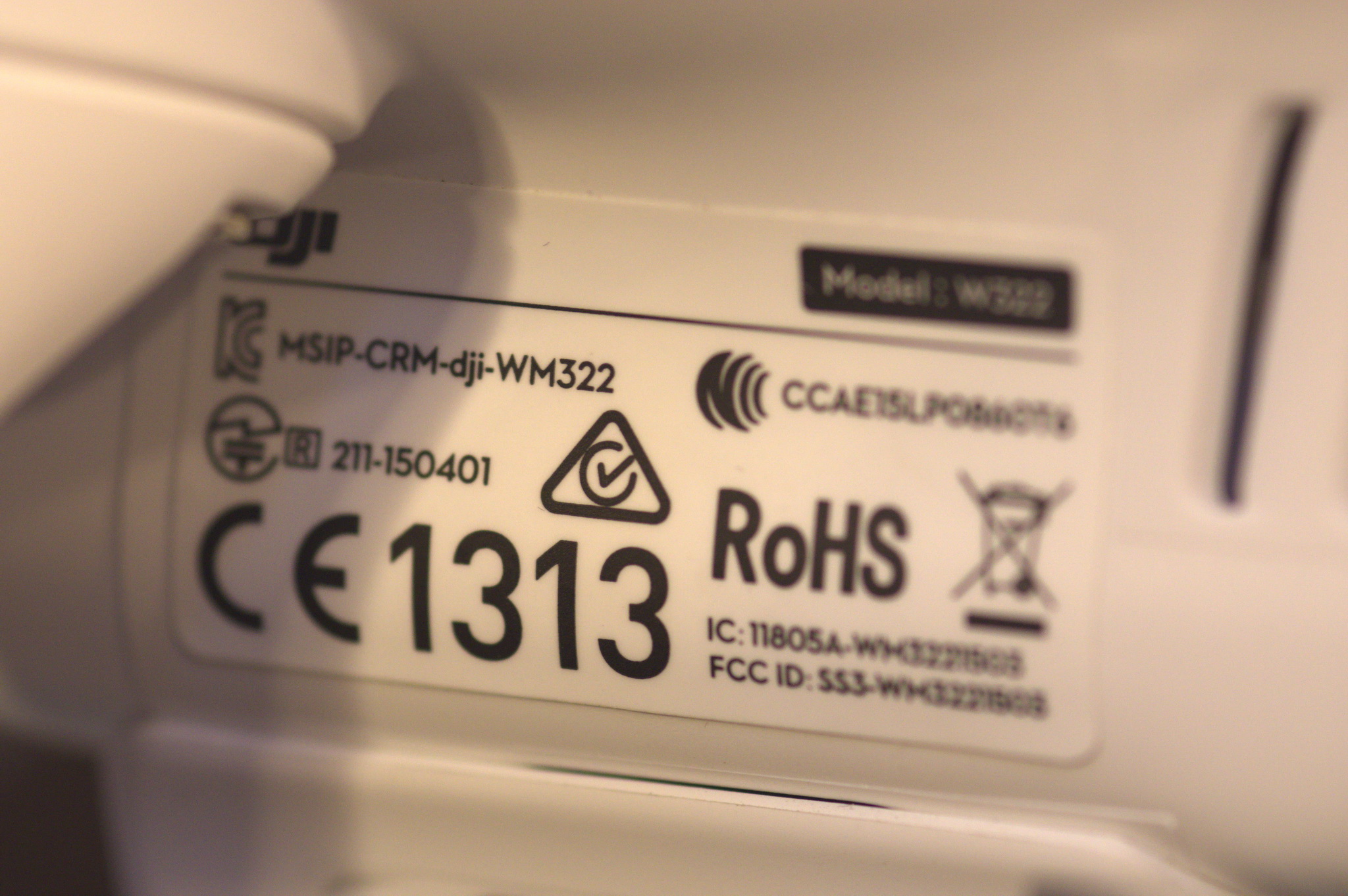

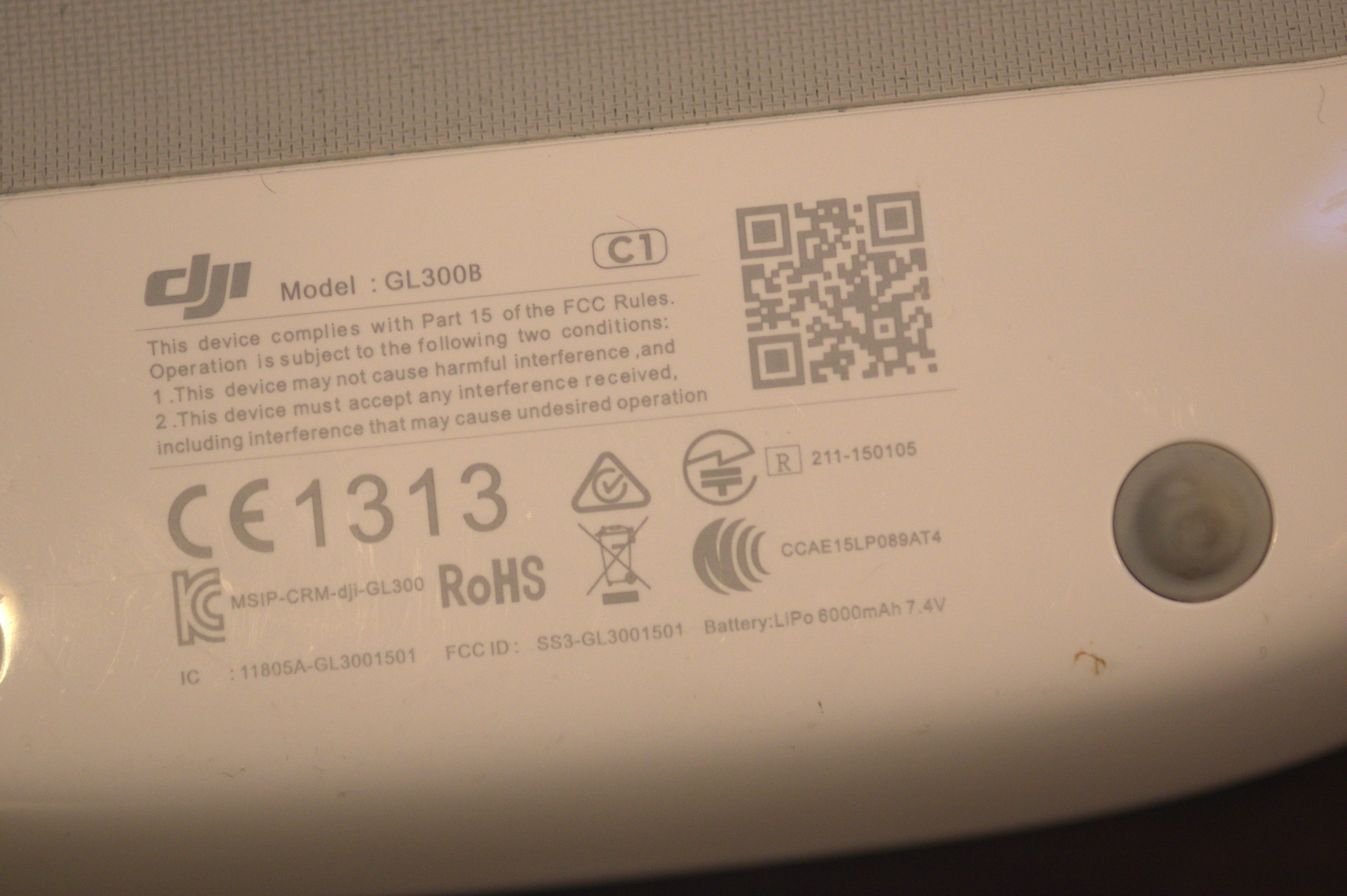

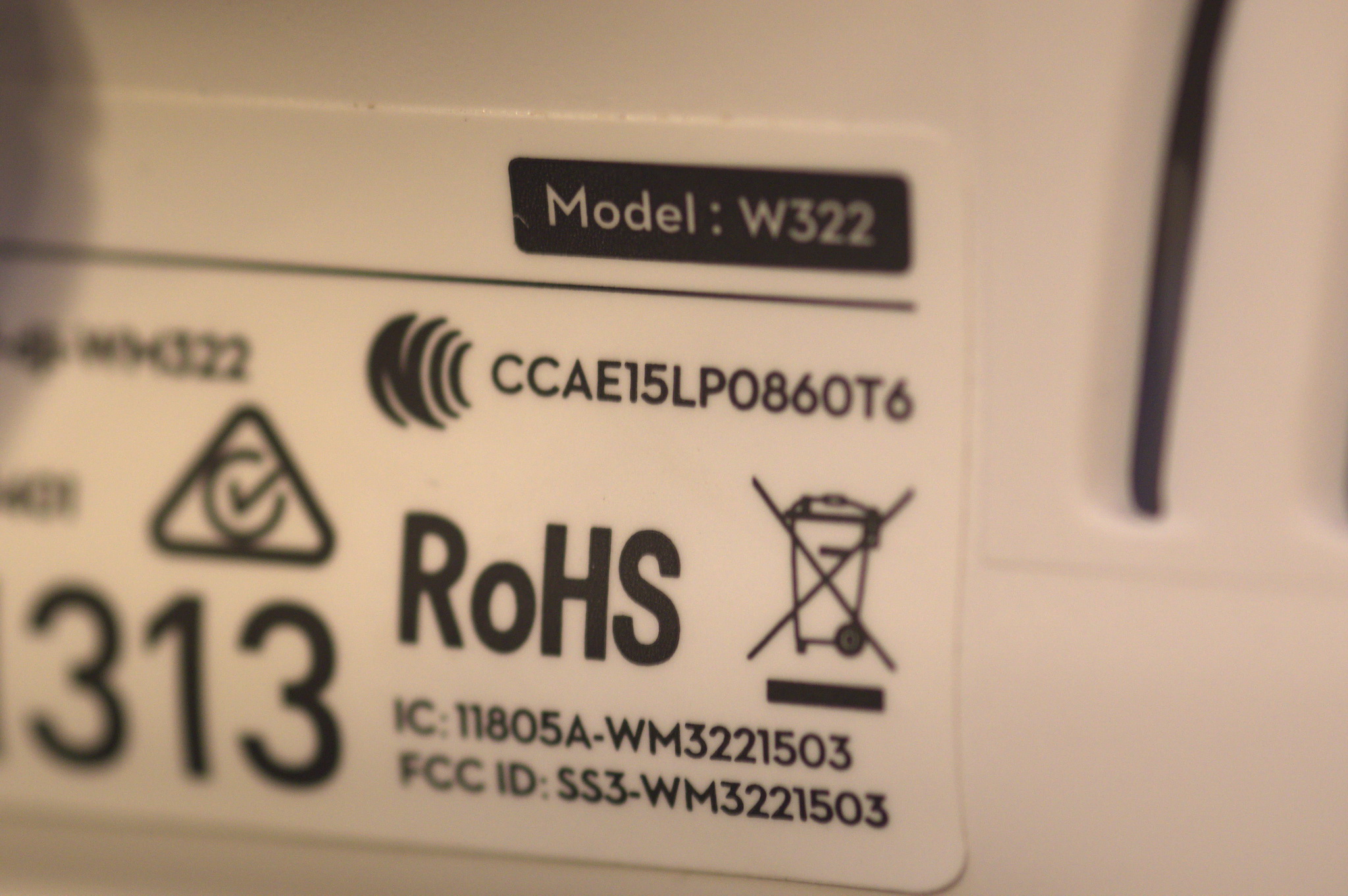

Hi again. I figured I would attach a few images of both radio controller and the drone just in case the something to do with the model number that is preventing the firmware from updating. I hope that you will be up to help some more.
I figured it wouldnt do anything, in later versions of the FW the usb updating option was disabled and the only wayis thru the app. But since you can't connect to the app there's not much else you can do. Was worth a try though. Its very likely that there's nothing wrong with the AC so at this point all i can suggest is either buying another RC or sending that one in for repair. Maybe there's another forum member here who knows a way to fix the usb issue on these RC's but my searches have found nothing.
