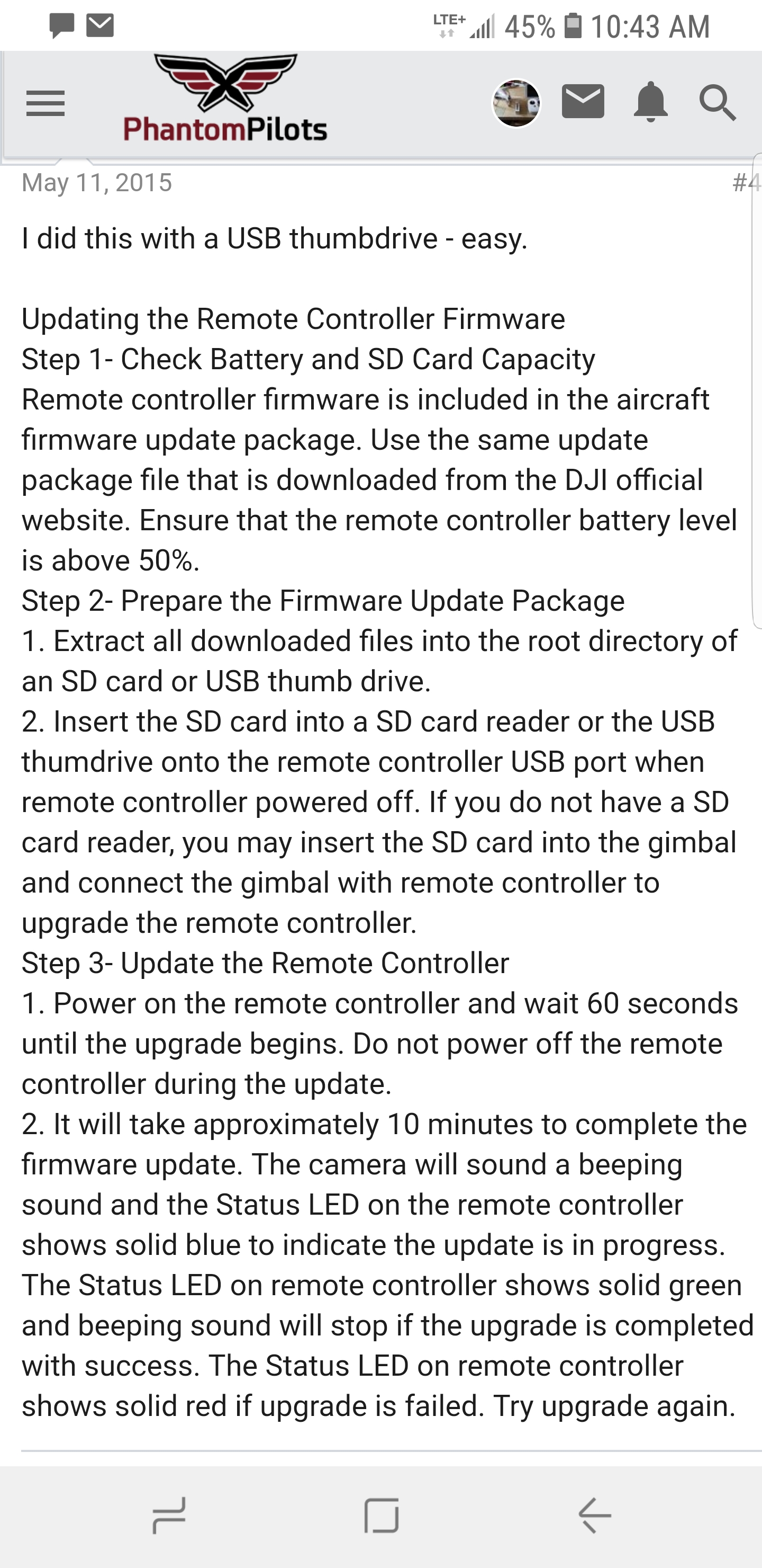

It's not a linking issue if it says disconnected so yes my poking the AC button is invalid for now at least. We've narrowed it down to either a bad usb cable which you say cant be the issue, or, there's an issue with the RC. Since it won't connect to your phone/tablet there's no way to tell what FW version you are using, nor can the RC access the internet to update itself. The only thing i can think of now is to manually update the FW on the rc using the old USB method which I've never done. Hopefully someone else can advise on that. If your RC is the "A" version you might have bigger issues as that particular model uses a different chip (the DaVinci) and its known to act weirdly and just outright quit at times. You may end up needing a new RC.
Ok i found the old usb/sd card way of updating the RC FW. See attached screenshot
Depending on what version of FW both your RC and AC have you may need to update both so you won't have a mismatch. Also, if both updates are successful, at that point you may need to relink the RC and AC.
