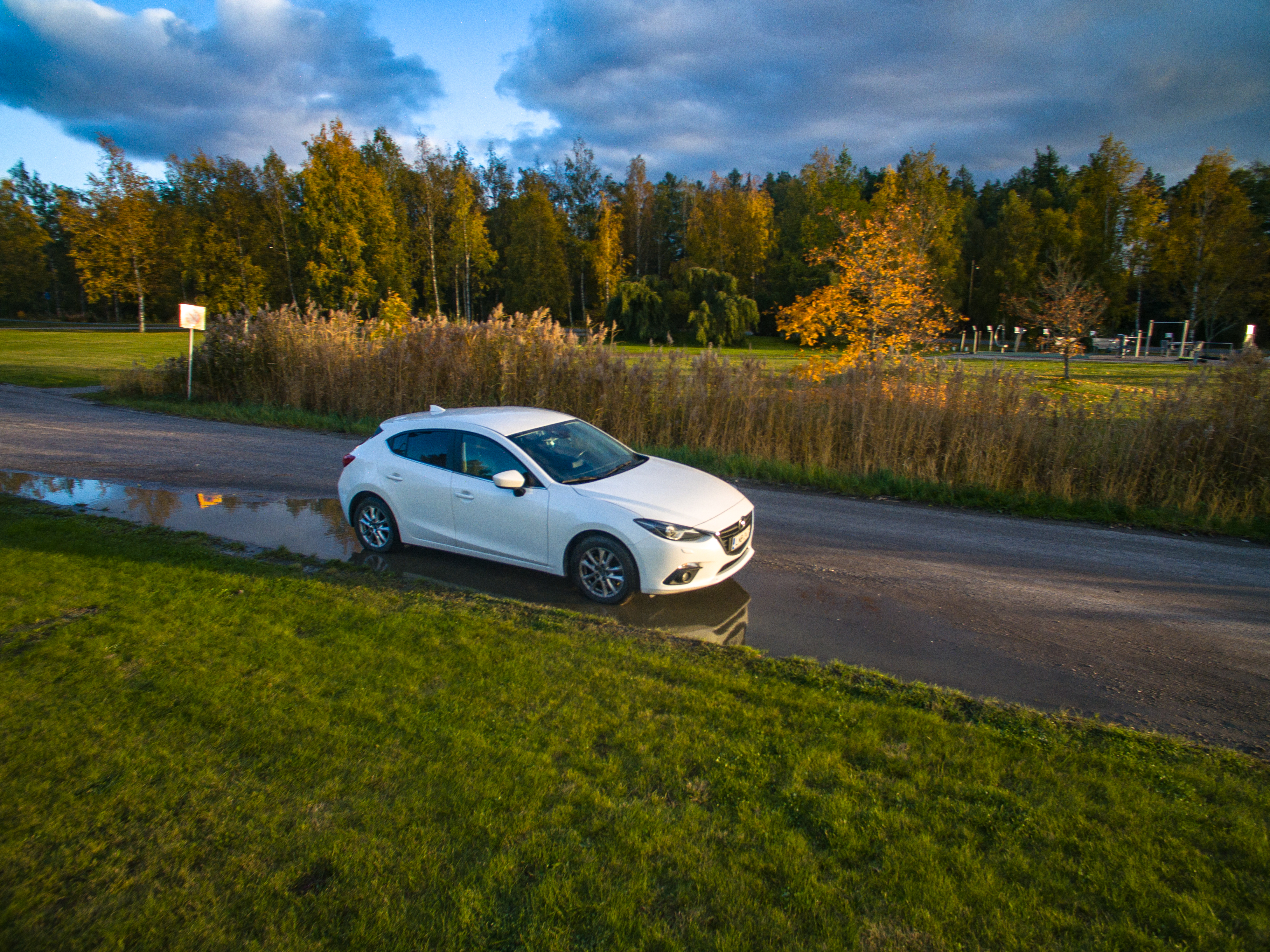

I bought a used P3 4k a few months back and have mainly been using it for landscape photography. That's for two reasons: I like doing it, but also because I don't think that close-up pictures of a certain subject look very good on my P3 4k.
Today I came here to ask if the detail quality in my photos is normal, or is there a problem with my camera?
Here are some sample pictures. They have been shot in 4000x3000 (native res) DNG and went through Lightroom.
Note the lack of detail/sharpness/focus on the person and the overall car picture.
Is this normal quality or is there a problem? Or am I just bad at taking pictures?

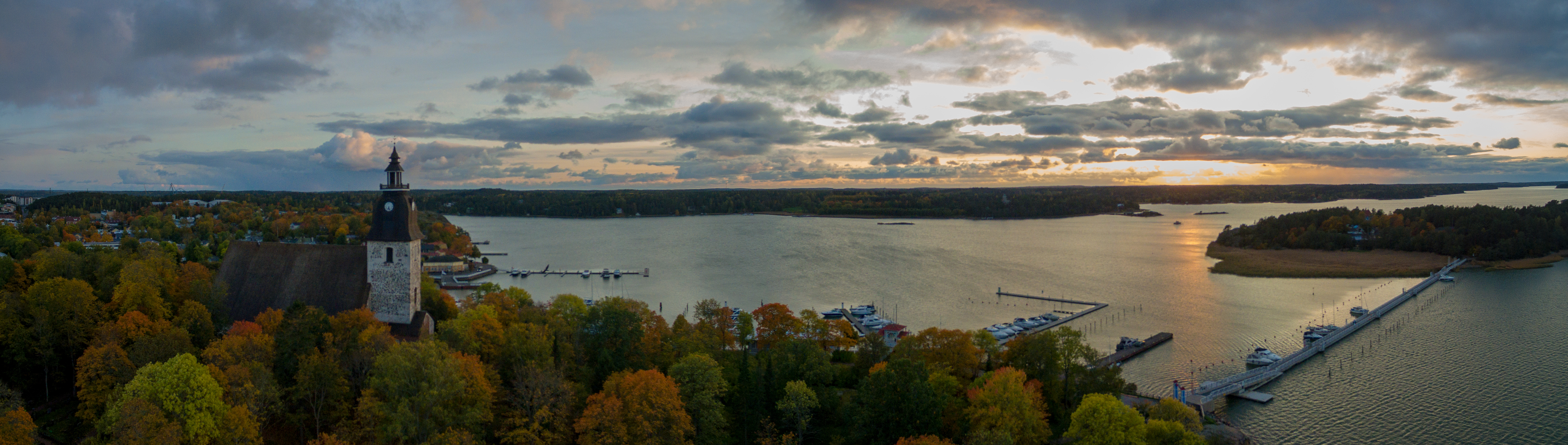

However, here's a taste of the landscape pictures I have taken which are ok.
helsinginranta (2 of 13).jpghelsinginranta (6 of 13).jpgnaantali_pano (1 of 1).jpg

You are right that there's a problem.
Looking at those images at 100%. none are clean and sharp.
The lens on your camera is fixed-focus so there's not much you can do to make things better.
I'm not sure if it's just a bad individual camera on yours or if that model is all of similar quality.
I suspect the limitation is with the hardware.
I'm aware that there's no focus or aperture settings to be changed. But I have read that the P3 has had some camera sensor board positioning issues that cause a focus problem. Could this be a similar situation, to be fixed with tinkering of the sensor board?
