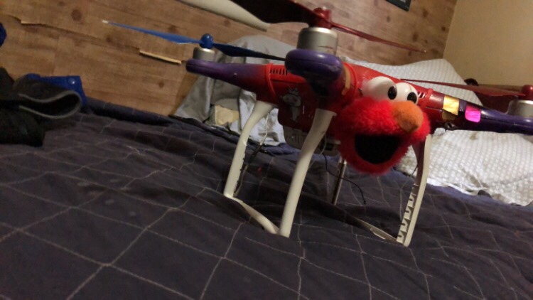

Only problem with that, it will show white between top and bottom shell. Unless you do a better job than me, I tried that en had ro take it apart. Best of luck and share the pictures with all of us. Cheers
keep in mind you have to sand a little so paint stick better to the shell. I didn't do that and some places paint chipped.
