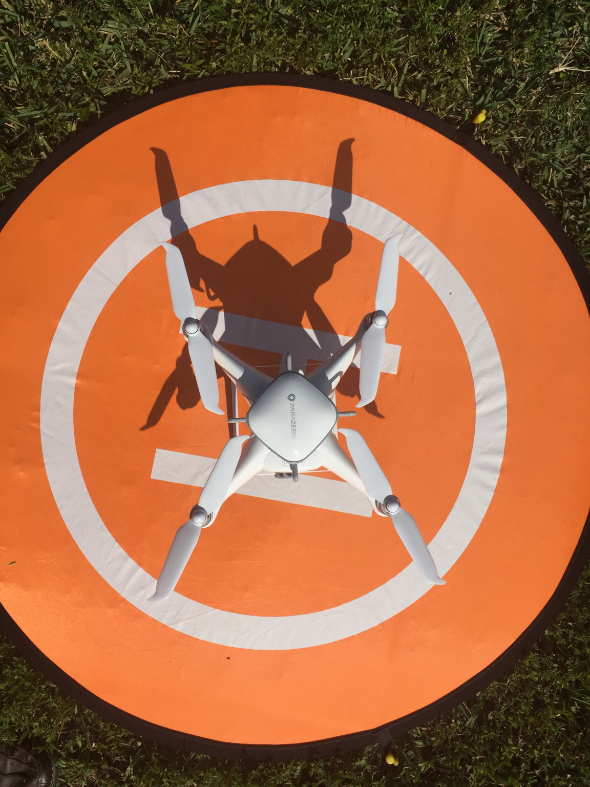

So after two flights on two different days here are my findings. Initial satellite linking went from about 30 sec with no chute to 1 min with chute mounted, and was a little slower acquiring more satellites with maximum GPS before take off of 15 with no chute and 10 with chute. Warnings received while flying were none for no chute, too Weak GPS signal, Satellite Positioning Off, and audio warning that I was flying in ATTI mode with chute. I’ve flown in ATTI mode several times and know how the wind drifts the aircraft in its direction. At no time while flying with the chute and with audio or screen warnings about GPS lost did I ever felt I was flying in ATTI mode. I took my hands off the sticks several times and the aircraft stopped as you would expect when flying P mode. The inflight average wind speed for first day was 15.8 gusting to 21.7, and second day 7.4 gusting to 11.7. I would say my flying skills in ATTI mode are fair.
I didn’t really notice much if any sluggish stick controls with chute. I only flew in P mode at a maximum speed of 21 mph as I don’t see why I would need to fly faster over people. The max speed rating on the manual has it at 43.5 and a recommendation not to fly in sport mode. The battery did see a decrease of about 4 to 5 minutes of flying time, keep in mind I was moving most of the time vs staying stationary.
I would not fly with the chute on unless I were to fly over people (only if acquired waiver of course). If you want chute for protection from mishap I would tell you get insurance, it is cheaper and you can fly longer times with less work of putting and taking chute off. If you want to try and get waiver then this I hope is a step in that direction.

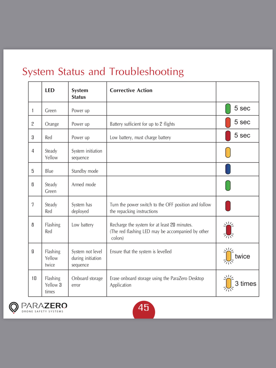

The system has a sequence of lights that indicates status of chute
. I did notice after taking off light turns green indicating system armed then when I landed for minute the light turned blue indicating standby mode. After taking off again I noticed light not changing to green so I landed again powered down motors and cycled the power button on chute then after sequence of lights and take off again light turned green. So I’m thinking every time it senses that it has landed the power button has to be cycled before it will arm again. It does state first thing to do when aircraft lands is to power down chute.

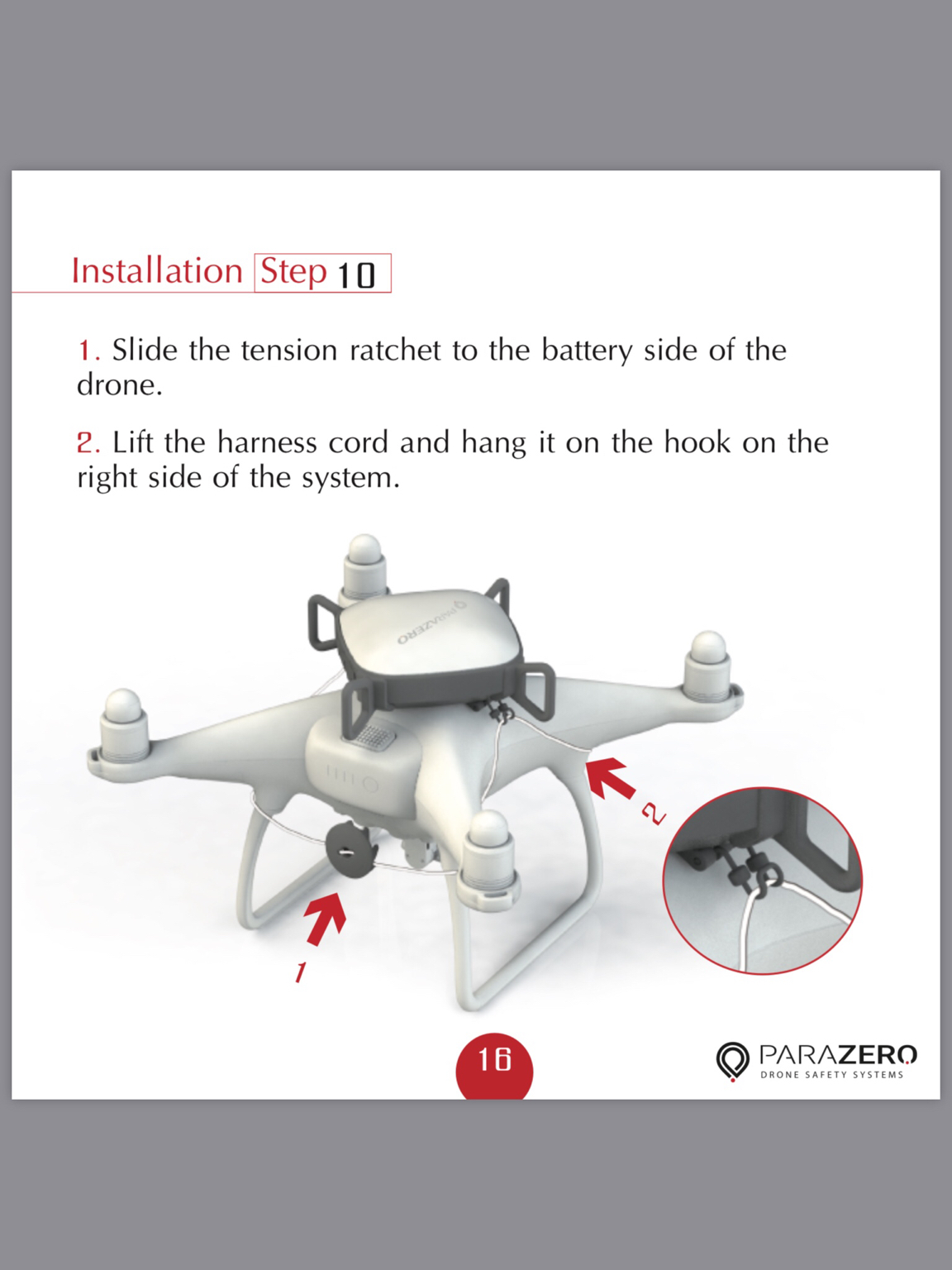

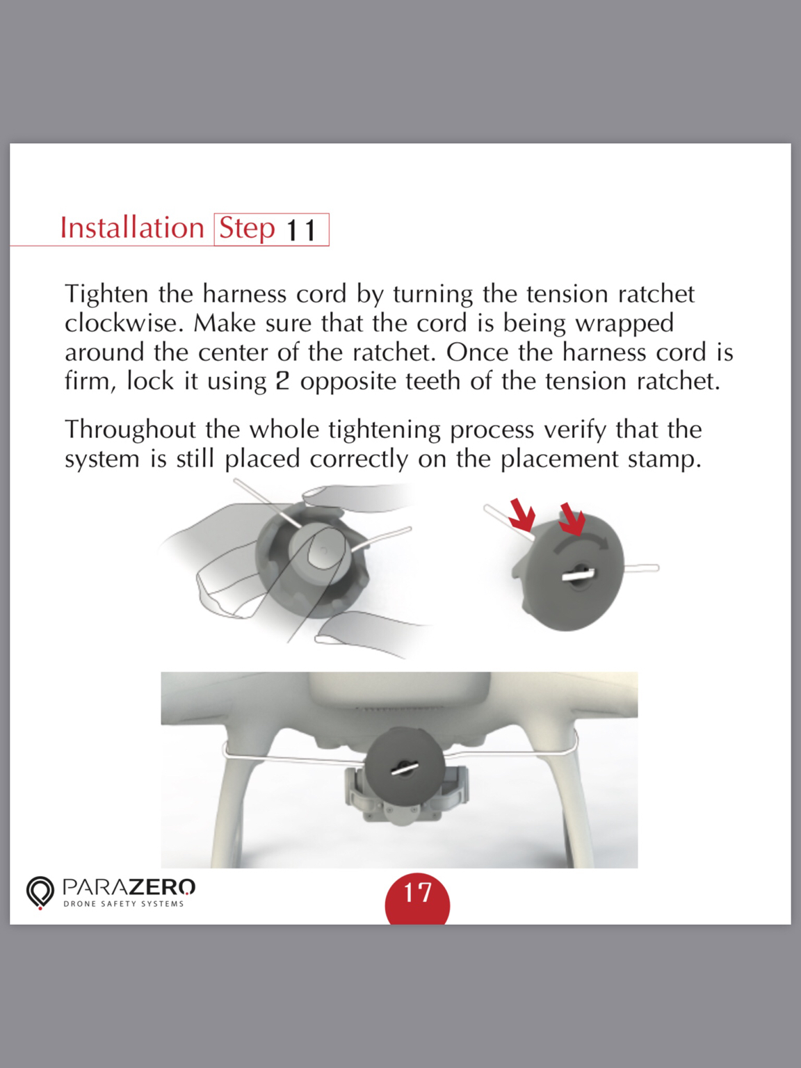

I'm curious what the "ratchet string"'s purpose is. Is it just a safety backup in case the chute pod pulls free from the top mount? Seems a bit of a hassle with all of the strings as I watch the installment and repacking video. And regarding the two parts that fly off when the chute is deployed... can you purchase those parts separately? Seems you would want THOSE attached with a short string as it looks like they could easily be lost.
After watching their videos the whole contraption looks more like a Rube Goldberg job. I am definitely going to purchase one and the add-on package mentioned earlier, once I get my hands on an approved 107.39 waiver application using ParaZero (I'm betting it will happen this year) and if I ever get a job that needs flying over people.

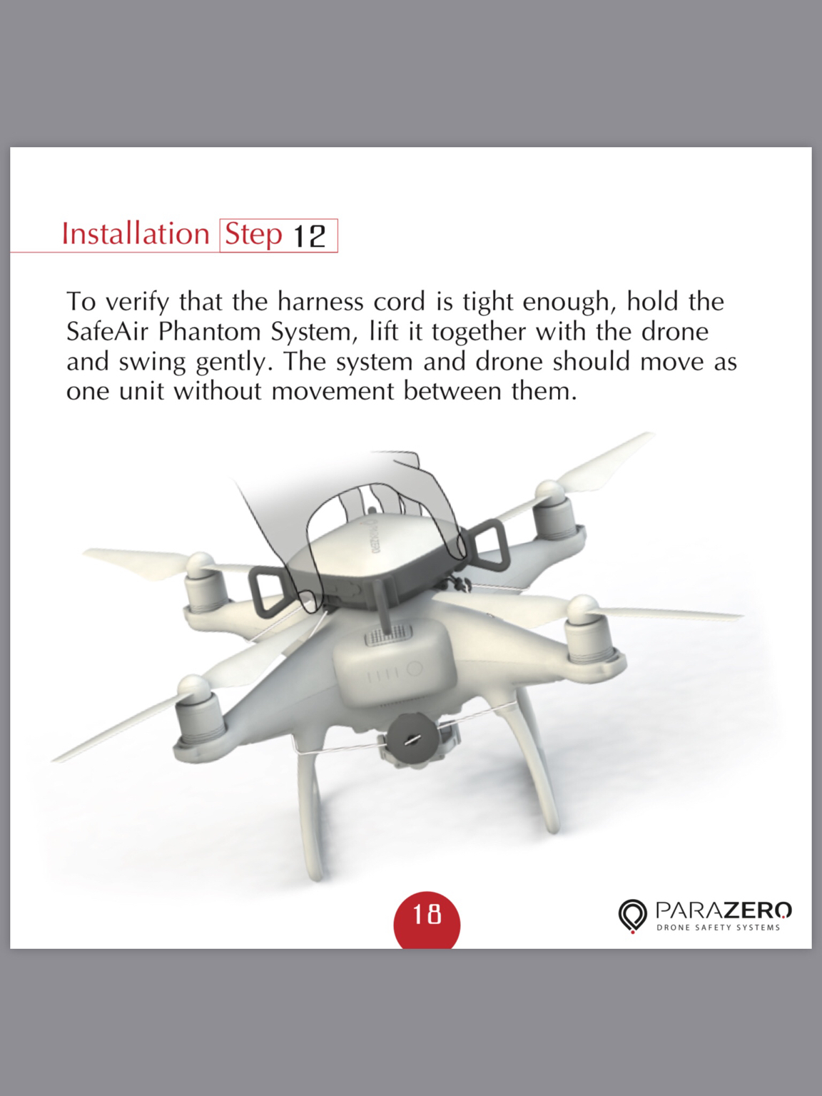

The cord is used to secure the chute to the aircraft
by turning the tension ratchet clockwise and locking it in place on teeth of tension ratchet
afterward check by picking up drone by chute and swing gently to make sure it is not loose

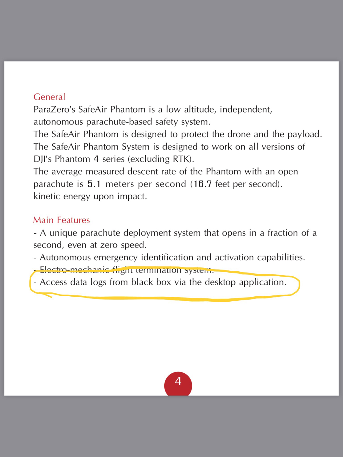

Drilling holes would compromise the integrity of the shell and the system would probably fail as the body of the chute has to rotate about 45 degrees in order to stop the props. The system has a black box which could tell if chute ever deployed and I would think that if it ever did you would need some type of certificate from ParaZero for repacking compliance.
