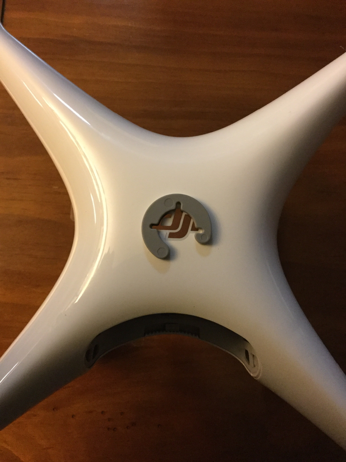

The chute sits on top of the placement stamp shown below and is not connected to gps in any way. The chute is held to sUAS by a cord.View attachment 109384

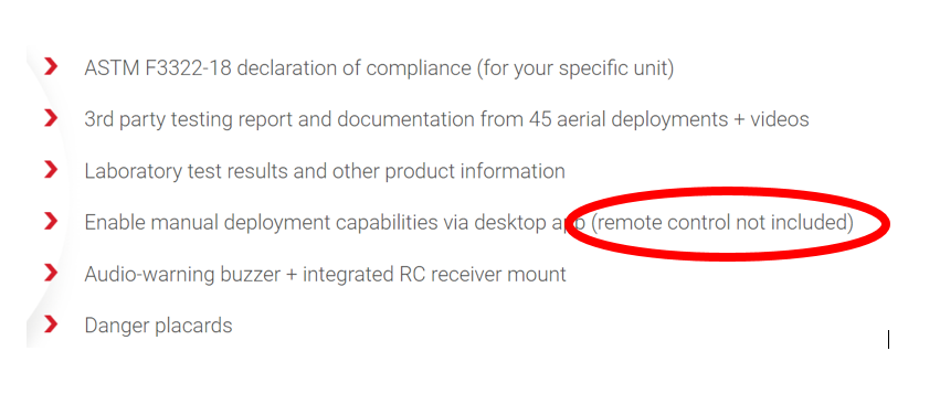

ASTM Professional Kit - ParaZero
I'm tempted but $1500 is a lot of bucks w/o knowing if the feds will give you the waiver. After a few others apply and get it I may reconsider. Wonder what remote control not included means...
I'm tempted but $1500 is a lot of bucks w/o knowing if the feds will give you the waiver. After a few others apply and get it I may reconsider. Wonder what remote control not included means...View attachment 109435
Yeah, I’m going to wait and see if others get approved. The remote is to manually deploy chute from field. It was supposed to come with the ASTM package from what they told me.
