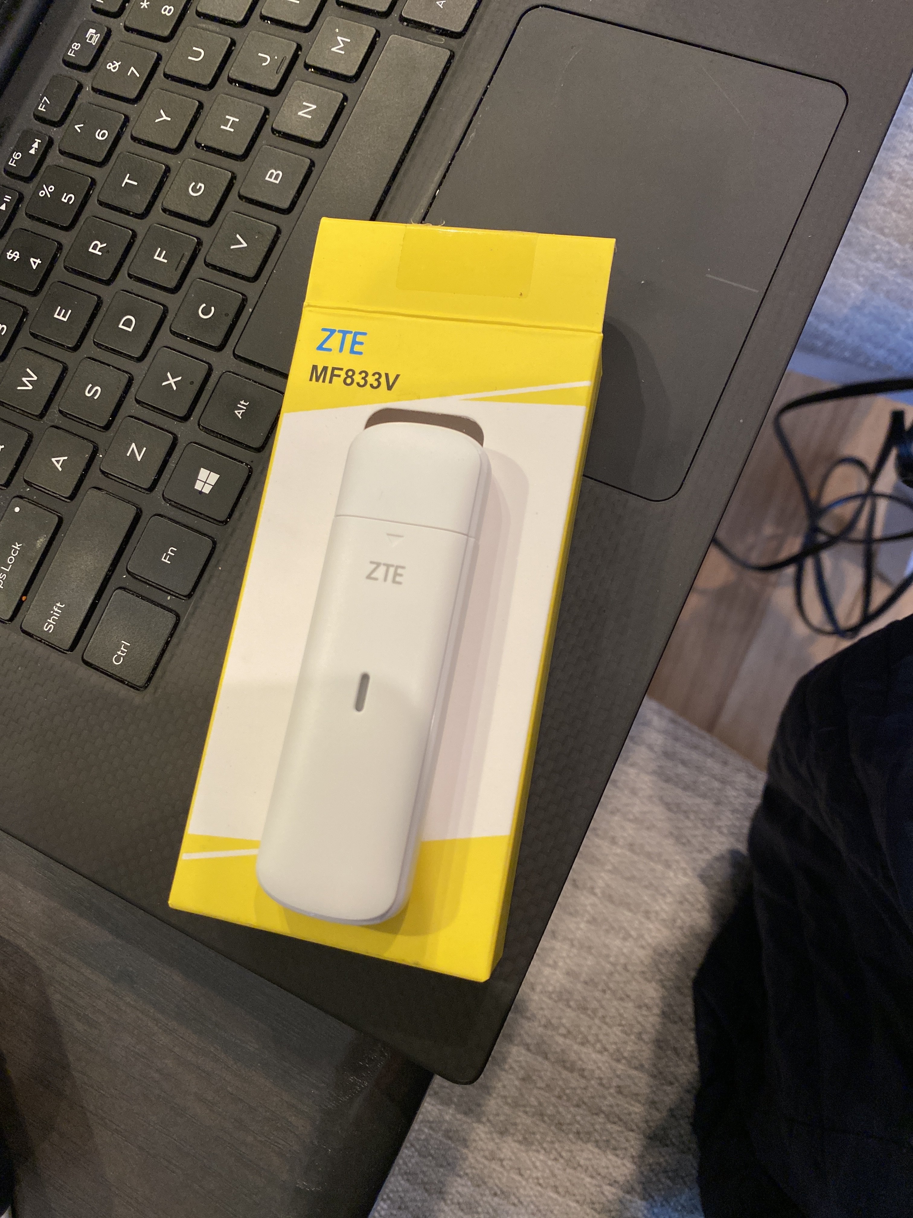

Nice! Hmmm I took the SIM card out of my wifi hotspot. I’ll go over to the att store and get a new sim. Attached is a photo of what i got from that amazon site. It has red led that goes green when it is on the network. Is yours the same?

Looks the same except when connected my light is blue. My old one was green.
I just came back from the AT&T store. He programmed a new SIM card and guess what? IT WORKS!!!!
So, what I learned.... I was trying to use a SIM card from my wifi hotspot, but AT&T won't let that work in the ZTE, because for whatever weird reason, the ZTE is classified as a phone. The new SIM fixed it.
Before, I had a red LED, and it went to green when it detected the carrier. Now, it goes from red to blue (steady at first), then blue flashing when data is being transferred..
