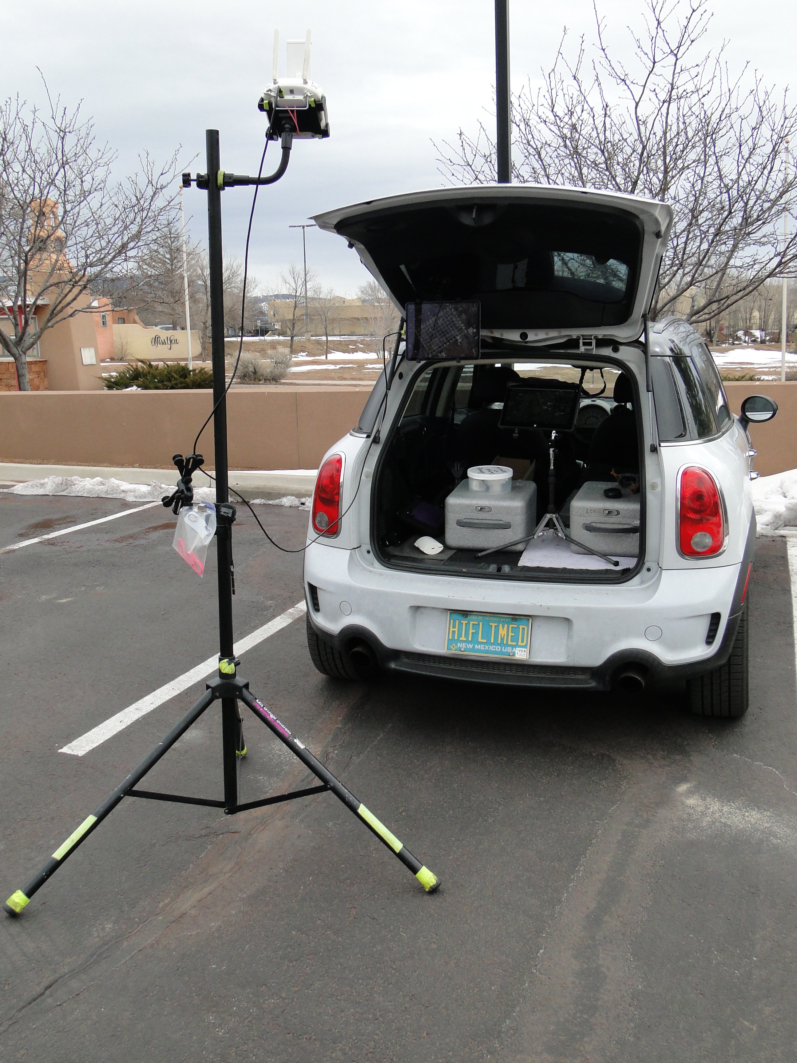

Here's the photo of the ol' Mini Cooper with all my junk set up. My telescoping RC stand has been, by far, one of my better inventions, and something I still use on every mapping job.

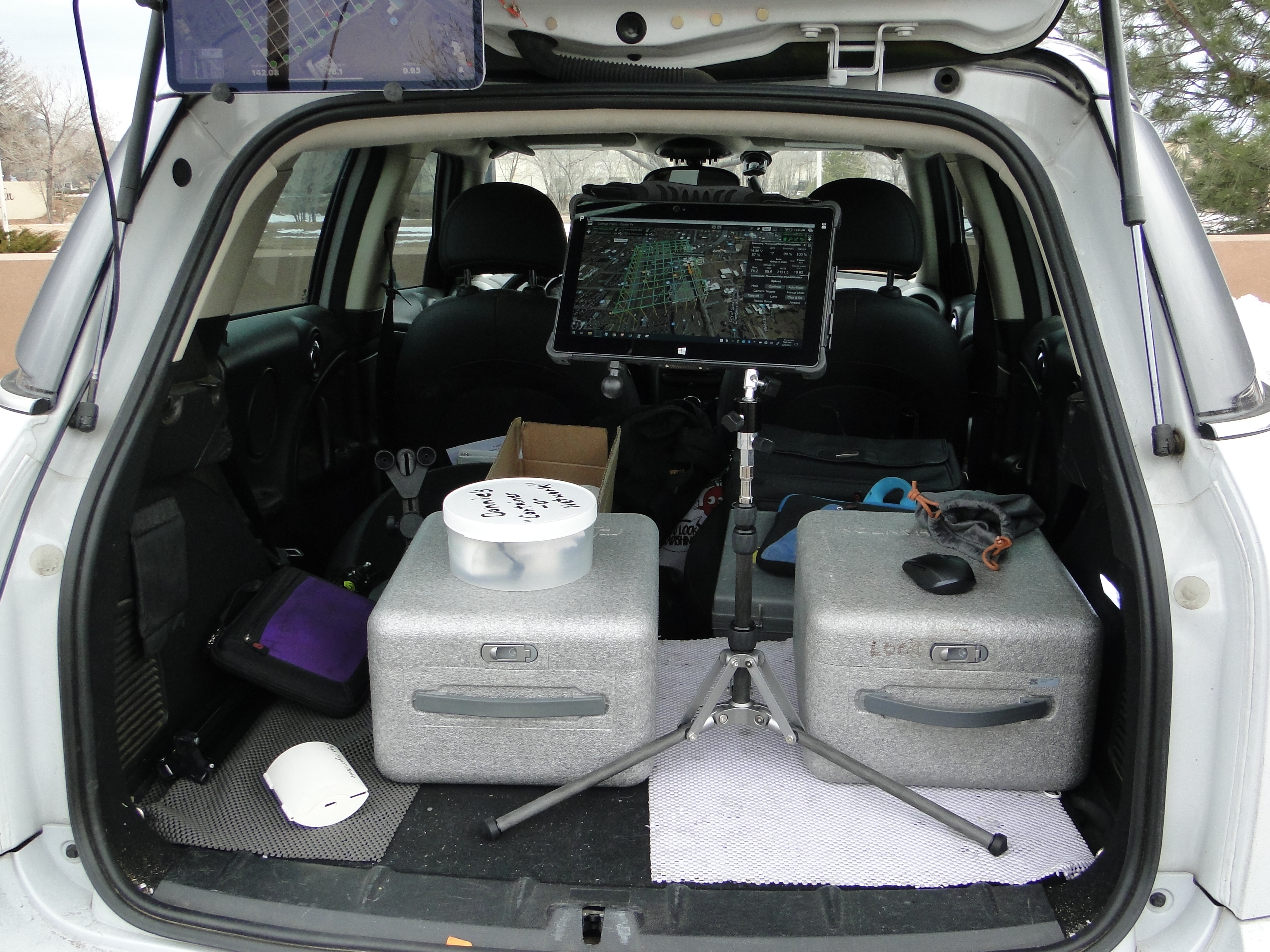

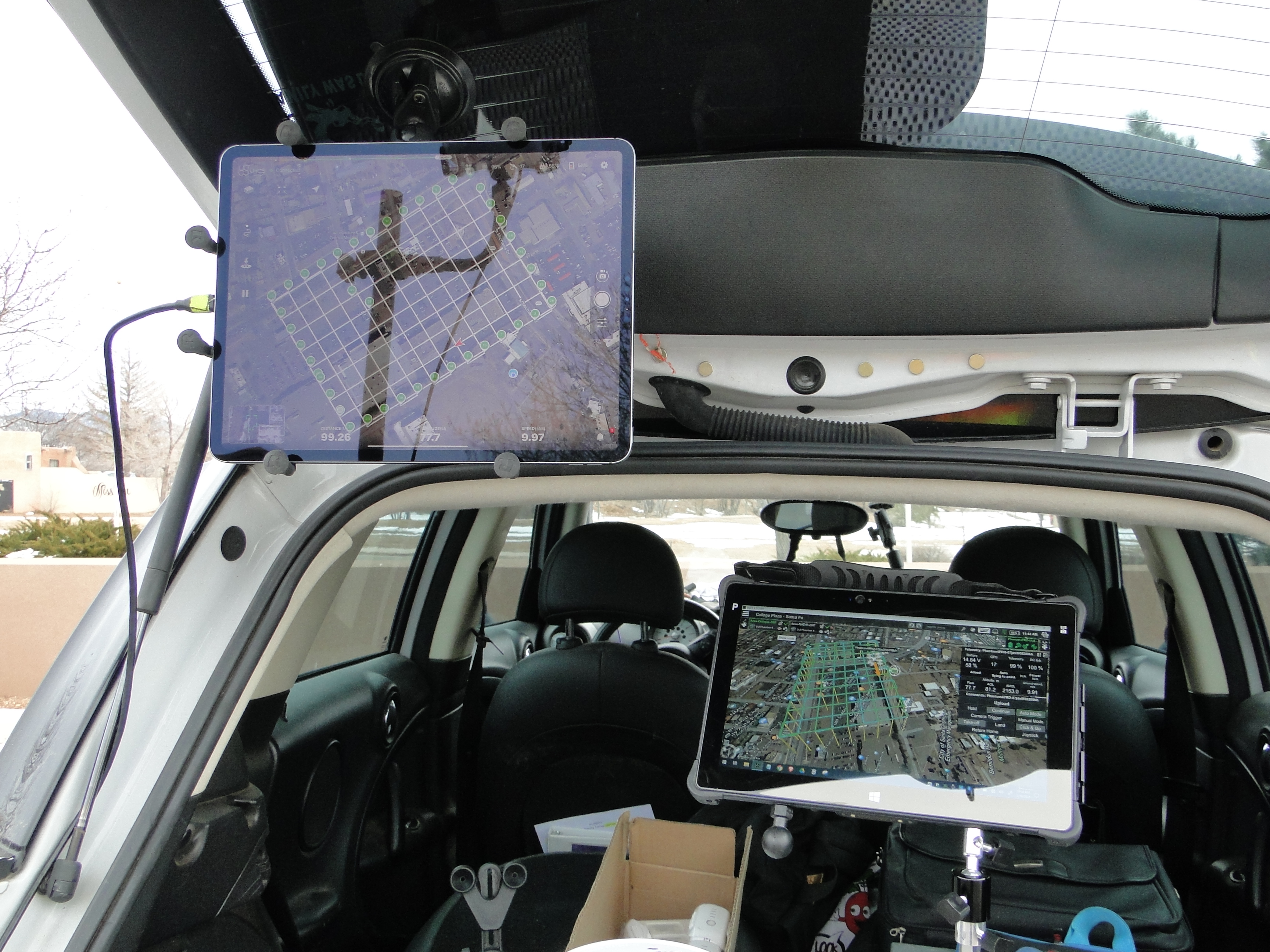

Here's a better photo of the setup inside the Mini. As you can see, I'm using both an iPad AND a Windows Tablet. Both net completely different sets of data and control.

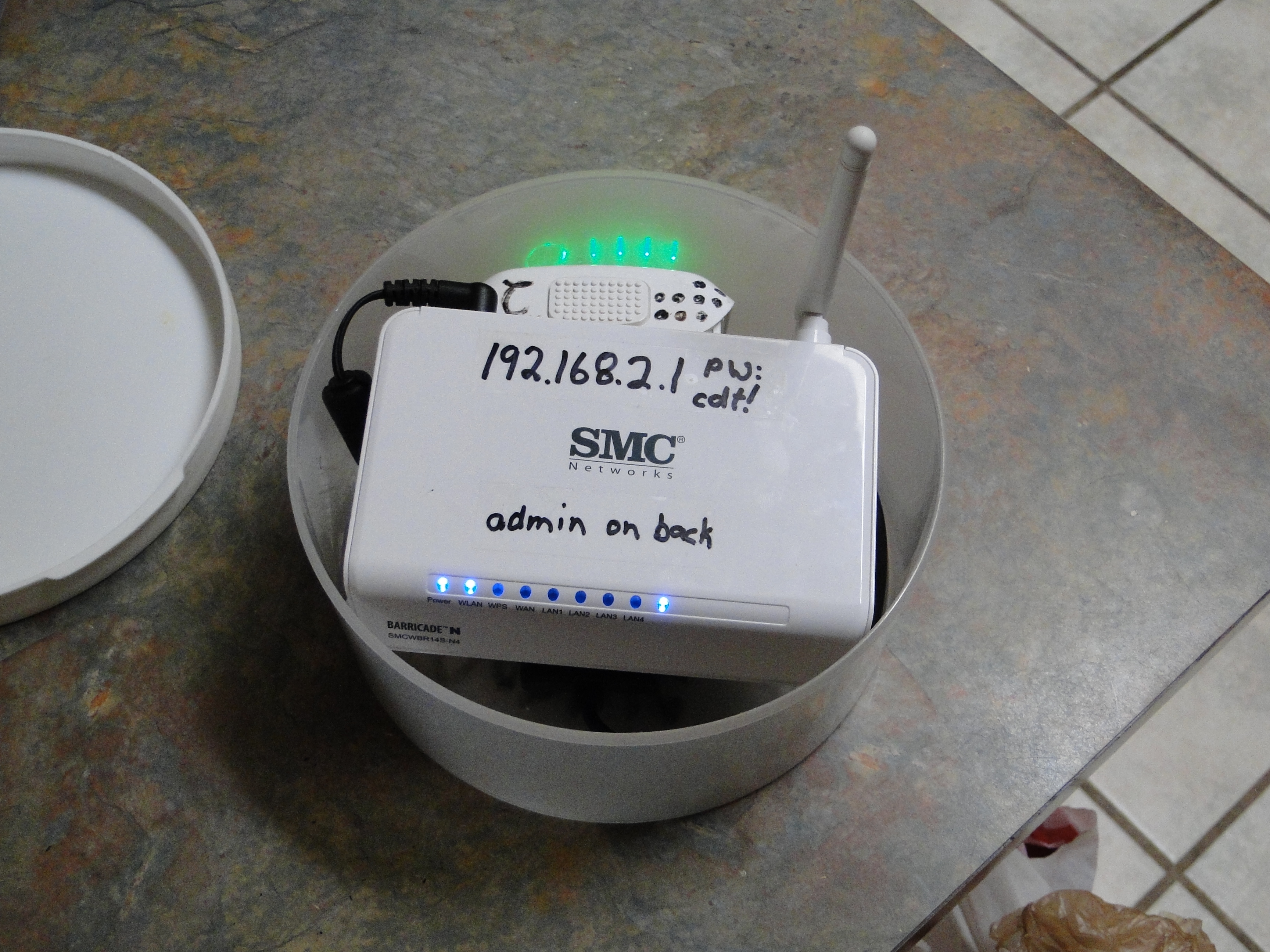

If you look closely, you can see a white, round container. This is my Local Area Network.
Here's a better photo of my homemade, mobile LAN. Yes, that's an old P4P battery with over 90 flights on it. It's too old to fly anymore, but works great for my network!
We had tried using my business partner's smart phone as a hotspot, but this proved to be sketchy and unreliable, especially if a call came in. The best part of my mobile LAN is it is robust, reliable and inherently secure because it's not connected to the Internet (no WAN). In addition, it's not connected to that security nightmare you guys call "smart phones." HA!
And while my flip phone DOES have hotspot capabilities, I have a very cheap (but reliable) 2GB data plan (grandfathered in). I don't want to eat that up when I have this free, mobile LAN I put together with all spare parts (have about a dozen wireless routers in a drawer in my computer room at my house).

All very impressive from a hobbyist's point of view. But what's with the telescoping RC stand? You might get an improved signal, but why does signal strength matter with pre-programmed flight?
Not all waypoint flights are "connectionless." Depending on what the drone is doing, some flights receive instruction from the iPad. Also, most DJI drones are limited to 99 waypoints. So if we exceed that number, the iPad becomes the controller. All that said...
It's always good to receive telemetry and video feed. While video feed isn't really necessary for mapping, for video gigs, video feed is absolutely necessary. Plus, the less time I spend "in the dark," the better. I'm sure most would agree.
The photo is of a mapping job I did Sunday.

That white round container looks to be an old wafer container from a semiconductor wafer fab.

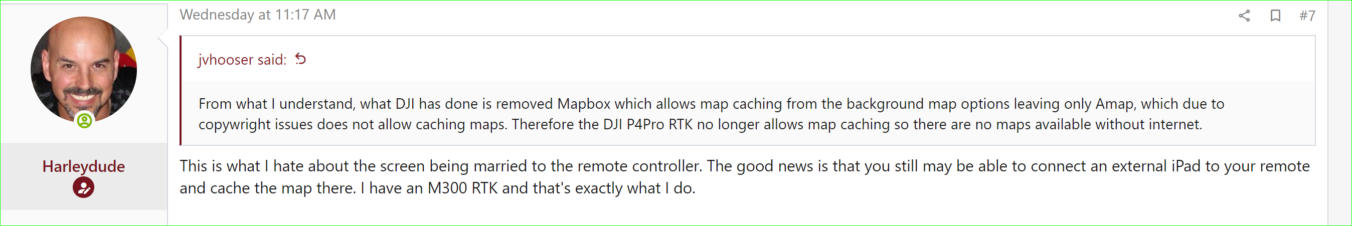

From what I understand, what DJI has done is removed Mapbox which allows map caching from the background map options leaving only Amap, which due to copywright issues does not allow caching maps. Therefore the DJI P4Pro RTK no longer allows map caching so there are no maps available without internet.
This is a critical feature to us, doing road building in undeveloped areas, and one of the reasons that we went with the DJI platform. The P4Pro RTK uses a controller with built in Android tablet with no way to add outside software that I am aware of. DJI's suggested solution of to pre-plan the mission and fly without a map which is sketchy at best.
Hey jvhooser:
I misspoke here:
I actually connect the M300 RTK to a Windows computer via a wireless network (tablet, laptop, desktop, or any combination of the three), and get telemetry data that way. However, I BELIEVE that you CAN connect an iPad to your rig and get telemetry data AND an image. But to be clear, I haven't tried it with the P4P RTK, as I don't own one. I DO, however, connect an iPad to my P4P.
You should TRY connecting an iPad to your P4P RTK rig and see if you do get telemetry data and image data. I'd be curious to know if it works.
