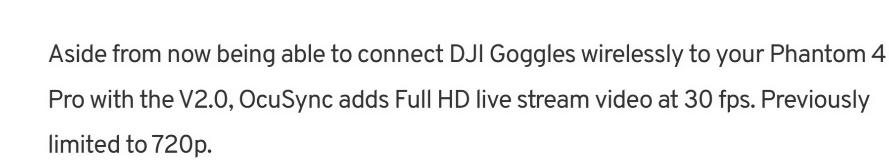

You CAN connect the goggles wirelessly to a V2.0 - which you have.
If your goggles don't show 'Phantom 4 Pro V2.0' as an option in the linking settings (they should), all I can think of is that their firmware may be pre V2.0. You can upgrade the firmware with 'DJI Assistant 2 (DJI FPV series)'.
If you succeed in updating the firmware and can see the P4P V2.0 option in the linking section, in addition to the steps you mentioned above, you need to be prepared to press the linking button on the drone (use a small piece of wire or similar). Once you've initiated the linking via the goggles, you get sixty seconds (I think) to press the linking button - which you need to hold down for a second or two. The linking button will flash when engaged, and it should take less than10 seconds after that for the goggles to connect.
