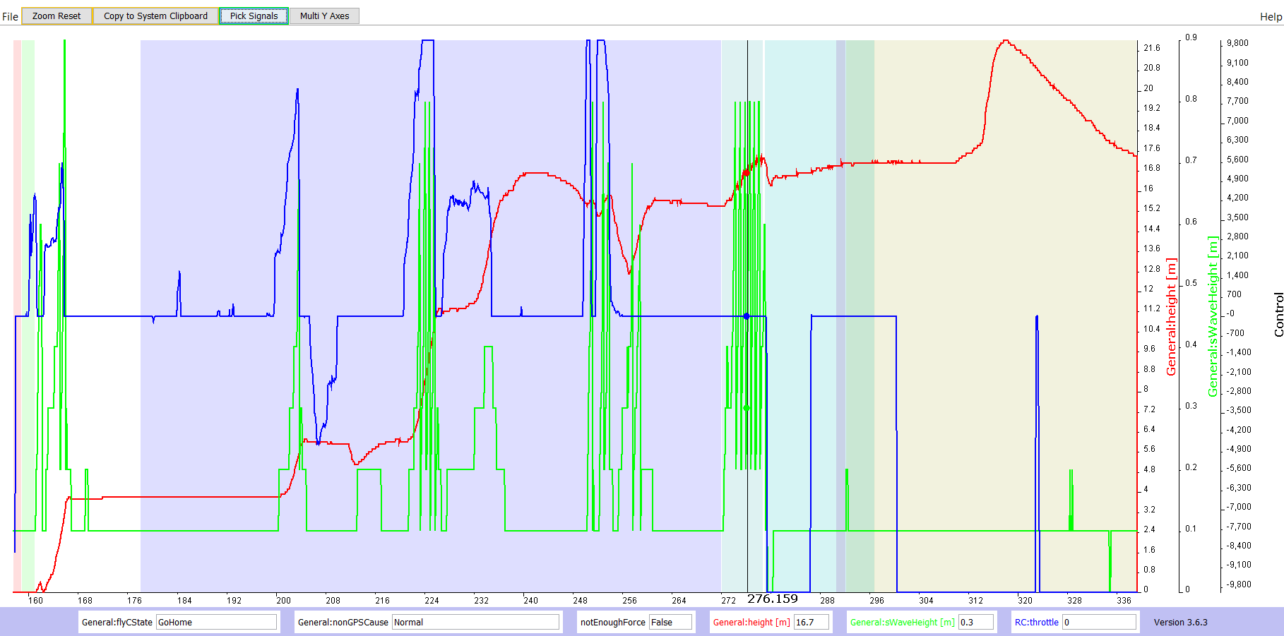

I know it was up around 250' or more, but It may not have known it to record that.

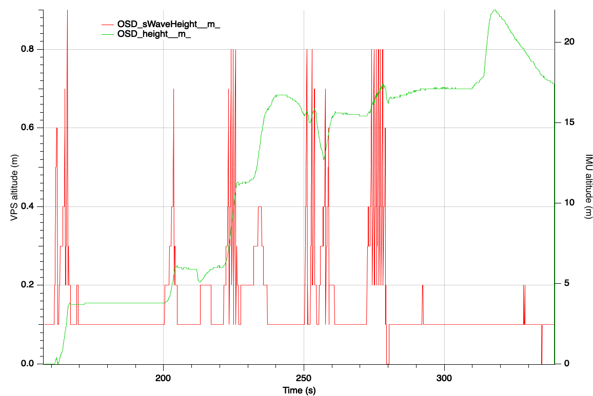

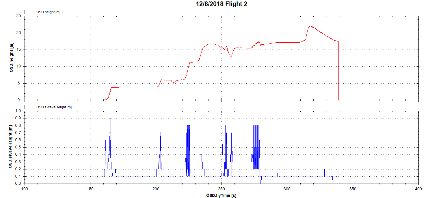

Below is the similar graph of the second flight. The max altitude in both of these is approx 70Ft. This second flight also exhibits the VPS not reporting correctly as does the first one. I have seen this very similar thing before and have to ask you one question. Before these two flights, did you add a gimbal guard or anything else underneath the aircraft, which can block the VPS sensors, since the first flight you posted seemed to be fine in that regard. The data does look a bit odd as Sar104 mentioned above, however for the interim, it still looks like the VPS sensors are blocked.

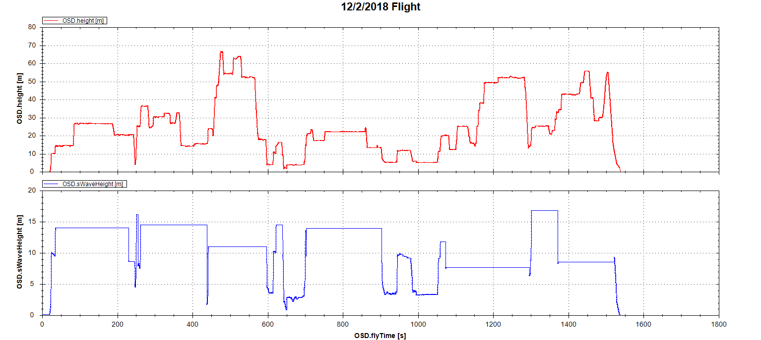

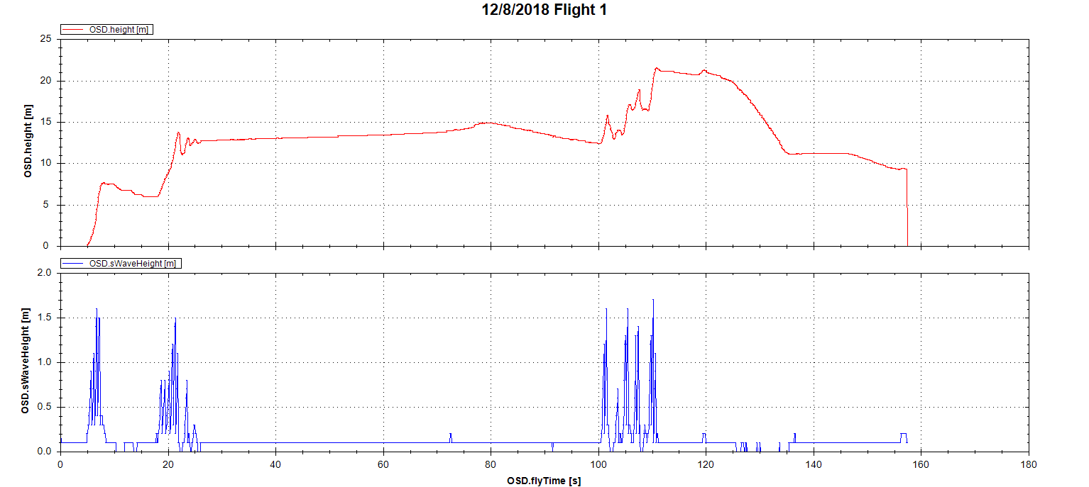

Below show the barometer altitude and the VPS altitude from all 3 flights. The difference from the first one, dated 12/2/2018 and the last 2 are pretty obvious. This is why I asked the question regarding the gimbal guard.

That's a good point - it could be the VPS sensor causing the problem. The VPS altitude remained below 1 m for the entire flight, and will have been inconsistent with the barometric and IMU data. The IMU clearly didn't completely trust the VPS since it shows the altitude going up to 22 m, but the conflict may have led to the other problems.
