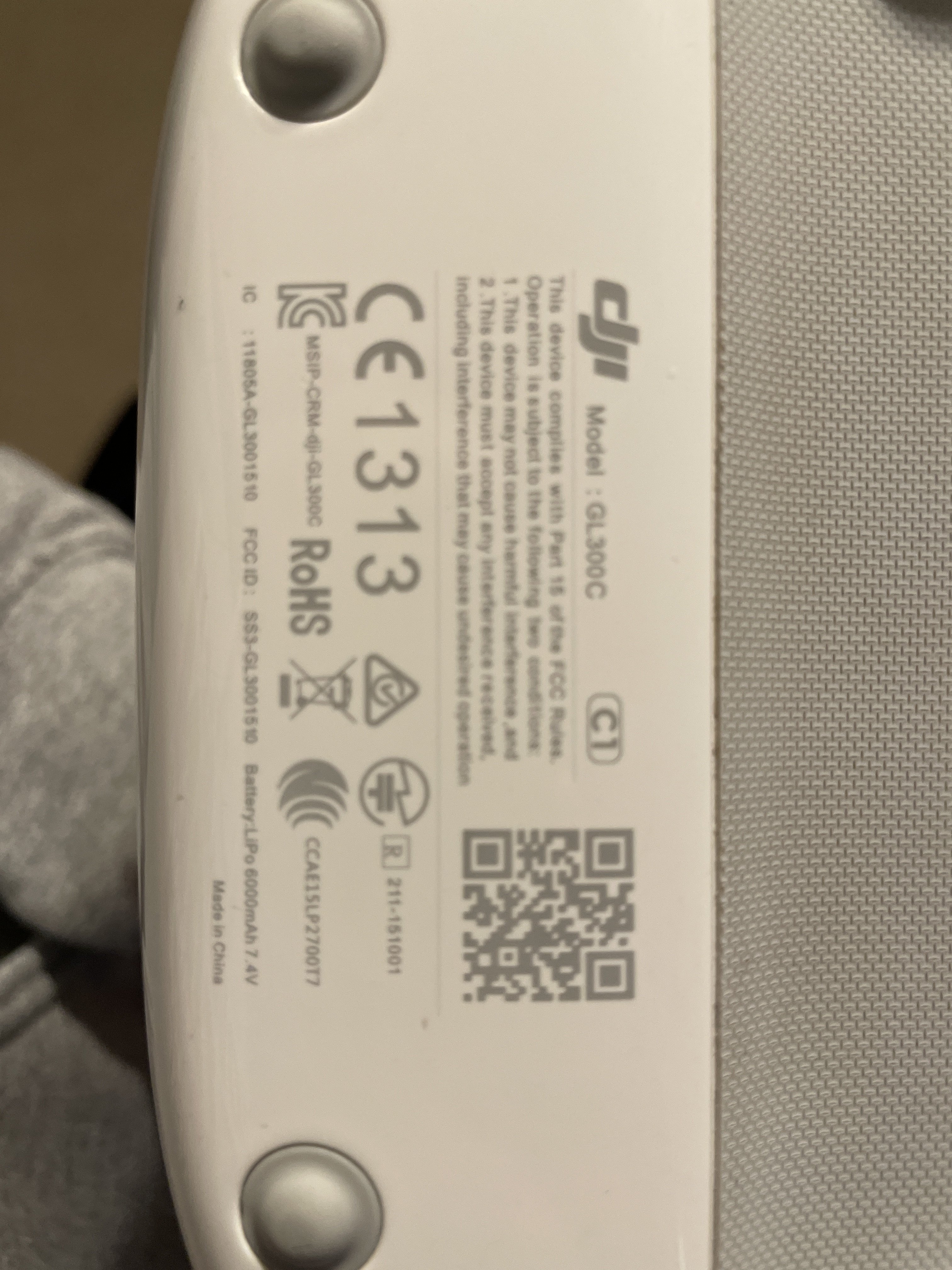

So I have a P4P+ drone and controller and I wanted a new controller but without the built in screen. I was looking around and saw that the GL300C version B was compatible. The difference between the GL300C and GL300C version b is the flight control modes are P-S-A on the version B. I went ahead and bought a used one on Ebay that looked like it was in good condition and Confirmed that the flight modes were P-S-A. When I connected the new controller to my phone and turned on the drone I pressed the remote control linking button in the app then I pressed the linking button on the drone. No beeps or anything from the drone. tried multiple times nothing happend. Power cycled everything nothing happend. I help the three bars in the upper right hand corner of the app and updated the controller firmware. Tried connecting again nothing happend. Is there a way that I have to disconnect the Pro Plus controller first before I can connect the new one? Also when I have my phone connected and the controller is on it shows up as Phantom 4 and not Phantom 4 pro.

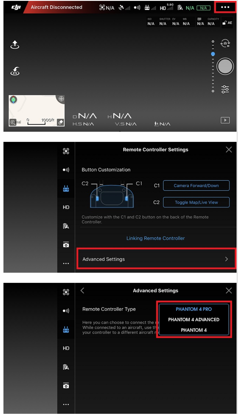

Have you set the RC type?
Screen shots from Mike S:

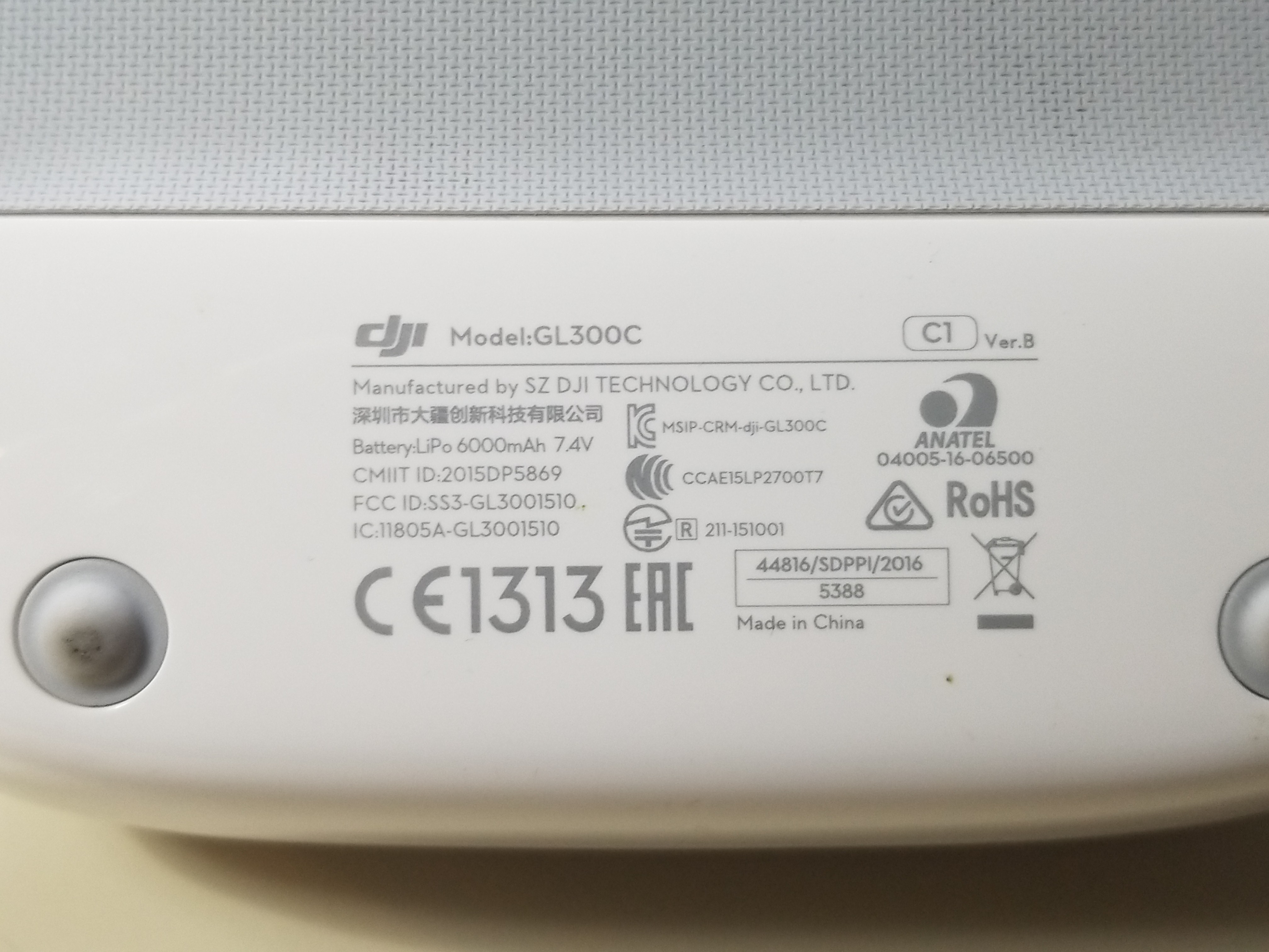

Does the one you purchased have this (Ver B.) on the back?

I was looking around and saw that the GL300C version B was compatible. I went ahead and bought a used one on Ebay.
When you said you bought a 300C Ver.B, I assumed you actually had a 300C Ver.B. Sorry to assume and not verify first. 😉
