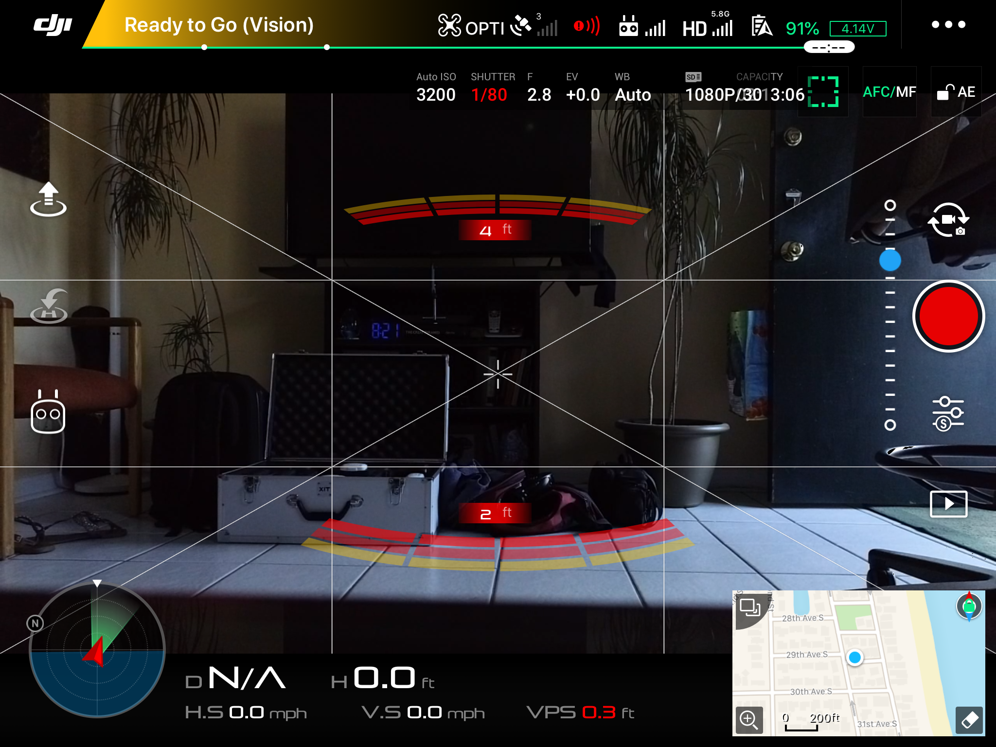

What does it mean when the shutter speed indicator turns red as at the top of the attached photo (1/80)? Settings are set to shutter priority and I can change the shutter setting and the indicator turns white again. But what is it telling us when it turns red? It sometimes also changes colors when the scene's lighting changes. Appreciate anyone's insight.

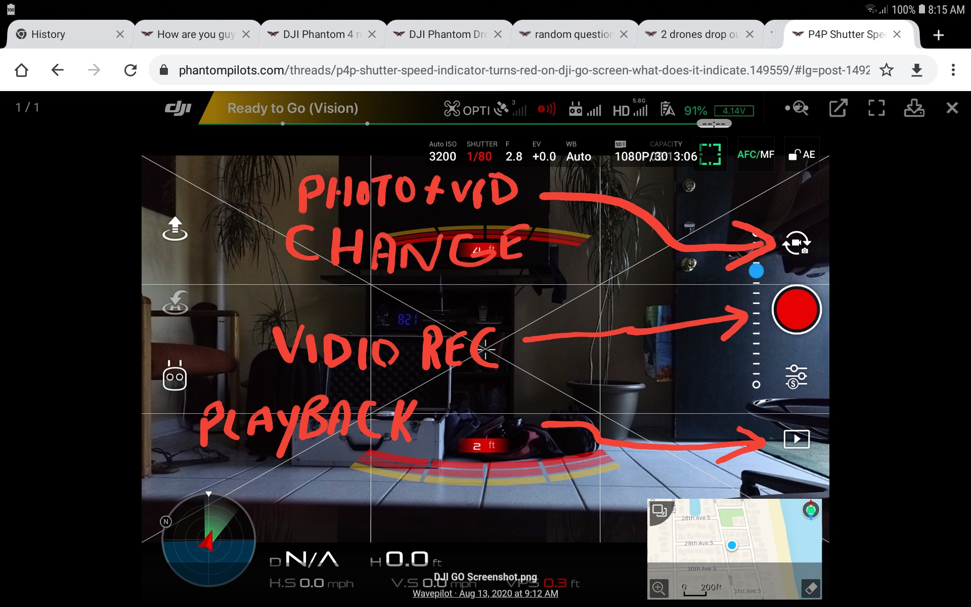

To my knowledge the red is ready to record video when pressed,the small white cam button with arrow above that red circle will change mode back to photo,its just indercating that recording instead of photo ,,

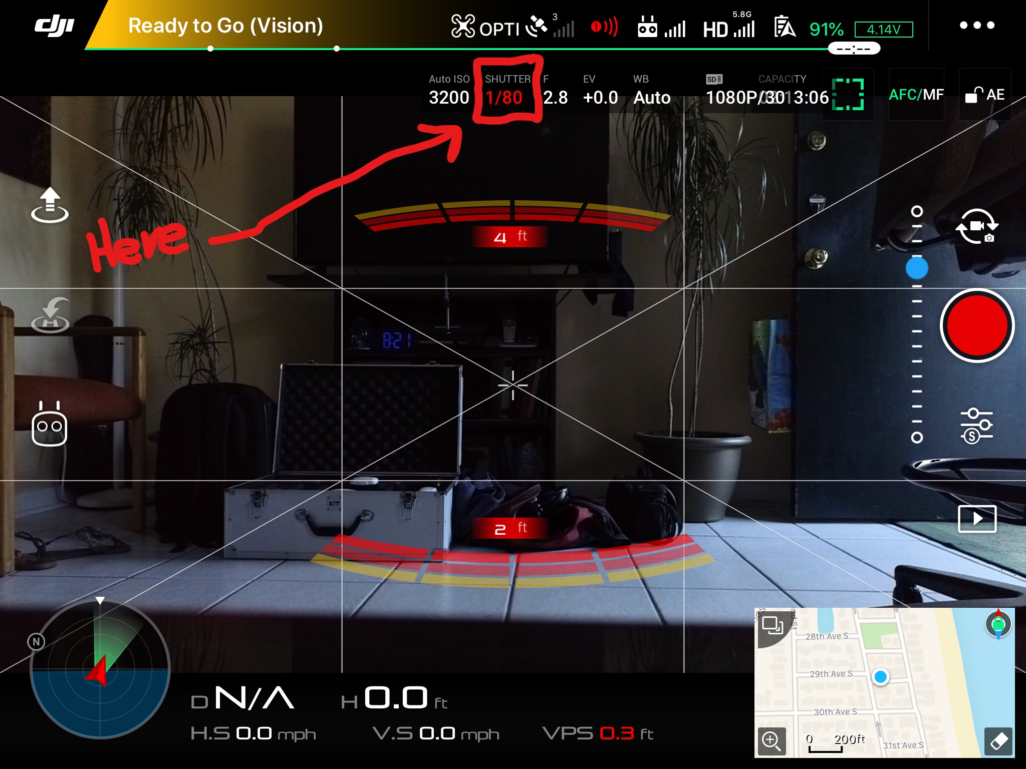

Thanks, but I'm asking about the red shutter speed highlighted on the photo below. Red usually means warning. What is it warning us of - too fast, too slow?

In your case it's warning you of massive "over exposure" as the 1/80 shutter speed is too slow to match the 3200 iso and F2.8 aperture.
If you increase the shutter speed this should reduce the over exposure

The red appears to warn you that the exposition is not within the normal ranges for the environment which you are filming.
If you switch to the aperture priority then the red coloured numbers will appear at the aperture values.
