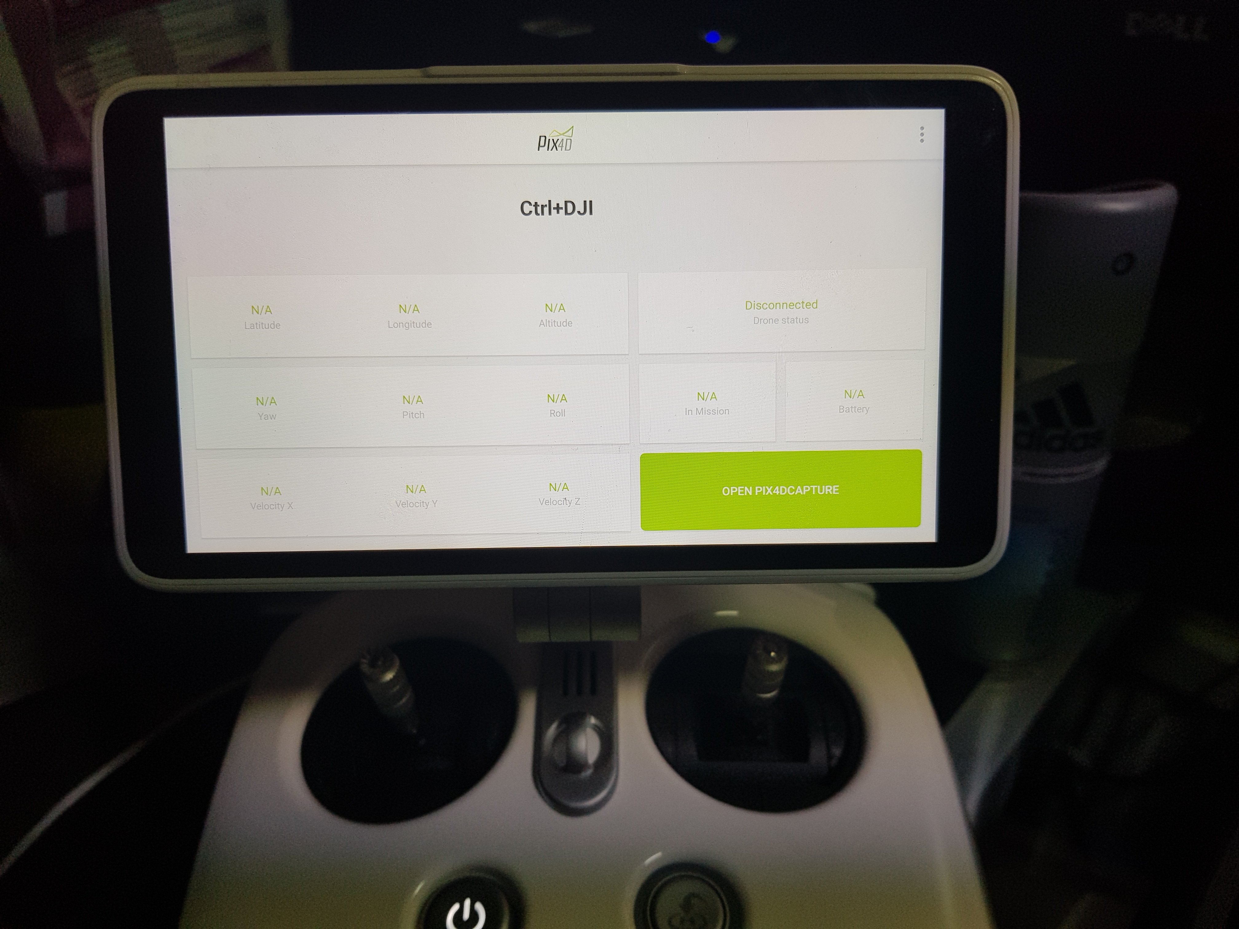

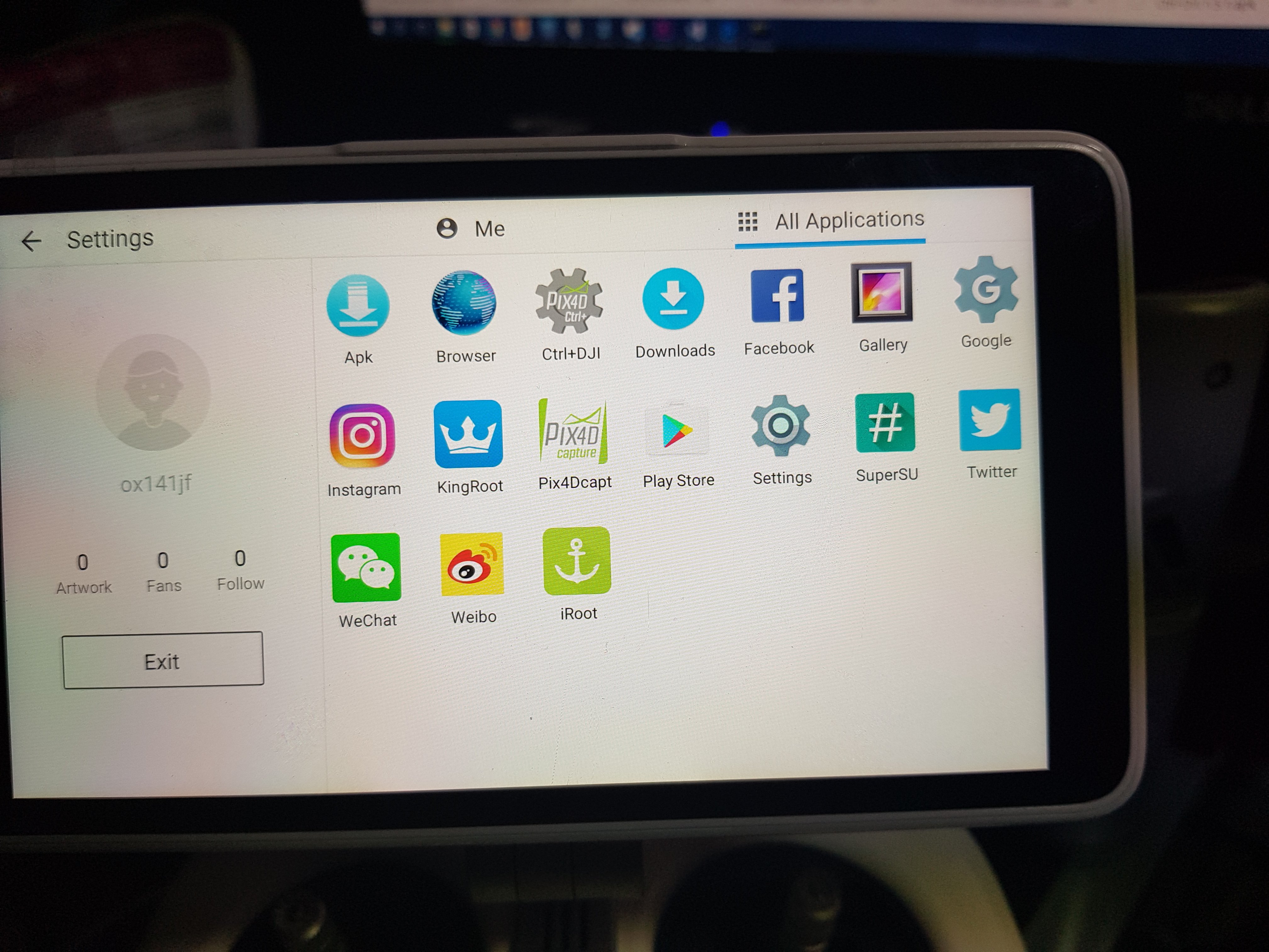

So i have been trying for HOURS to install anything of worth on here and this is the result:
You can use kingroot to root the device after turning on developer mode like you do with any android device.
You cannot install google play and have it work due to the restrictions on the device.
You can install any app such as DroneDeploy or Pix4D but because the controller does not host the drone the same way a normal controller does, it wont connect and as such will not actually work.
Aside from that normal apps work, youtube, facebook etc, but what use are those really?
soo all in all dji strikes again!
Images below:
