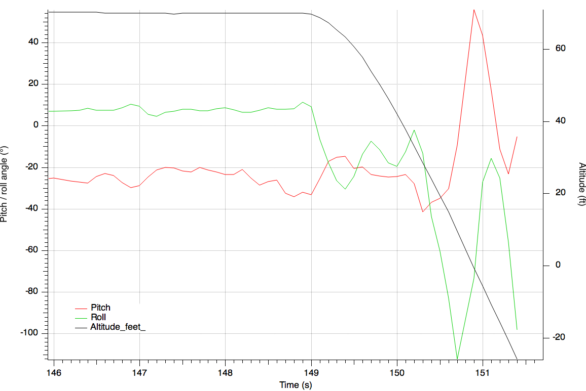

From the log file it appears that it was likely prop failure.
The aircraft is flying south in a crosswind of 15 - 20 mph from the west, hence the positive roll values. At 149 seconds it rolls left, pitches back and enters a tumbling fall at close to free fall acceleration. That suggests it lost the rear left prop.
Yes I think that is very close...it was one of the black marked props so either the left front (which I believe it is) or the right rear. If you watch the video I think you will agree with the left front...See if I can find it on you tube now. I labeled it P4P Plus hits the dirt.
OK - well front left is actually more consistent with the resulting positive yaw, but I'm not sure why it pitched up in that situation. Still need the DAT file to explain that.

However the .txt file is enough to eliminate some things.
Here's what your data looks like: DJI Flight Log Viewer - PhantomHelp.com
It shows that you launched with a less than fully charged battery which can cause trouble.
But in this case it doesn't appear to be responsible.
At the time things started to go wrong, 2:29.1, the battery was reporting 14.47V which is well over the critical level of 3.3V.
The data also shows the Phantom spinning and tumbling under power as it fell.
This does not contradict the suggested cause of a broken prop.
If you could find the missing part of the prop, perhaps it might have some evidence to determine why it broke?
