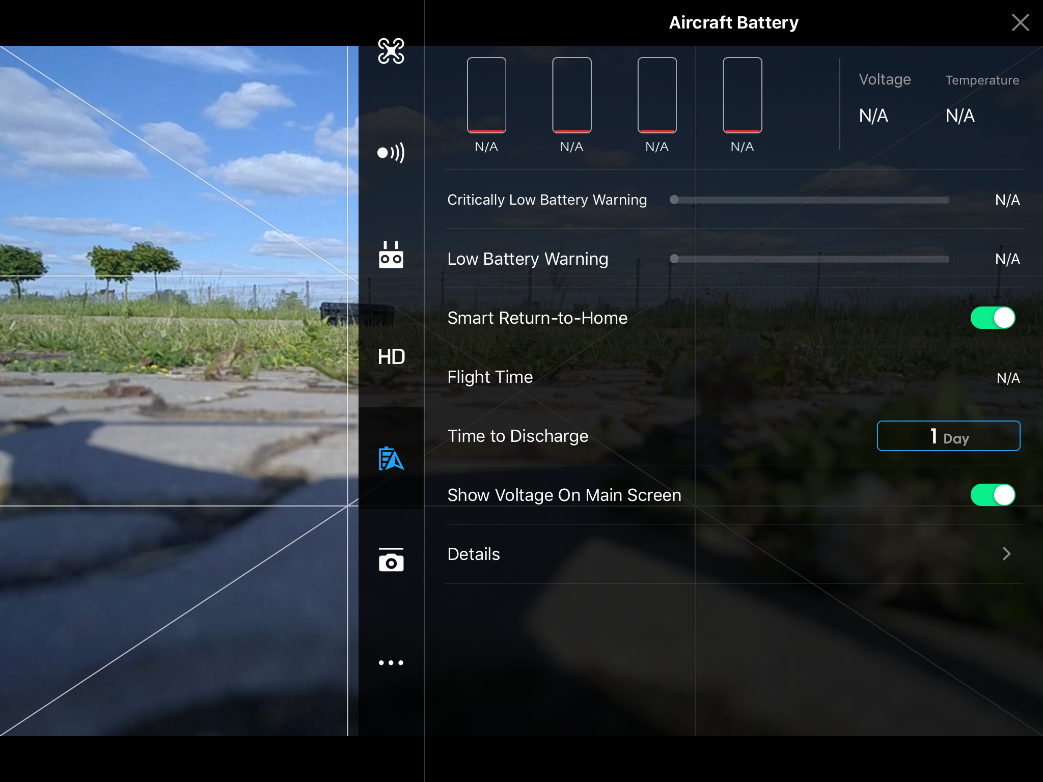

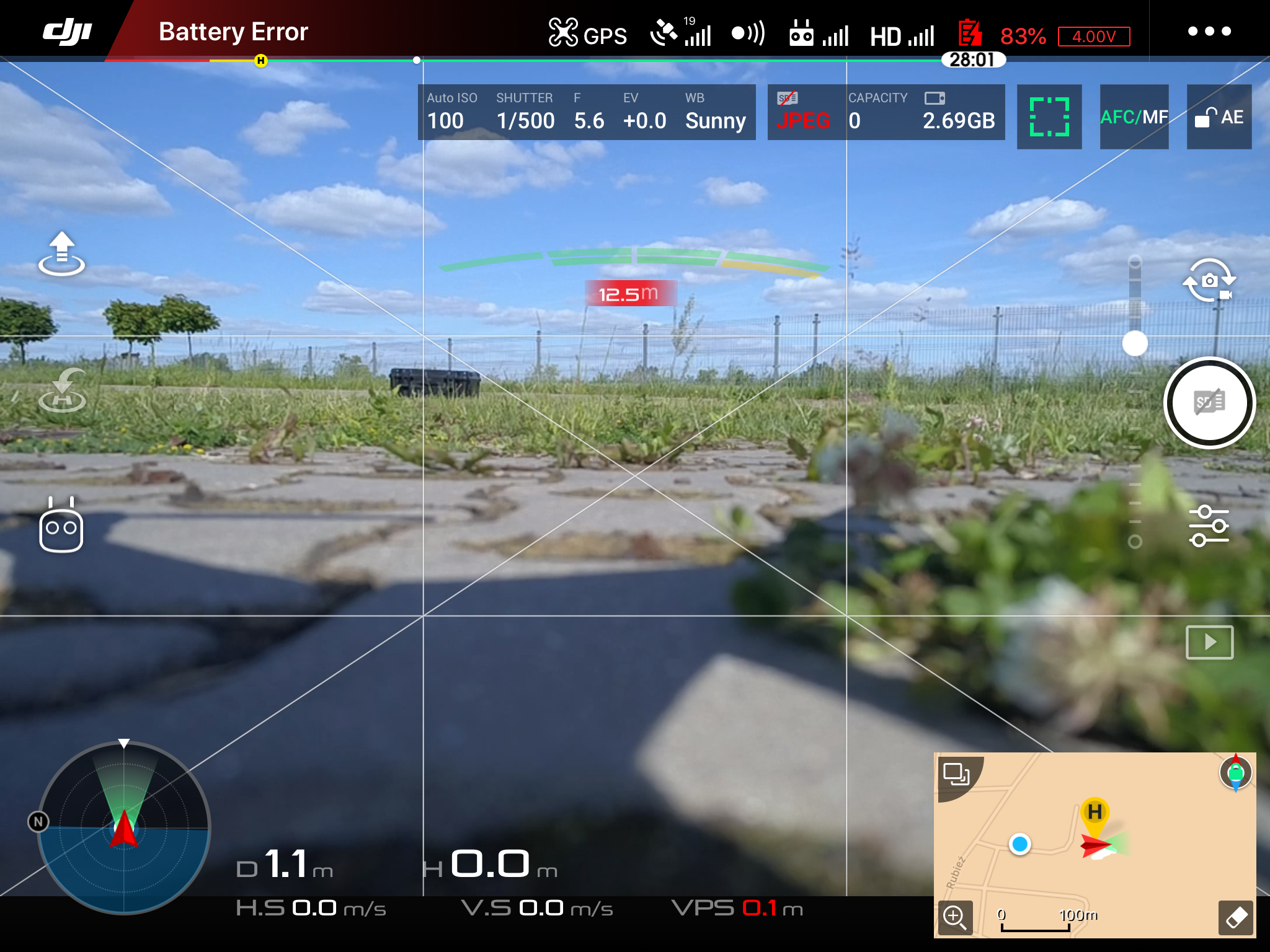

I carefully watched my P4A today, and I might have found the issue. I started getting battery error during the flight and no cell detail is shown, then it goes back to normal (and again and again).
Double checked with different batteries, all fully charged and all cells balanced.
Flight with no interruptions, but right now I won’t risk taking off to avoid looking for phantom in the bushes.
What might’ve caused this? I’ve gotta admit that maybe once or twice the battery was removed without turning off (not my fault, but person who was flying at the time), and inside the drone I can see silver spots where it touches the battery (unfortunately don’t have any photos).
