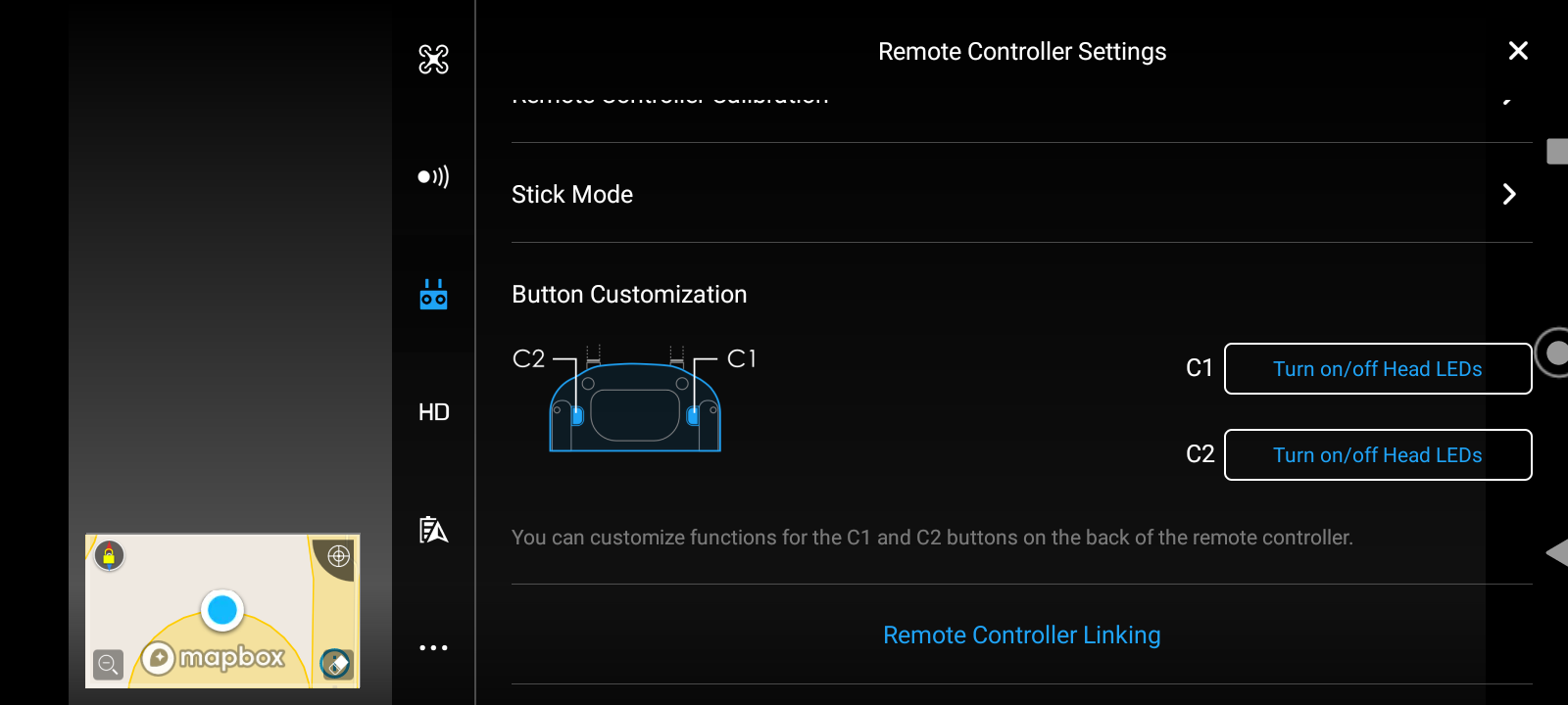

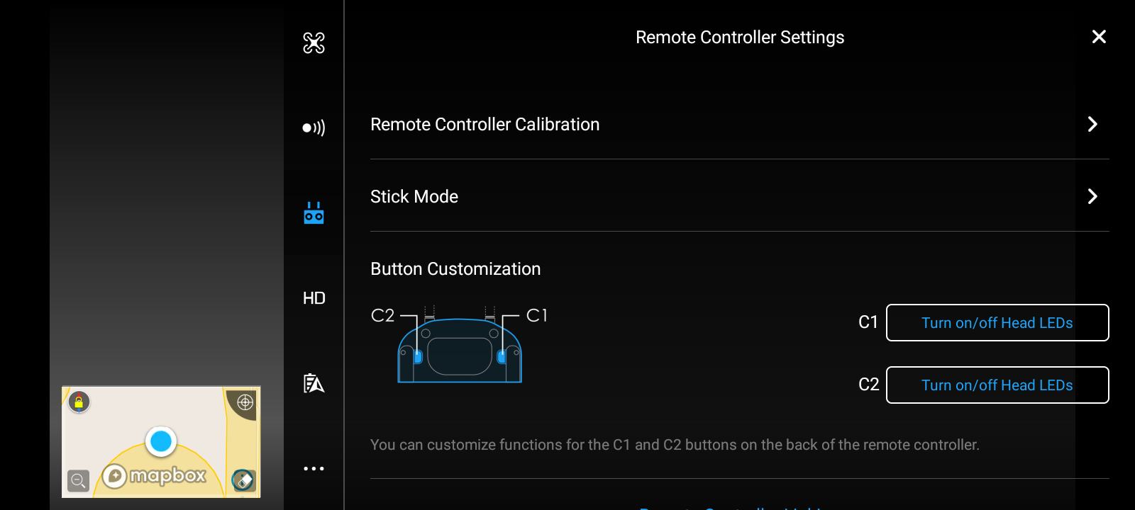

I have no advanced settings option in that menu. Any ideas?
Perhaps you haven’t scrolled down enough?
The screens should look something like these:
Nope, I don't have the bottom menu option. Probably my whole problem, but I haven't the foggiest idea how to get it. I bottom out on the linking menu, which of course, doesn't link.

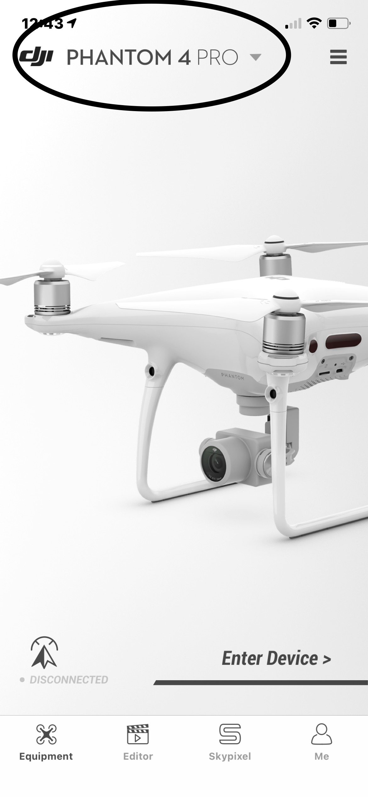

When the Go app first boots up, there should be a drop down menu at the top of the screen. you should be able to pick a drone model from there.
I got that, but as soon as I connect the RC, it automatically goes to Phantom 4 pro

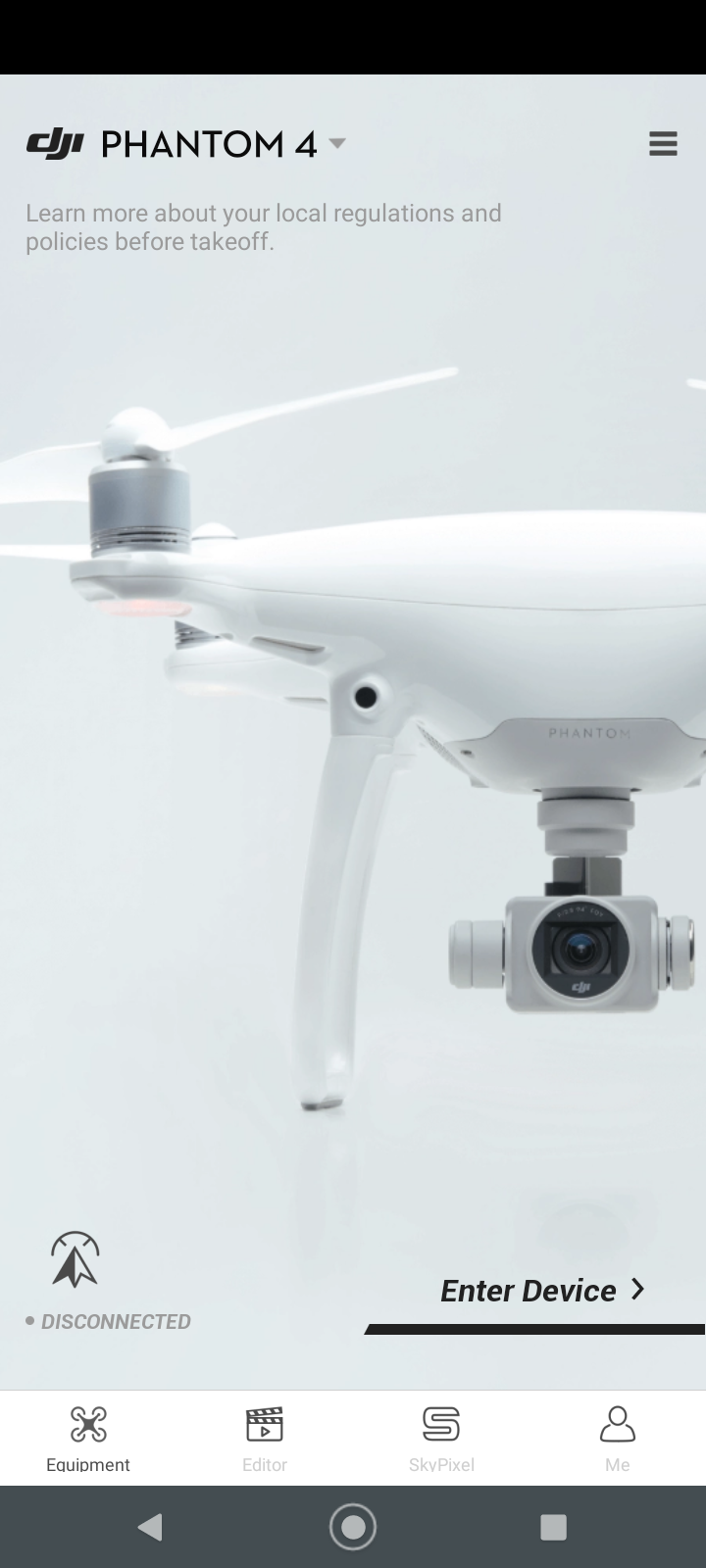

Hey OSO, whish version of DJI GO4 are you using? Perhaps there's an older version that may work for me with that menu included?

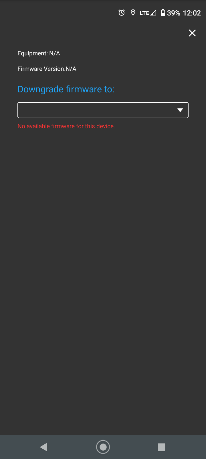

See, I can select the P4 standard, but it doesn't show any firmware for it in the menu.

That's my other problem Salad shooter, DJI assistant on my PC won't allow me to update the 300F. The only allowable updates are through GO4.
This is bizarre, if they didn't support the device, why would they include a menu for it??
The P4 / GL300F combo definitely works. It took me awhile to get it up and running. That blank screen you are showing isn't because it doesn't have the firmware, its because the drone isn't connected
Here is my final couple of thoughts and you have probably already tried them: Connect the controller and phone. With the controller on allow it to boot the DJI Go 4 app into the Phantom 4 Pro profile... then look at the bottom of the RC settings screen that OSO put up to see if the controller has to be connected for the option to change Phantom models to appear.
Second try updating the GL300F from the About menu in settings. Other than that I am out of ideas.
There is a way to hard reset the controller also but from reading through the forums this hasn't helped.
Ok, I tried your suggestions. Resetting the controller produced results, just not the desired ones. ? It now thinks it's an inspire 1. ??? This poor controller is just as confused as I am. But the lack of firmware I believe is the problem. I'm betting no firmware equals no connectivity. I reckon I'll probably have to wait around on DJI to come up with the fix?

Ok fellows, the problem is solved!!! OSO wins the prize! DJI GO4 doesn't have app version 4.3.42 available on the Google play store. This is the version with the menu he showed me. I changed versions. the menu pops up, firmware downloads, and we're linked and in business! THANK EACH AND EVERY one of you for your help and patience on this issue, it is tremendously appreciated!
