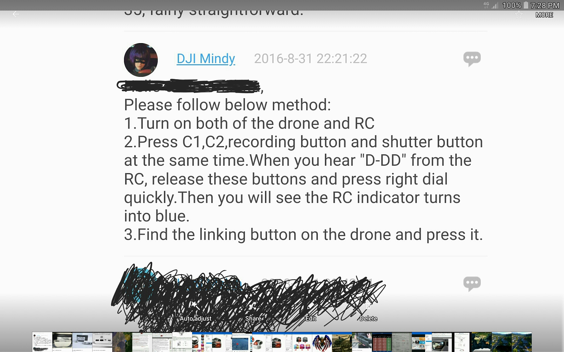

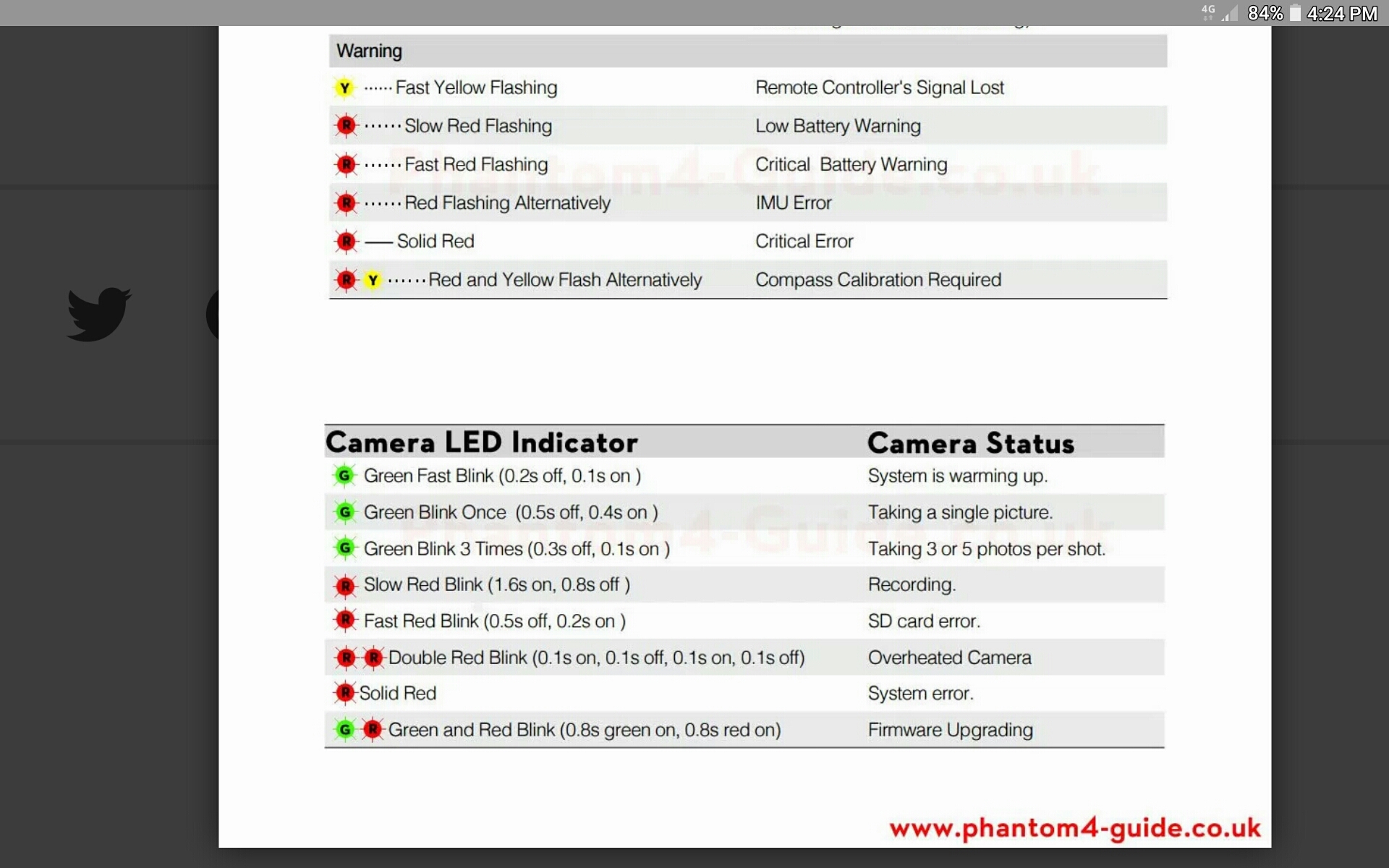

Did you try gimble calibration,any change?what colour you gimble light ?mayby try this manual relinking
,Here's a camera light chart aswell,bit unsure at moment of green screen till it paired properly,that could be transmission channel selection
Did you try gimble calibration,any change?what colour you gimble light ?mayby try this manual relinkingView attachment 100967 ,Here's a camera light chart aswell,bit unsure at moment of green screen till it paired properly,that could be transmission channel selectionView attachment 100968

Thanks for your suggestions. I tried the gimbal calibration and it was fine and the RC obviously is talking to the drone. The gimbal light is fixed/solid green as it should be. I did another RC link and noted the blue light comes on and flashes during the linking process for the RC with the usual beeps. At the same time I noted the gimbal light changes from solid green to orange and flashes. Then I press the link button and it changes to solid green as it should. The only light that does not show is the green status light on the RC. Also when I turn off the drone the RC status light comes on solid red as it should, so all in all the only real problem is the missing green light.
I also tried your suggested manual relinking method but could not get the beeps or the process to commence. (I tried a few times)

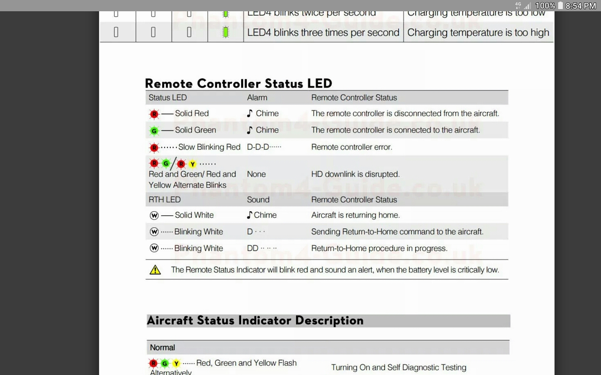

Here's a remote light chart,,yes few funny light patterns around,had a search all I could find .2 posts with good result,,one say rc calibration worked and one say unplug rc battery and it worked,,if it work for you choice,,if I find something else I post it
,,,,,,,it's not beeping when red ,did the remote get update ok,I don't think it's a firmware issue,is your wifi off,could be conflicting with usb

What happens when you turn the phantom off with the RC still on, do you get a red LED light? if not something is a miss..could be a loose wire connection inside the remote.
Hi Alan, Thanks for your reply to this unusual situation. Yes the RC status light immediately comes on red when the aircraft is powered down. I did know that from before when I was working through all the possibilities but forgot to mention it in the thread but thanks for raising it in case somebody else thinks to ask.
