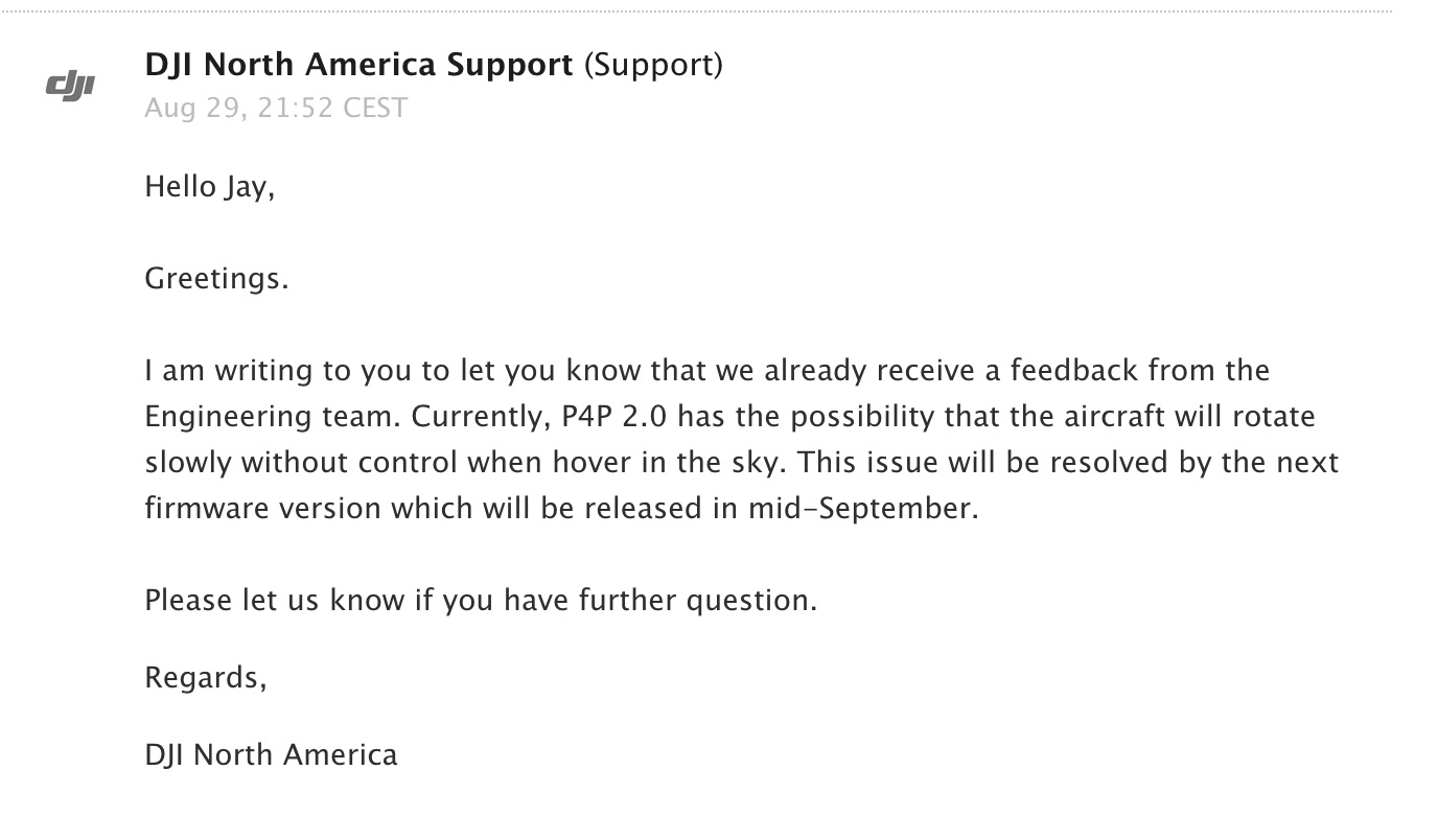

I received a response from DJI Support in regards to my issue.
At least they are working on it.
Good news
Paul C
A firmware update for the P4 Pro V2.0 was released today. I updated my aircraft and very happy to report that the issue of unsteady hover and not maintaining heading has been corrected. I flew 4 batteries and tested everything I could and the aircraft flies perfectly now!

All I know is now it hovers perfectly and keeps the heading right where it's set to be. I ran the Litchi Waypoint mission I used to test it back in August and it now keeps on the POI. I had a ticket opened with DJI Support. Could they have targeted the update to just the ones that had a ticket open for this issue? I don't know.
