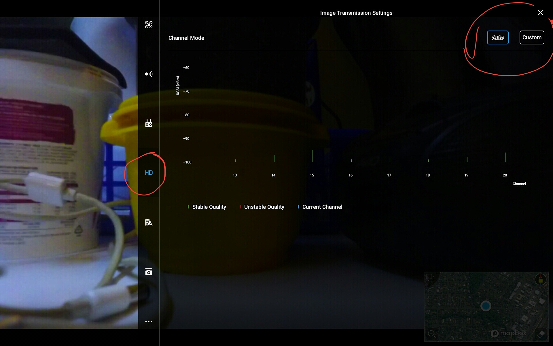

Hi guys. I have a P4 that seems to be having issues with video transmission. The drone appears to function correctly other than this. The channels all show poor signal or high interference. I have tried several devices and also down graded and upgraded firmware on the controller and the drone, as well as dji go app and litchi. All with the same issue.
Where else should I be looking??

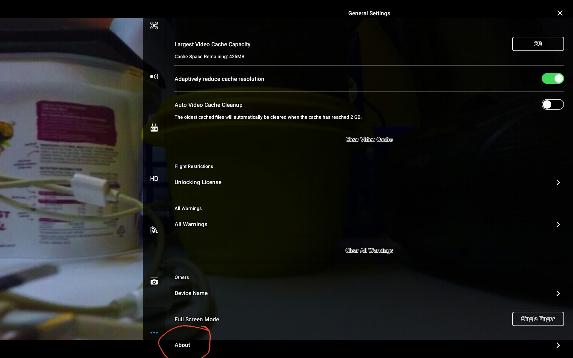

Give relinking a try,,,30 min ago I update brand new p4s remote which was on firmware 1.6.0 and had exactly same screen as you got now,nothing I tryed worked untill I just upgrade to 1.9.3 on remote,,nows it's perfect,,,what firmware you using,,,in settings it says ABOUT at bottom it show what you got there

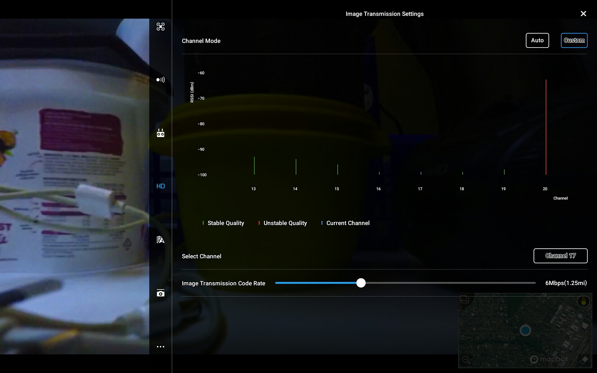

It certainly seems like it matches all the posts I have read about firm ware issues. Hopefully thats all. When I check the HD channel screen the channels are dancing all over the place in red, it just keeps cycling through all the channels. That made me wonder if there was an antenna issue, or bad connection somewhere. I will try the firmware again and see how that works.

Tried a different USB cable as you have already changed devices? Have you fitted the hdmi port to the controller. If so, you need to upgrade to 1.9.3 to get both goggles and device to work together. Another thing may be moving to a custom channel and dropping your transmission rate to 4 mbps. It will be less work for your device and you will get a better ‘vision’ on your device.

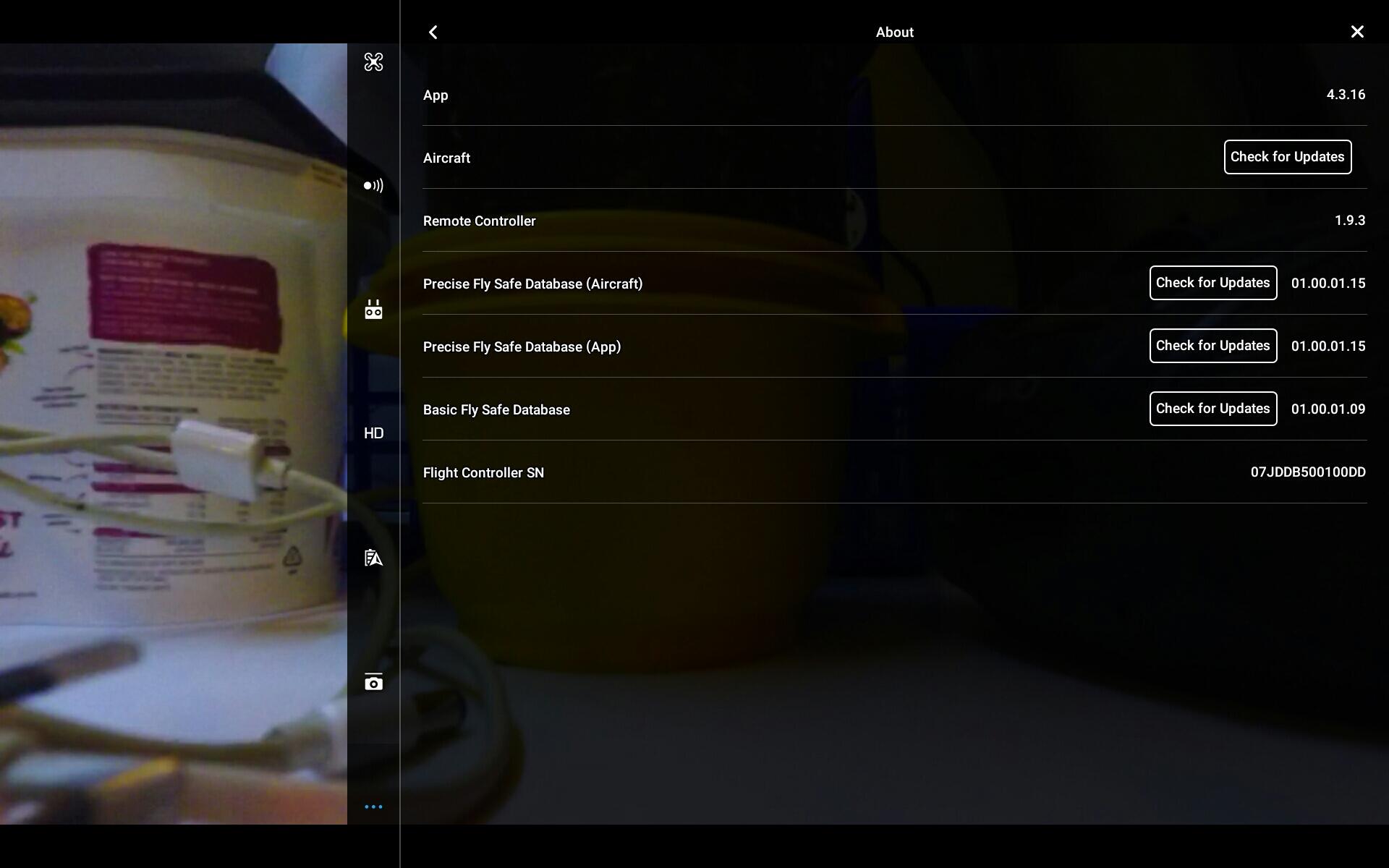

Forget to add a pic,,,bottom picture of my firmware,,,check what you got installed ,,I just say that cause I had no luck on channels,,they were like first post,,,,

RC Firmware = 1.9.3
P4 Firmware = 2.00.0700(AC)
Phone connected to RC = P4 needs a firmware update.
Phone connected to P4 = P4 has the latest version.
WTF
I have updated and re updated several times now. Both using DJI Go 4 and Assisstant 2 (only works for the P4, doesn't know the RC is connected)
The image is all green and pixelated.
When I go into the 'About' screen through the app it tells me the app version, RC firmware version but has Aircraft version at 'Check for Updates' 0000000.

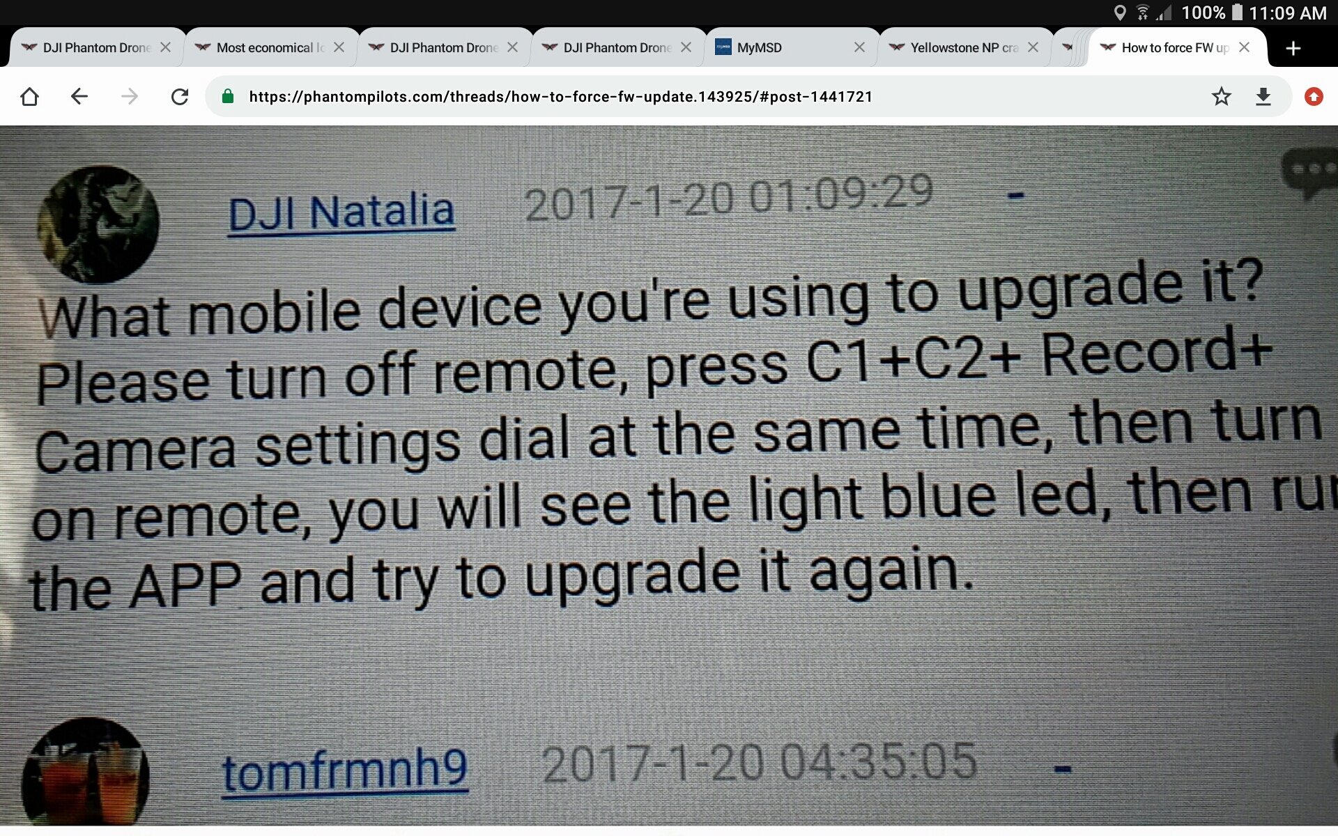

I tried the trick of holding down C1+C2+Record+Camera Setting Wheel but it just seems to boot the RC the normal way it doesn't give me the blue light as suggested in that Post.
I don't know what I am missing, I have linked the RC to Drone many, many times now, but its just not working.
Says you got latest so strange goings on here,,when you try the remote button sequence to reload,,did you hold c1 c2 etc did you then power up remote,don't hold down buttons if remote already on,it has to be pressed and held while remote off and then powered on to get this light,,is that how you do,,,
Yeah, with remote off, hold all the buttons, then power up the RC I the normal fashion. The release all the buttons. Just starts up with the green light.

Only way I know of is in #6 post abovemail I posted,,that's what that sequence is for but unsure why it not bring up blue light for you like it says,,dji info so no wonder it don't work,,ok I go have a dig,,I'm sure there's a remote rest I just have to find again,.....?..another tip I just red is leave drone off when doing this ,,if not already
