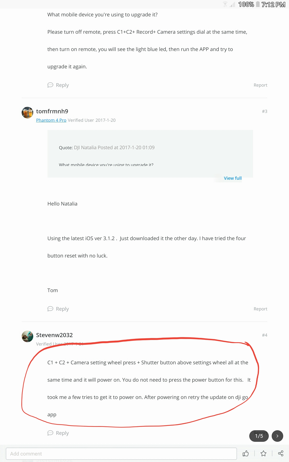

OK find something here,,another post from same fault,,but don't use power button in process as bottom post read

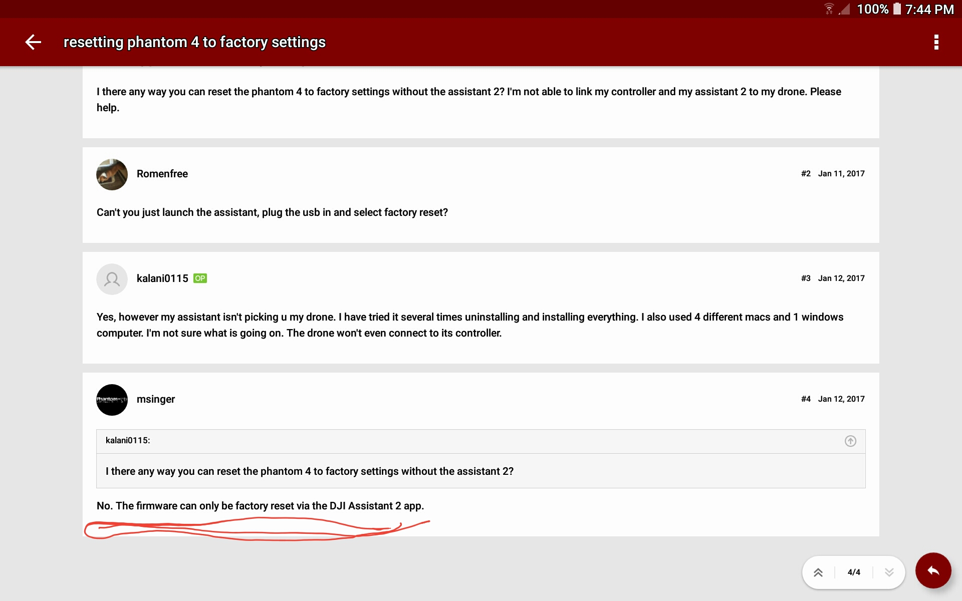

Yeah I tried that as well, leaving the drone off. still no luck. I was wondering of there was like a 'hard reset' for the P4 and the RC that takes it right back to the way it was fresh out of the factory so that I can start with a clean slate.
Ha I must have know to screenshot that before when searching,,it's say p4p but be the same,,can only do that with assistant but unsure how far it will roll back,,,man your drone is haunted,,tricky things

OK. Key point on that post there is 'SHUTTER' button not 'RECORD' I will try again with that sequence.
Thanks
OK tried again with shutter button and no power button. No Luck.

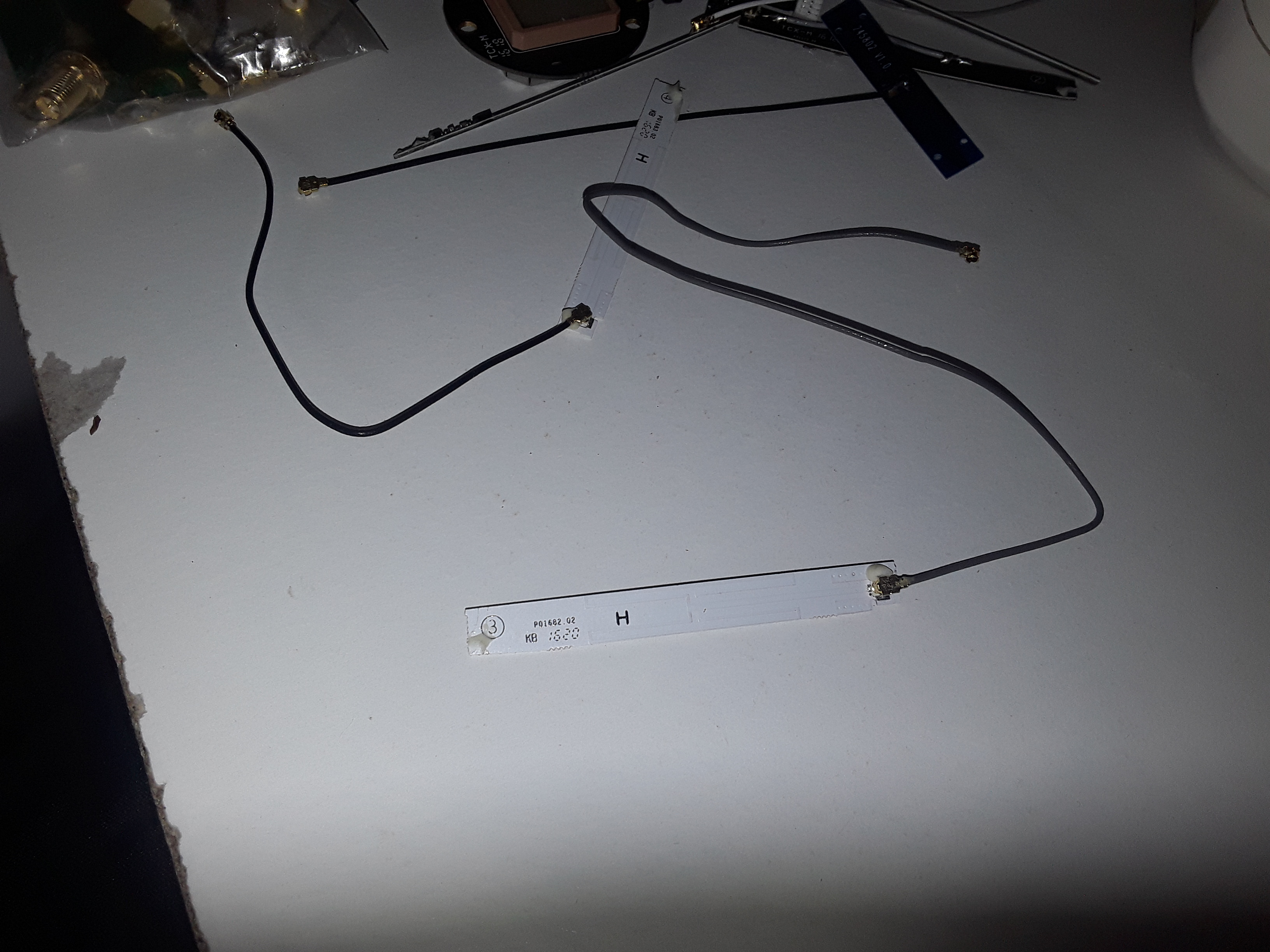

Ay you got picture,well I don't think ribbon cable then if that picture that good,they must be ok,,it's possible it might not be clipped into board fully and is moving,,normally a hot glue holds it to the board,it could be faulty if you hold like that and move anttena around,I know there not much solder holding anttenna wire to module inside anttenna ,just looking at me antenna parts
I have lost track which antenna goes up the stick but might be this type see it clips in it might have come free..yes remote easy to open just be carefully with ribbon cables going to usb port....,,the plastic anttenna covers do clip off with genital force so can check without opening rc up but won't hurt to that way can check other end aswell
OK thanks. I will pull the back off the RC and check for wear or damage. I will also have a look inside the gimbal for the same. Is there a diagram that shows where antenna on the Drone connect and which one does what? Might as well check that everything is connected where it is meant to be.
