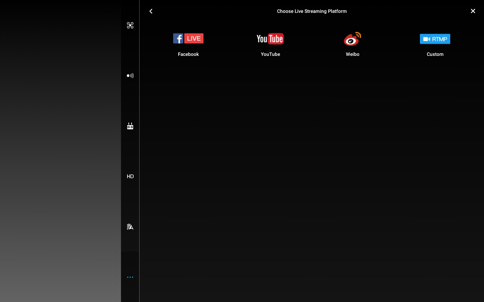

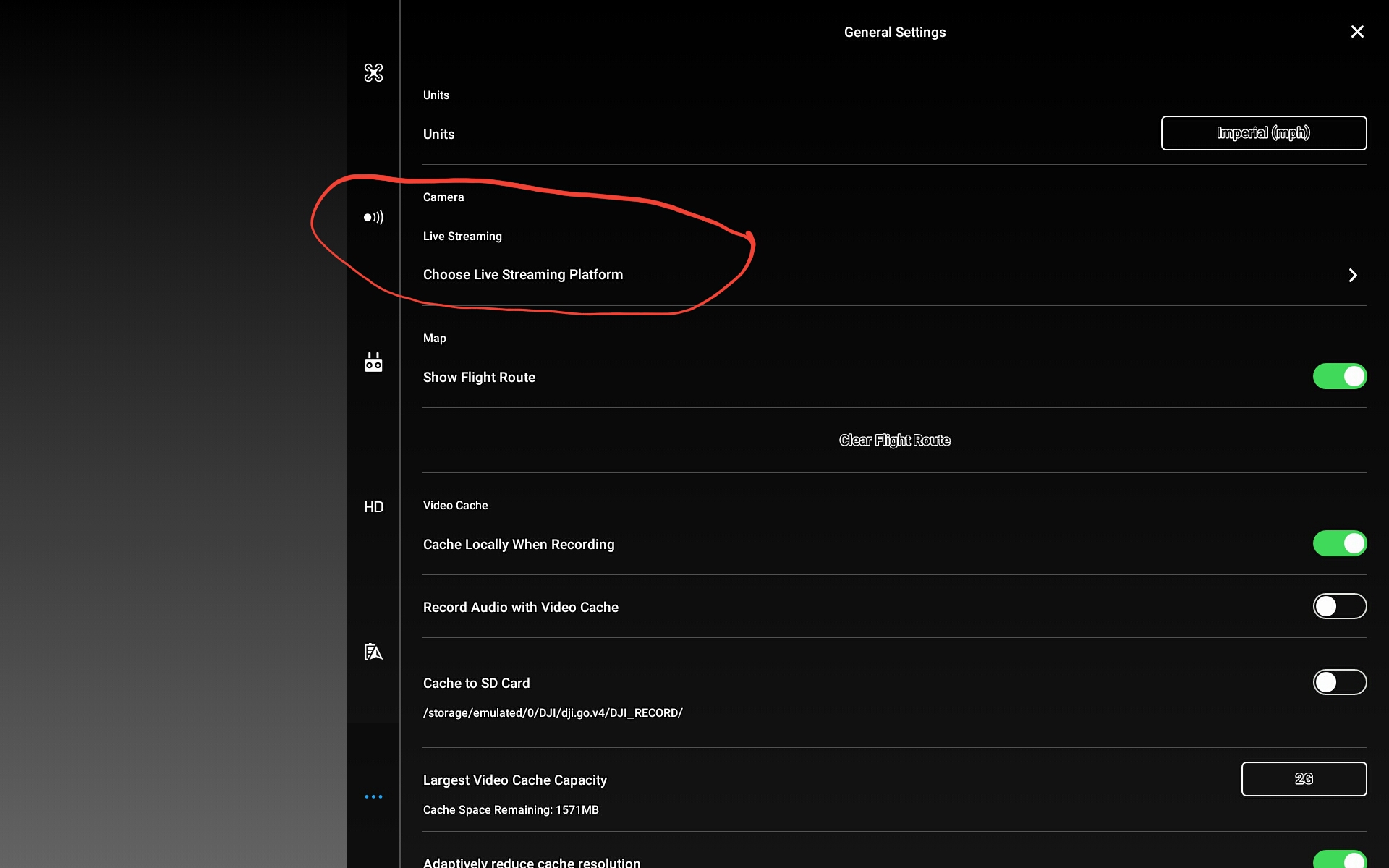

Hey check here
No I never use fb either so unsure how it works but click on and it must have some settings there mayby ???
It seems to just want me to log into FB through the DJI app. I will maybe set up a dummy account for testing. Still seems odd that streaming to social media provides a clear stream but direct to the app its not working. I have tried with Litchi as well and get the same results.
