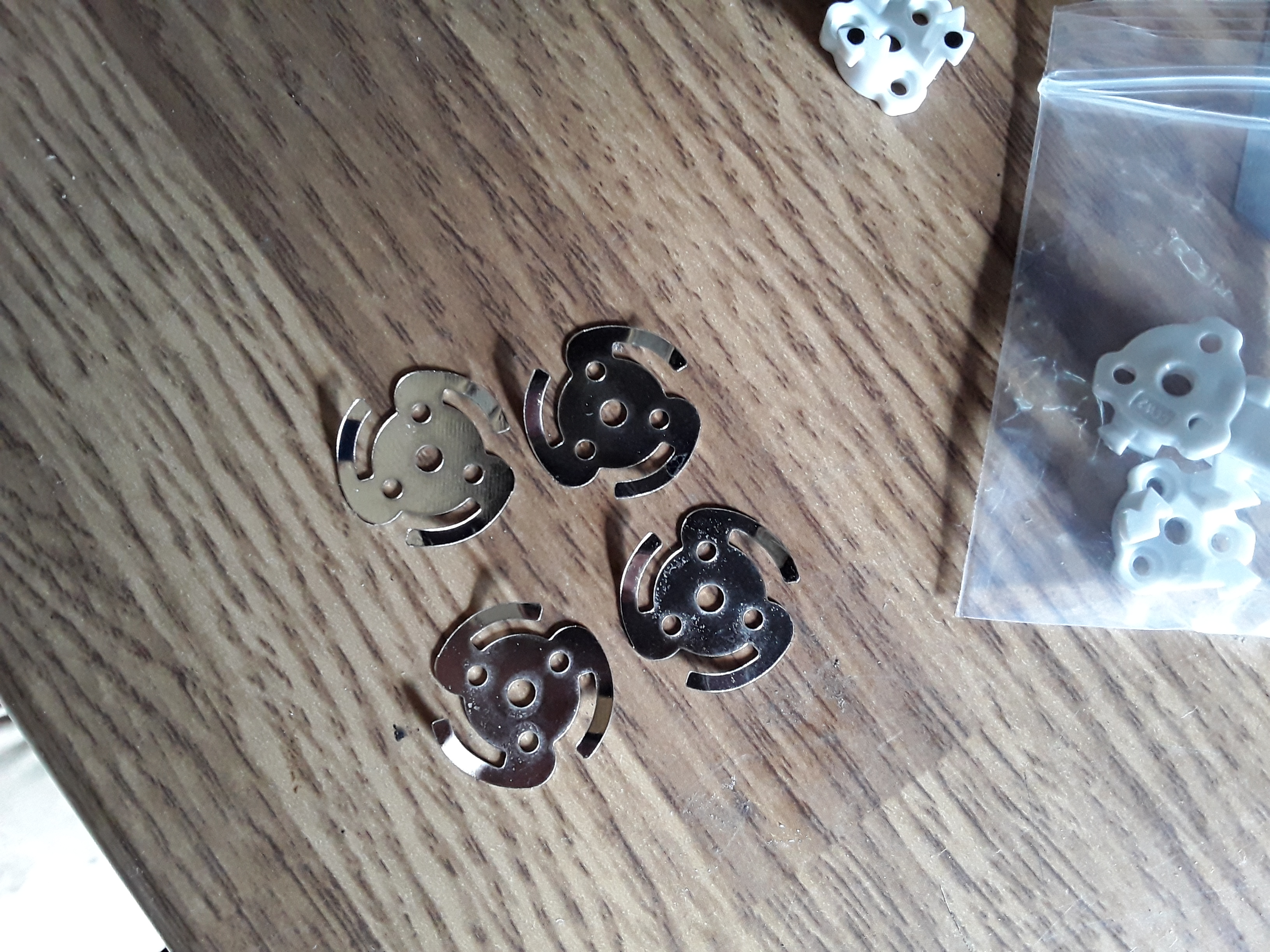

Yeh I still on the originals springs,still doing OK for me,I do find though every now and then they need a bend back up to keep bit of tension on prop,@Bpace,,check white clips to make sure 3 tabs still there or bends spring clip up before prop goes on so you can feel pressure, 1514582142908-2101691167.jpgthese dime a dozen cheap,but yes not normal to lose 1 on each flight,something not right,also check when prop on that it locked ,it might have pressed down but didn't come up into lock position ,like I say I bend mine up hard

Yeh I still on the originals springs,still doing OK for me,I do find though every now and then they need a bend back up to keep bit of tension on prop,@Bpace,,check white clips to make sure 3 tabs still there or bends spring clip up before prop goes on so you can feel pressure, View attachment 92744these dime a dozen cheap,but yes not normal to lose 1 on each flight,something not right,also check when prop on that it locked ,it might have pressed down but didn't come up into lock position ,like I say I bend mine up hard
I too bend mine back up every now and then. Mainly when I feel a little slop in the prop! I've also bought extras and replace them from time to time. Haven't had to change them all on one or two! Good Luck!
Your original flat type spring must have been really unsprung for the props to come off. Like ianzone said, they need to be bent back up (about to 4mm). Get the new type coil spring for the P4P (they fit on P4) and the re-bending is no longer needed. I put the new type on my P4 several months ago and they are well worth it and about 4 bucks a pair from dji.
